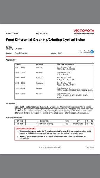

    I did the ECGS repair on my '08 about 50k miles ago. It took care of the whining and groaning. But in the last month I've developed an intermittent vibration in the steering at around 60 mph. I see a couple guys mentioning a TSB above, but I can't seem to find the OP discussing it. Does anyone have the TSB number from Toyota? Wondering if my new issue is related. Thanks.

    I think my TSB needle bearing just went after less than 5k miles. Think it might be time for the bushing.

    Toke my mud terrains off in prep for my ray 10's. Now that i have my stock wheels on i can hear my front diff vibrations and feel them in the floor board. Only does it when cold. Guess I'll be ordering ECGS bushing....Ihave no idea how long it was making noise because my Firestone m/t's were so loud. Hope my CV shaft isn't worn.

    Just upgraded from a Prerunner to a 4x4. Crawler under the new truck and the drivers side cv has tons of slop in it. ECGS bushing has been ordered. Hoping to pick up the tools from someone on TW.

    Just took my truck to the dealership today they are ordering the new replacement bearing. Told them about the T-SB-0026-15 bulletin. They are fixing it under warranty. My truck has a 3 inch lift. If your truck falls under the 5 year 60000 mile warranty it's free. I'll post back if it solves the issue.
