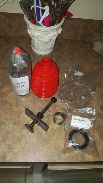

    Thank you to everyone that helped pinpoint this problem and ECGS for making the bushing and tool. My truck runs better than when it came off the lot and it's a 2012. I had the TSB needle bearing done. For me it was a waste of time. The original needle bearing had a ridiculous amount of slop at the cvaxle. The TSB one was better, but still had allot of play. It didn't fix the vibes. The ECGS bushing has very little play. Almost the same as the passenger side. Vibrations are gone, whining sound I thought was coming from transmission is gone, steering is tight, and I think I'm getting one to two mpg better. I'm still watching my fuel economy, but it looks good. I'm not exactly sure how it effected my fuel economy, or if it's all in my head ahahaha. I had it done at my local import shop. The guys down there are honest and do good work. They charged me $220 including tax for the labor. If anyone lives around the Orange county NY area and is interested, Village Auto Works,1137 State Route 17m, Chester, NY 10918 Phone: 845 783-6764. They have the tool, so all you need is the bushing, Toyota seal and 2 quarts of Lucas 85w140. Thanks again Tacoma world for helping me fix my truck. It was driving me nuts, since day one.
