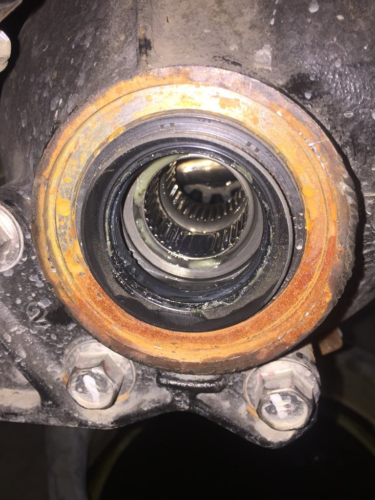

    Any sound advice for doing the install? Sorry I am meeting a friend soon to help me pull the needle bearing out and don't have time to read through the entire thread.

    Pull tire, and all you really need is to pull the two bolts that hold the spindle to the LBJ. then you can swing the whole spindle / hub / cv out of the way plenty.
    For the CV pulling out of the diff, try prying it out, if it doesnt, push it back in, rotate 1/6th of a turn and try again, It comes out very easy but you need to find the spot where the opening of the c clip that holds it in the diff is facing down.

    Sweet thank you for that. Im hoping it will be fairly straight forward

    Its pretty straight forward. Does definitely help to have a puller tool. I made mine, its very similar to the ECGS one.
    I just used a big socket n a hammer to push the bushing back in.

    Put the new bushing in the freezer while you are dissassembling everything. Should help make the installation of the bushing either

    Ok. So is strange. Is there two needle bearings in my front diff?? WthIMG_0097.jpg

    WTF????? did you pull the needle bearing out?

    I did. The inner one was for the splines on the cv shaft
