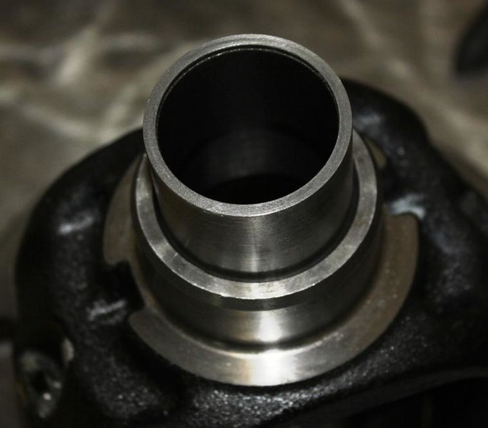

    Correct Orientation for Bushing install Steel Face out so bushing is not damaged when installed.
  9. Mar 30, 2012 at 7:19 AM
    #409
    ECGS
    ECGS Well-Known Member
    Dec 23, 2011
    #69281
    102
    Chase
    RALEIGH
    THIS SIDE GOES IN TOWARDS SPIDER GEAR
  10. Mar 30, 2012 at 7:28 AM
    #410
    ECGS
    Dec 23, 2011
    #69281
    102
    Chase
    RALEIGH
    BUSHING INSTALLED STEEL FACE OUT, FLUSH WITH CARRIER

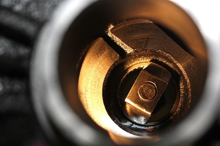

    TOOL INSTALLED VIEW FROM INSIDE. It is critical that the tool is centered as it will pull against carrier and not needle bearing. The space is very tight as one can see in the photo. It is easy to pull against carrier and not needle bearing.
    1. Insert tool with flat non machined side facing out
    2. Thread in Puller bar
    3. Place plate over puller bar and install nut
    4. Insure it is centered and flat by pulling out on puller bar while tightening nut.
    5. If Needle bearing does not come out fairly easy readjust. This is a feel thing, if it does not feel like it is moving the tool will bend if to much force is applied.
