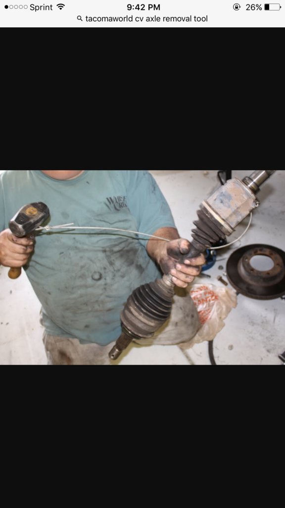

    Good to hear. I used a big metal wedge to slide in between the axle and the diff housing. Stuck it in and gave it a little twist, popped the axle right out. I fought with it the first time until I figured this way out.

    IMG_5054.jpg If anyone is having trouble with the axle NOTHING beats this method. I can't get mine out without this lol
