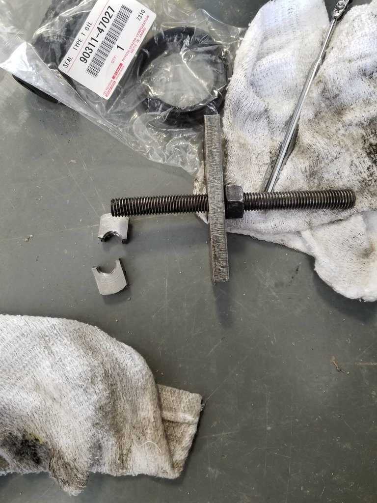

    Just snapped the removal tool. Fml.

    Had my buddy weld it back together and it worked.
