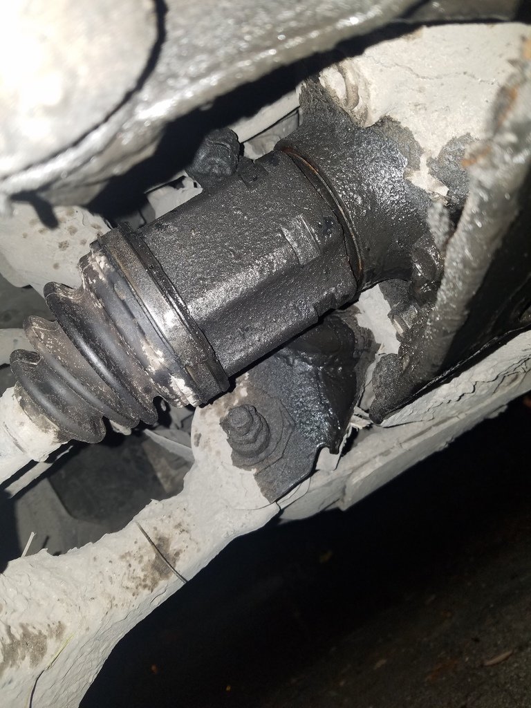

    So I have had a driver side clunk the last few months and have not been able to find it. It sounded and felt like when my shock tower nuts came loose. Well, I found the cause after smelling burning gear oil on my exhaust form a 1.5 hr highway trip this past weekend. It looks/feels pretty bad. I think the bearing is toast with how much play there is in the axle. Ordered the seal, bushing and tools from ECGS. Hopefully the axle shaft is okay and there are no bearing pieces floating around in the diff.
