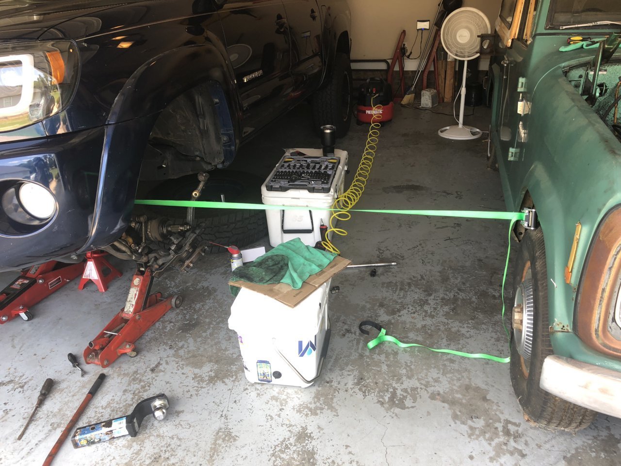

    I got tired of trying to pry out the CV from the diff. Got creative with this. Still didn’t work ha. Ended up getting it with my tire iron
