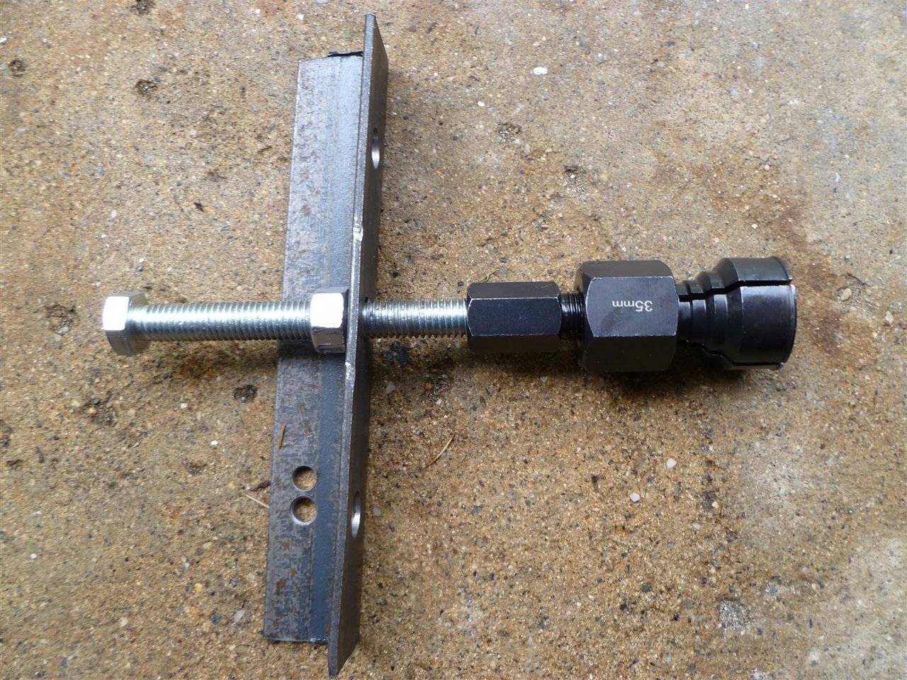

    Anybody have the puller tool that I can use? I can pay shipping

    Anyone have a used set of removal and install tools from ECGS they would sell?

    I have the removal tool. Just finished using it. Didn't quite fit for me so I did file the end piece down that pulls on the needle bearing. But it worked great for me after that. I'll pass it on to you for the same amount I paid. $25
    I dont have the install tool. I used different bearing drivers and sockets to tap it in.

    Thanks. I may hold out for one that is not filed but if someone doesn't have one I may be in touch.

    2011 DCSB
    Just keep throwin' money at it.
    Where did you find the 35mm collet for $15.99? I keep finding full sets for $35-ish but they don't have the 35mm

    Anybody selling their removing and installing tools for the ECGS bushing?
    I am currently 2" lifted going for 3" while I am already there I wanna complete this already. Peace of mind.

    I have both. My install is Monday so tools will be available afterwards.
    Message me to discuss.

    With that, I have a removal tool available if anyone needs one. $40
