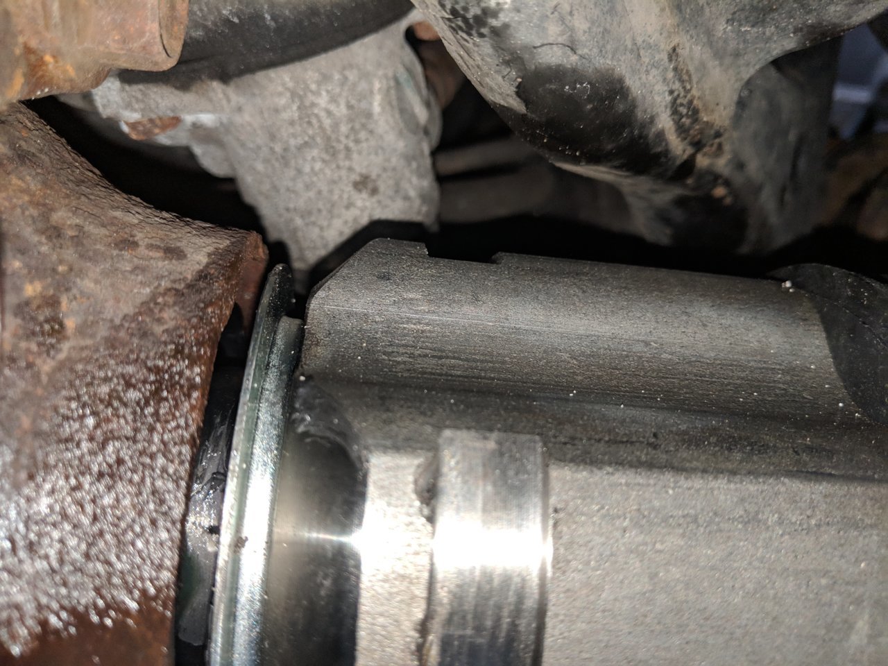

    I did the ECGS bushing yesterday. I still have a droning sound...wtf
    As I was checking it today, I noticed that there's a ring on the CV. On the passenger side, it sits flush with the diff, the drivers side not so much. Did i not drive the bushing in deep enough?
