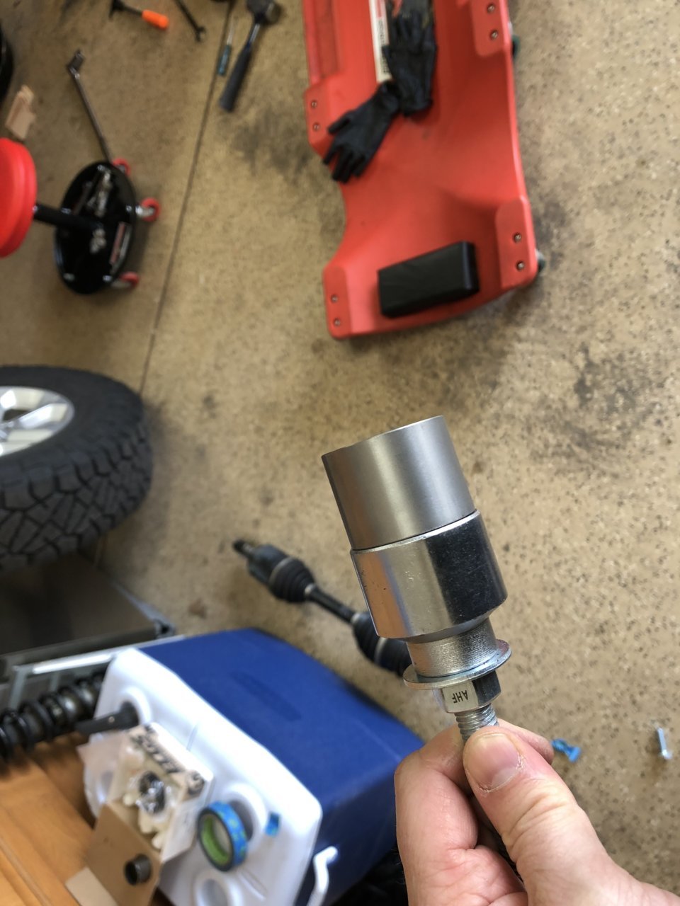

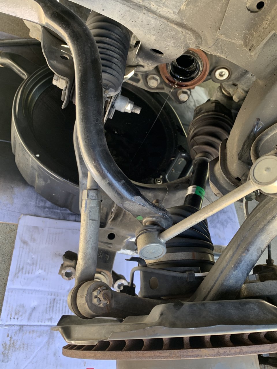

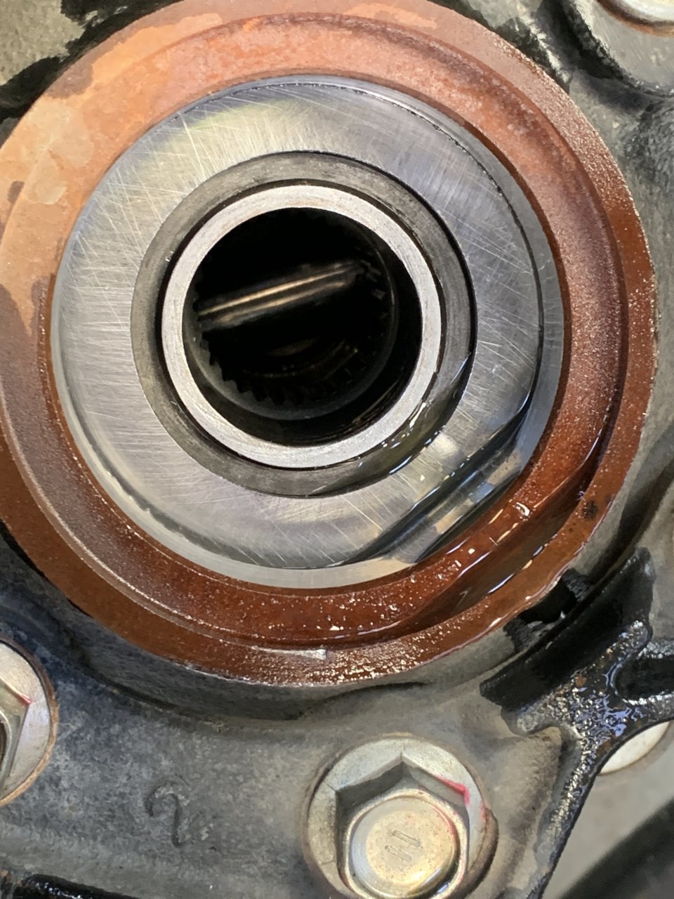

    Needle bearing out, ECGS bushing in. The CV doesn’t need to come out of the hub. Plenty of room to get this done. Also CV wasn’t difficult to pop out as it had a red mark and when lined up at the 6 o’clock position and a little leverage from a pry bar, came right out. Also used the old seal to press the new seal in.

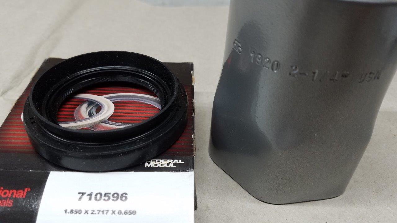

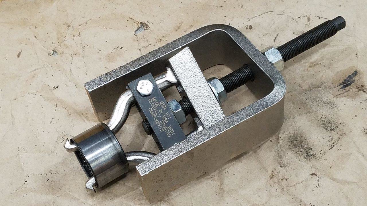

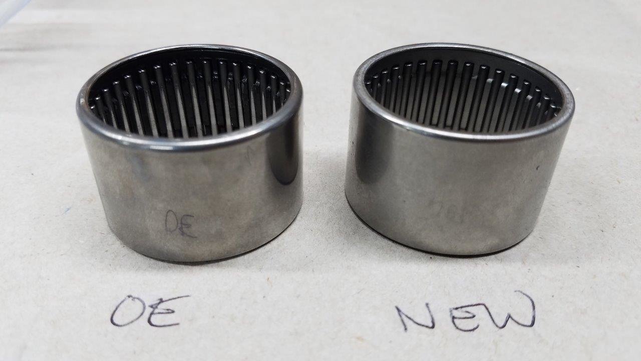

    I replaced the front differential LH output bearing with the "new" Toyota roller bearing last nite. I see no difference between the old and new bearings- same width bearing and same number of rollers (34?). The bearing I removed had visible wear on the rollers and was obviously much looser than the new one when installed on the axle - checking out of curiosity prior to installing the bearing in the case. I'm sure this output bearing will need to be replaced in 100K miles but the wheel bearings will probably also be due again then if I still have it and I'll do it at the same time. I know everyone here loves the EC bushing, but I'm not paying $60 + shipping for a stupid bushing when the Toyota part is $13. Plus, has anyone ran it for 100K miles? It does seem like this is a great application for a bushing, but it also doesn't have the long term record.
    I did not have the axle vibration issue, but at the differential there was a lot more play in the LH axle than the RH and since I was doing wheel bearings, I went ahead and installed a new bearing
    When you pull the old bearing, make sure you're pulling on the bearing and not the step inside the case that's just behind the bearing. I put the puller jaws in a little too deep the first time and it didn't budge so I tried again and it came right out.

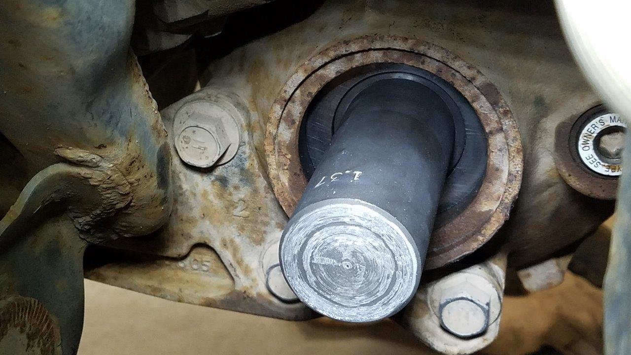

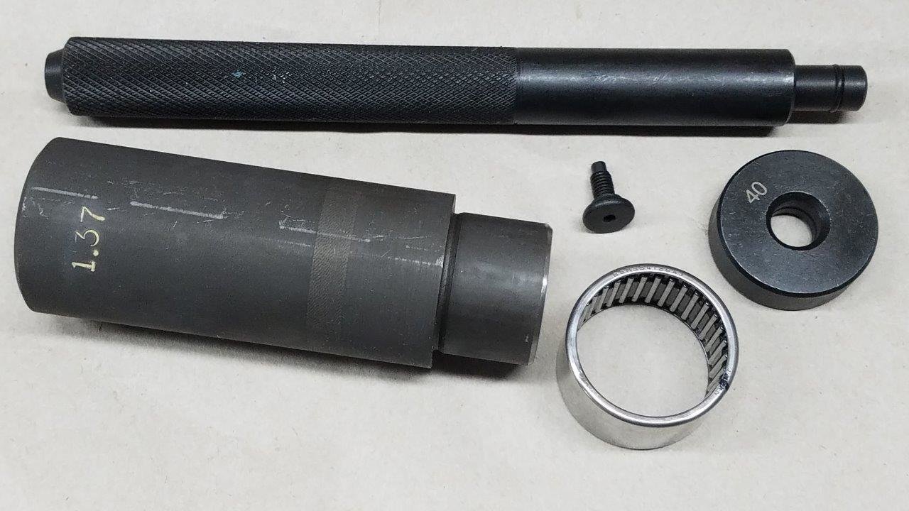

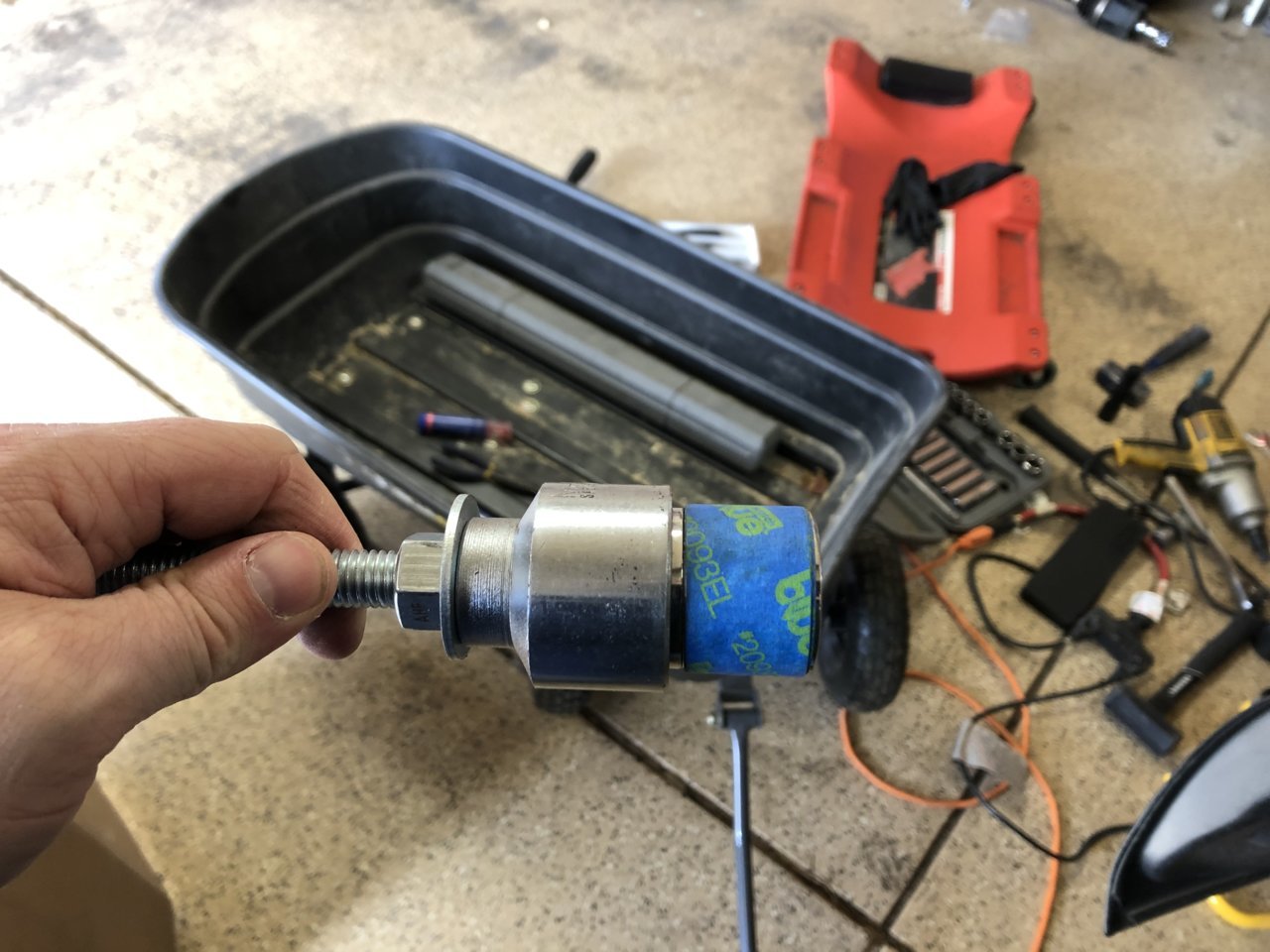

    a few more pics. Note the correct seal PN. I used a 2-1/4 axle nut socket to install
    it. I happened to have the perfect size bushing driver to install the bearing and finished it off with the 40 mm driver shown above. The depth spec is 1.4-1.7 mm below the surface and install the bearing with the writing on the end facing out.

    Similar here, not wanting to pay for the ecgs tool I bought the 35mm collet from Rocky Mountain atv and made my own driver from sockets. Worked flawlessly.

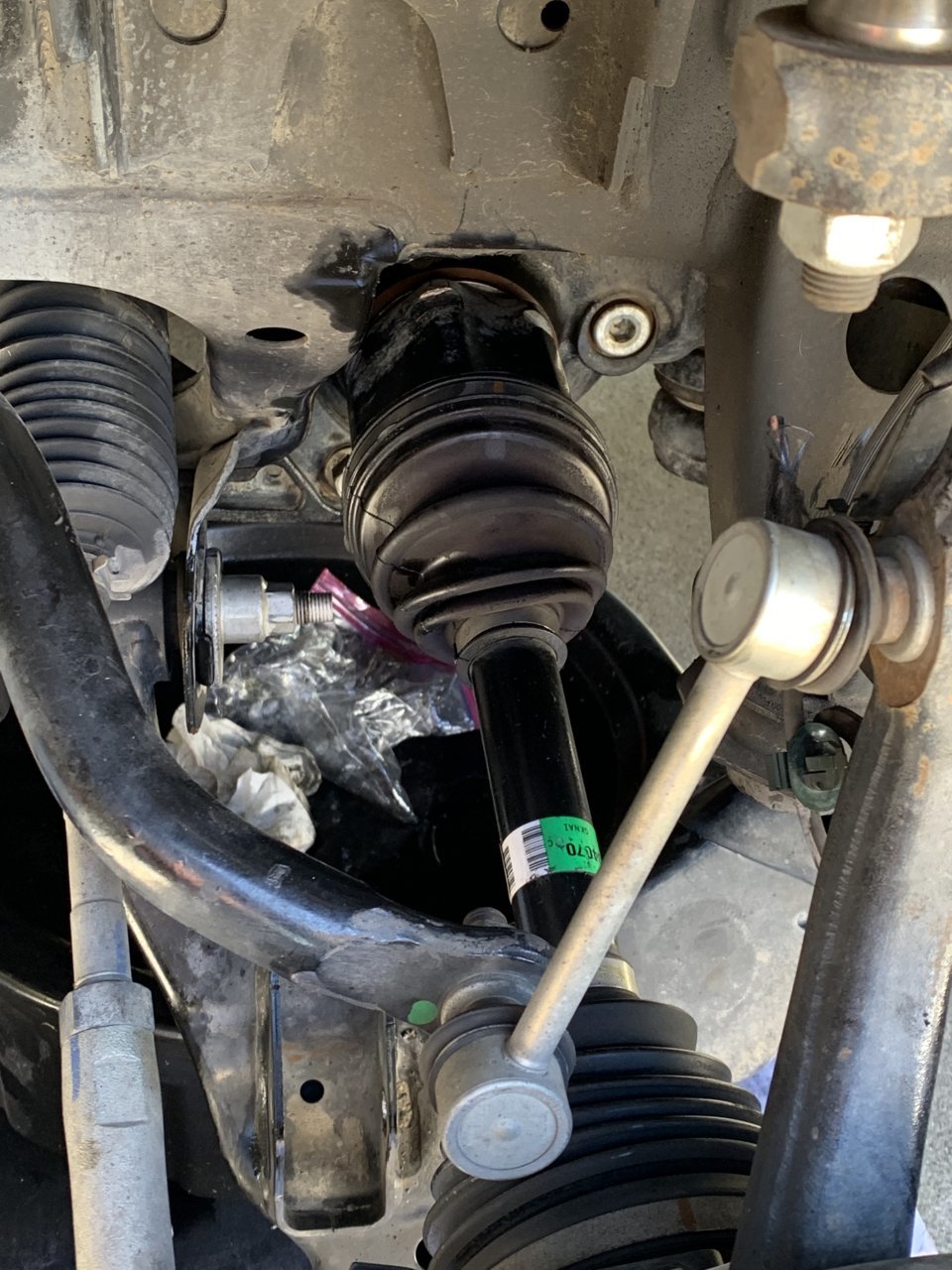

    Question: Is it necessary to remove the axle nut to pull the CV when installing the ECGS bushing on a 2nd gen? I just noticed the torque spec for the axle nut is 173 ft. lbs.! I don't have a torque wrench big enough to re-tighten that monster.
    If not, what is the procedure for removing the CV from the diff?

    Not necessary. Unbolt the LCA from spindle(2 bolts, 19mm). Then pop the CV from axle and use the loose spindle to guide the CV out of the way.

    Ohh ok gotcha. Now hopefully i don't have issues separating the CV from the diff. I've seen some people use a steel cable and a hammer to yank it out. I'm assuming you would need to separate the outer CV from the hub in order to do that method, right??
