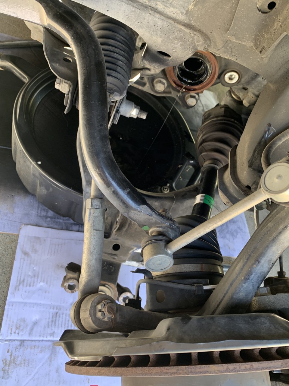

    There's a red mark on the CV that if you point down at the 6 position and pry, it pop's right out.

    Nice! That pic helps for sure. Good to know that I don't have to pull the tie rod end either, just the two LCA bolts from spindle and looks lik everyhting should move out the way. Did you have trouble seperating the axle from the diff?

    I'm lazy so less to do the better. See my post above in regards to getting the CV out.

    It helps to have a pry bar and a big hammer. I didn't have enough leverage with just the pry bar since I didn't lift the truck up high enough so I gently tapped the pry bar end with a hammer and it popped right out.

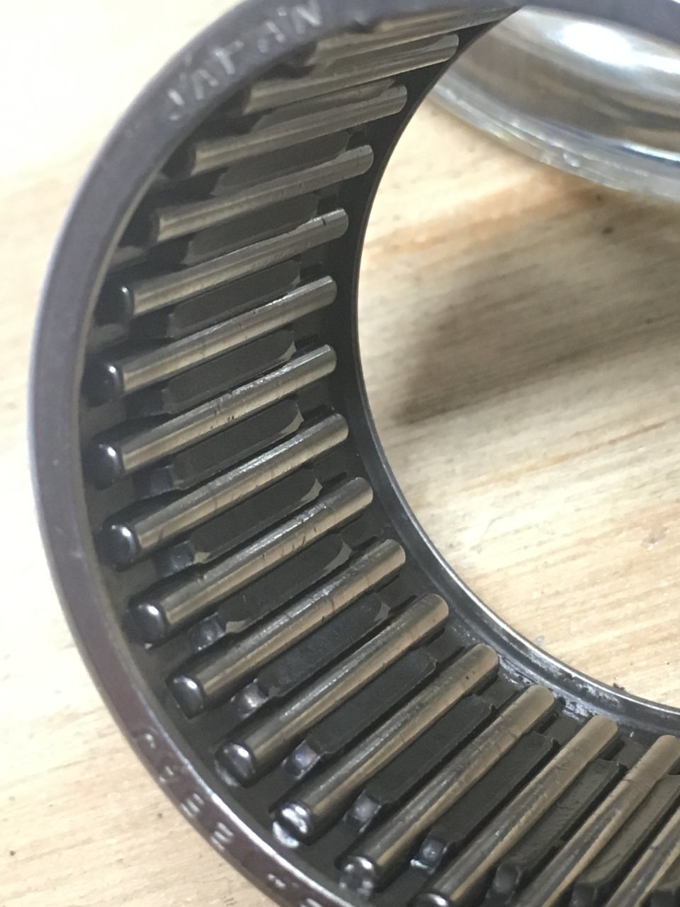

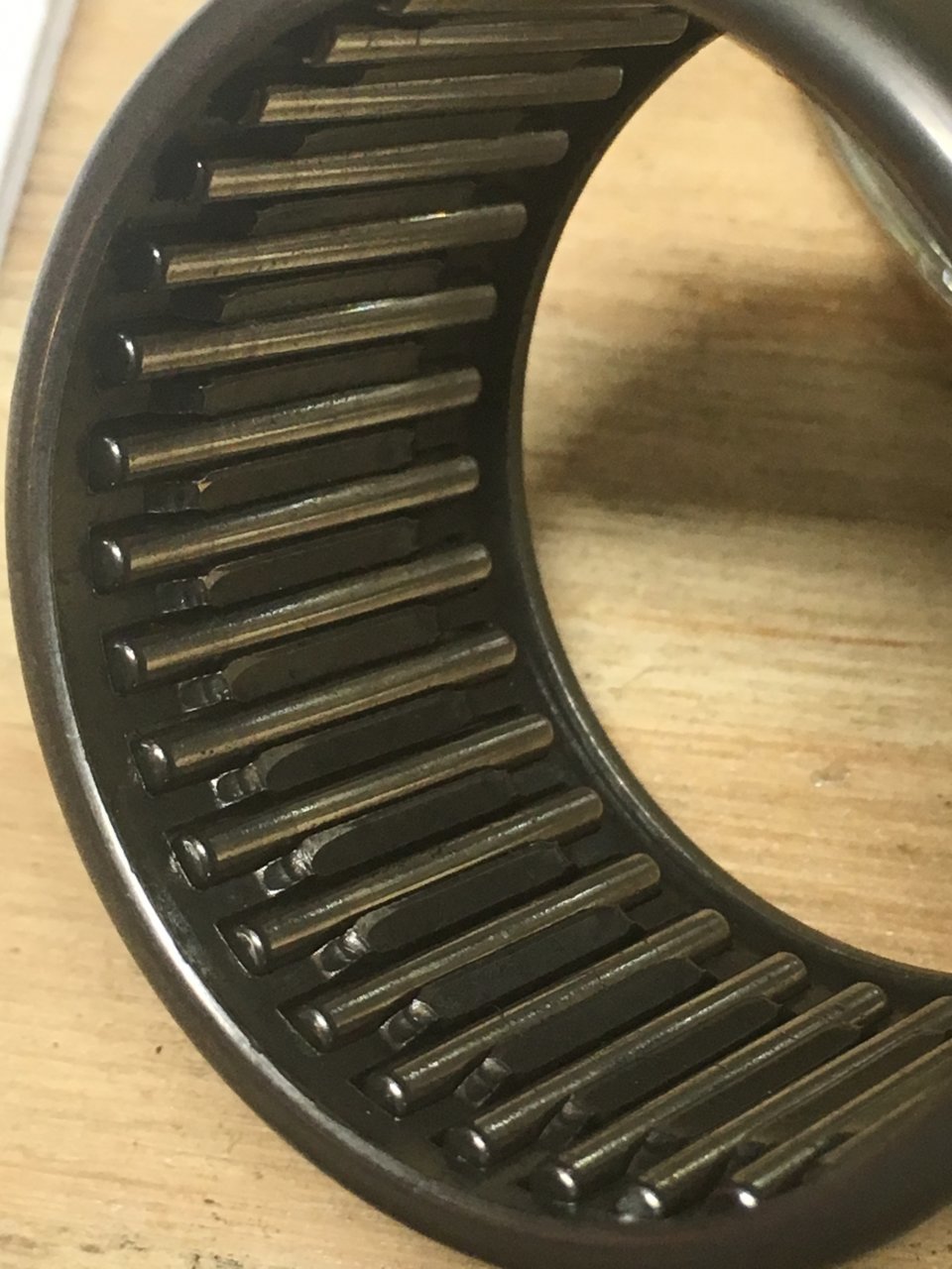

    got mine done today and all vibes gone. pics of the removed factory needle bearing below. im at 58k with 1.75" lift since 5k. noise has been noticeable since about 54k. notice the polished ends between the needles. dealer denied the issue to be covered under tsb-0026-15 stating noise was due to tires. i will be paying them a visit shortly to inform them of the bearing failure and to try to get reimbursed.

    Hopefully they will come thru for you, but with a 1.75" lift, they may try to deny coverage since it's not factory condition; a lift greatly decreases the amount of miles before failure. I don't think anyone can legitimately deny it doesn't. With 1" lift I was still ok at 115k- the bearing was worn, but no vibration. Good luck!
