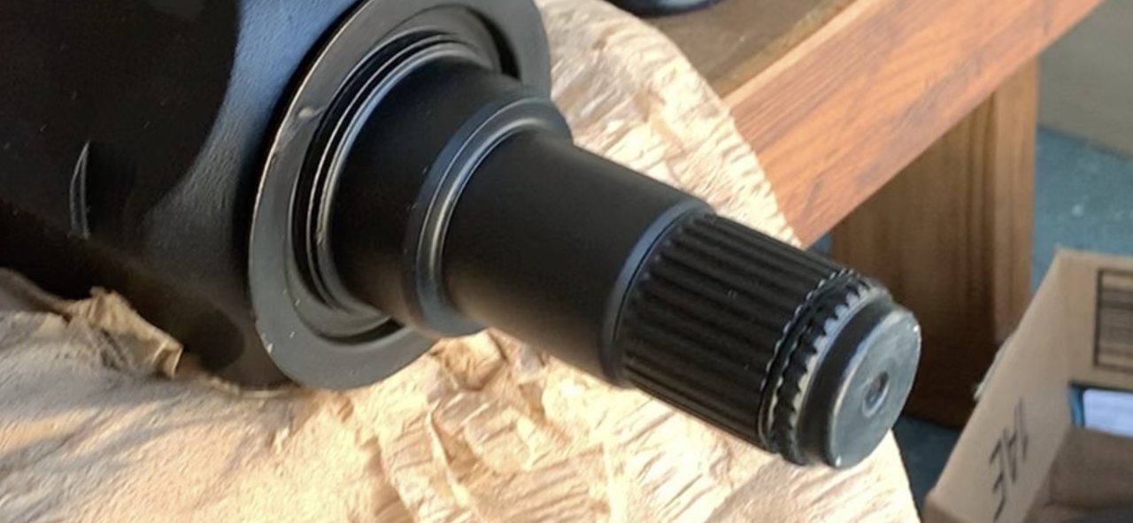

    I am doing the ECGS swap, all going well and just like as documented in may videos. I have a sort of off topic but related question: Does the painted (bearing/ bushing) surface of this new remanufactured axel (from CVJ Axel -Denver CO) give any concern? Obviously the old CV's wear surface is shinny smooth bear metal from 237k miles of use.... OR am I overthinking this?

    Cant say I've ever seen that. But I've only replaced one CV :D

    0 issues.... running strong.... I did call CVJ but their tech guys said NO worries... they have been sending them that way for a long time....
