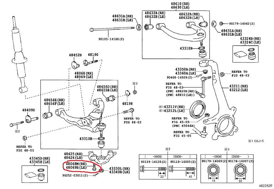

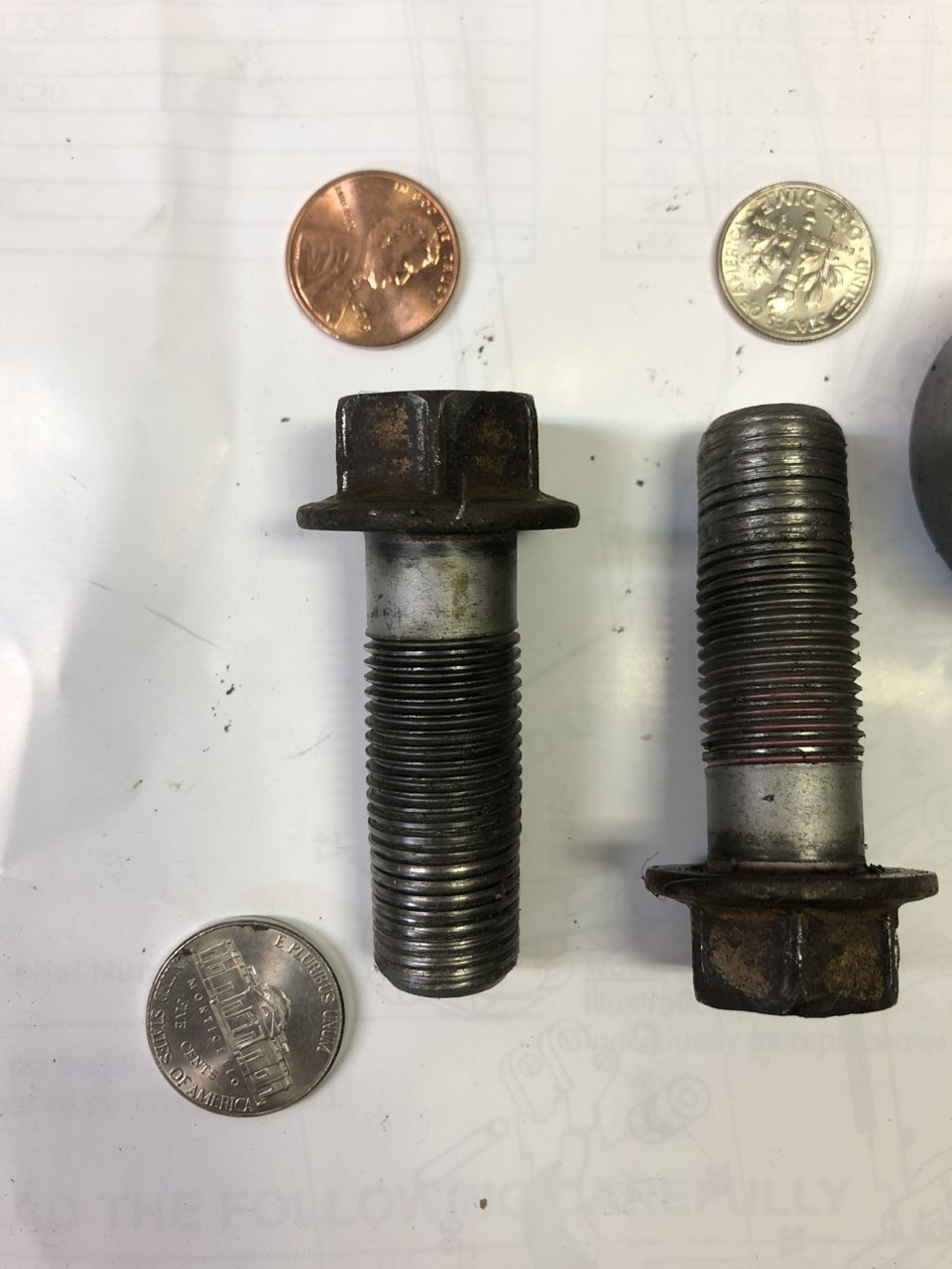

    The bushing portion went well but I had an issues with the 90105-A0010 bolt. They attach the steering knuckle to the lower ball joint attachment. Circled in red below.
    If you see the two bolts, the tops of the threads are completely gone. I had to buy two new bolts from Toyota to replace those as one of them would not catch the threads on reinstall.

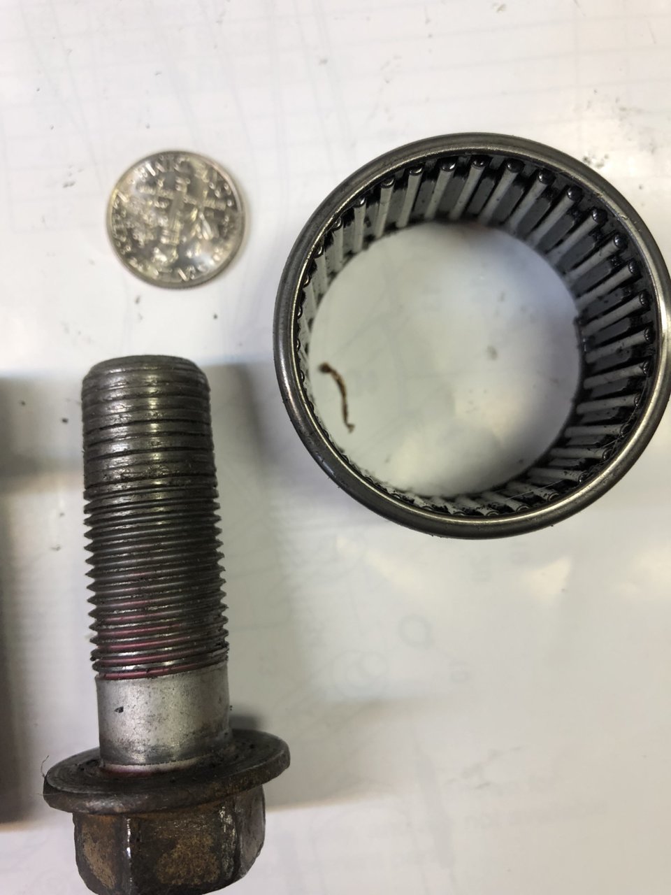

    I still had trouble getting one of the new ones in, so I removed the new one I installed first and the threads were gone from it too. Not sure if it was a manufacturing defect in knuckle or a cross thread in the past? No way this is normal..
    Bonus needle bearing

    They were probably cross threaded.
    You have to be really careful when installing them. I sometimes use a jack and help hold the LCA up into place so the bolt goes in “easier”. Geometry works against you.
    A little tip a tech gave me was to lube the threads first. @Bishop84 :thumbsup:

    Yep I lifted the LCA with a smaller jack to get the parts to meet seamlessly but it appears the damage was done by a previous owner or perhaps Toyota during the frame replacement. :facepalm:
