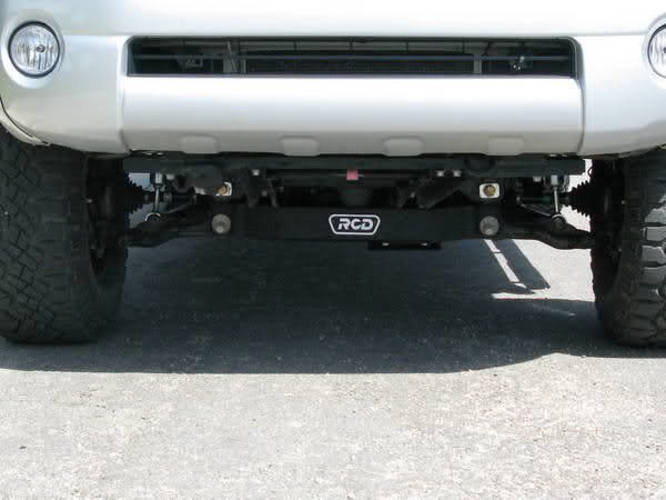

    @05Moose, you think an RCD kit would solve my issue? Without having the bearing replaced? Dealer refuses to do say anything is wrong. I can't help but think that with angles like this (below) that vibe would have to go away... My control arms alone are 2/3rd's the price of the RCD so I'm really thinking about having a little sale and switching it up...
