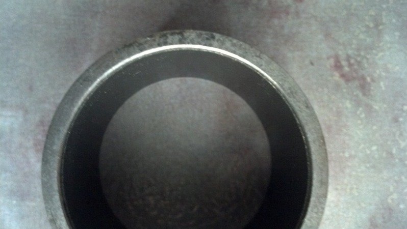

    Just a quick question. Which side of the bushing should be facing out towards the driver's side wheel. I can't tell on ECGS video. I assumed the top image was the side facing out and the bottom image is the side that is inserted into the diff.
    Thanks

    You got it !
