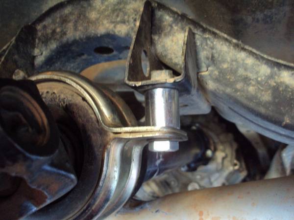

    You're lifted...ever do anything about your carrier bearing?

    It only has 55,000 miles on it...50-55mph seem to be the worst, I can feel it 45-60mph...sorry, I don't know what a carrier bearing is....I just want to figure out what's wrong with it so I can sell it, I'm sorry if I find all the problems unacceptable for a truck with such relatively low mileage, I've already poured so much money into it and dont have really anymore to waste on it...:goingcrazy:

    If you lifted it, all bets are off, and the problems are likely of your own creation. Don't blame the truck unless the issue was there pre-lift.
    Your carrier bearing is the bearing in the center of the two-piece driveshaft. Vibrations on these trucks are common when lifted as it puts the u-joint behind the carrier bearing at a steep angle, making the shaft rotate out of balance.
    Try shimming it down 1/4" to 1" with hardware...it's cheap and easy...mine's dropped an inch to keep vibes away at 3.5" of lift...otherwise it has a nasty takeoff shudder.
    Nice thing about this is it's reversable and easy to test. Give it a shot, it doesn't help then we move on to the next suspect.

    If it was the carrier bearing, the steering wheel wouldn't shake violently. The problem is up front if the wheel is shaking.
    I don't see any threads from your bolt poking throught he other side of that welded on nut. That is a lil dangerous. You should find yourseld some longer bolts to put in and douse them in loctite.
