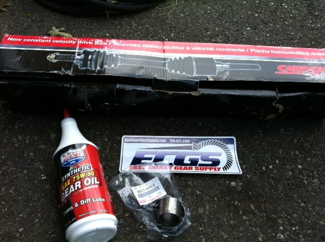

    your tool and the ECGS bushing came in the mail yesterday, thanks a ton for letting me borrow it :cool:
    well, here goes nothing

    what cv shafts are you guys putting in as replacement? advance auto has one for $80!? rock auto has them for half that, haven't tried napa yet

    I went with one at Autozone. I found a lot online at various auto parts stores for around that price, but when it came down to it none of them were available even in their warehouses. It was as if they listed a generic one for each model but didn't actually carry it.

    ecgs bushing definitely took the slop out of the cv shaft but...
    it's still growling away

    yep new cv shaft. what will taking the driveshaft out accomplish?
