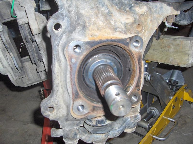

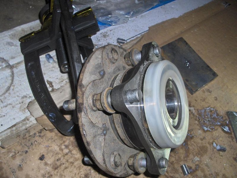

    Bearing presses onto hub (6 bolt splined inside piece wheel attaches to) then bearing "fits" inside spindle when all is said and back together.
    Bearing + hub
    Spindle where both attach
    Just to stop confusion.

    I'm not confused at all about what is what. The way some guys were talking, it was like they were saying there hub was the problem. I didn't think it would ever be the problem inless you didn't press the bearing onto the hub correctly. Almost impossible though.
    I was just trying to clear up what they were talking about. I just got done doing this job on my truck along with the ecgs bushing, new rotors etc.

    It's all good... Thanks for posting pics for us and clearing it up too
