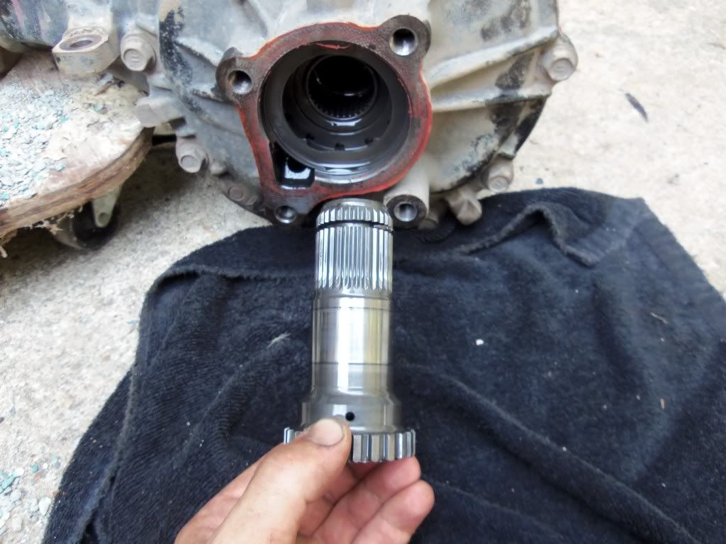

    Yes, but.......
    On the left the CV shaft goes directly into the needle bearing.
    On the right the CV shaft goes directly into a ball bearing, not a needle bearing, located at the end of the ADD tube. In order to get to the needle bearing on the right, the whole ADD tube is removed (it is held to the diff by four Etorx (E14) bolts). Once off there is a stub shaft the rides directly in the needle bearing. The procedure is then the same as for the left. The ECGS bushing can be installed the same way on the right.
    I can tell you that the job is not a lot of fun. And, I probably would not encourage someone to go in there routinely. The right side does not take the same type of side load that the left does. I point out my experience because, as I have said before in this thread, I now believe that many or most of the 2nd gen. Tacoma front differentials are bad.
    Having said that, if you have notions of digging into the right side I would suggest that you first call Chase at ECGS and ask him if he sees a high percentage of needle bearing scoring on the right side stub shaft. He is aware of my case but I might be one of the rare ones.

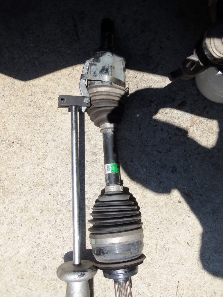

    So I read through a bunch of this thread and didnt see it, but when you guys replaced this, were you able to get the cv out of the diff by just unbolting the spindle from the upper and lower control arms? I remember when I put my lift on the CV wanted to come out of the diff, but I didnt let it come out so I dont know forsure if it would. I am probably going to be doing ucas and this bushing at the same time, so the less work I have to do the happier I will be. Hopefully this makes sense.
    Thanks.
    Also looking for the puller tool, and install tool if anyone has them.

    So I have to pull the entire CV out of the spindle to get it out?
    I see the pics now, I get it.

    PSU Taco85, the bottom picture is the right side stub shaft I have referenced many times in this thread. It rides in an identical needle bearing as the left side (you can see the needle bearing back in the dark recess of your pic if you look close enough). I pulled the right side and replaced the needle bearing with the ECGS bushing, and also replaced that stub shaft. This stub shaft is outrageously over priced.
    Is this your pic or one you found? If its yours, use some magnification and look at the bearing running surface on that stub shaft. Mine was all gouged up by scoring created by the needles and the damage was clearly visible with the naked eye.
    By the way, NO! the right side stub shaft shown does not take the same clip as the left side CV shaft -- it takes a different "Snap Clip". Beats me as to why. They pretty much look the same.
