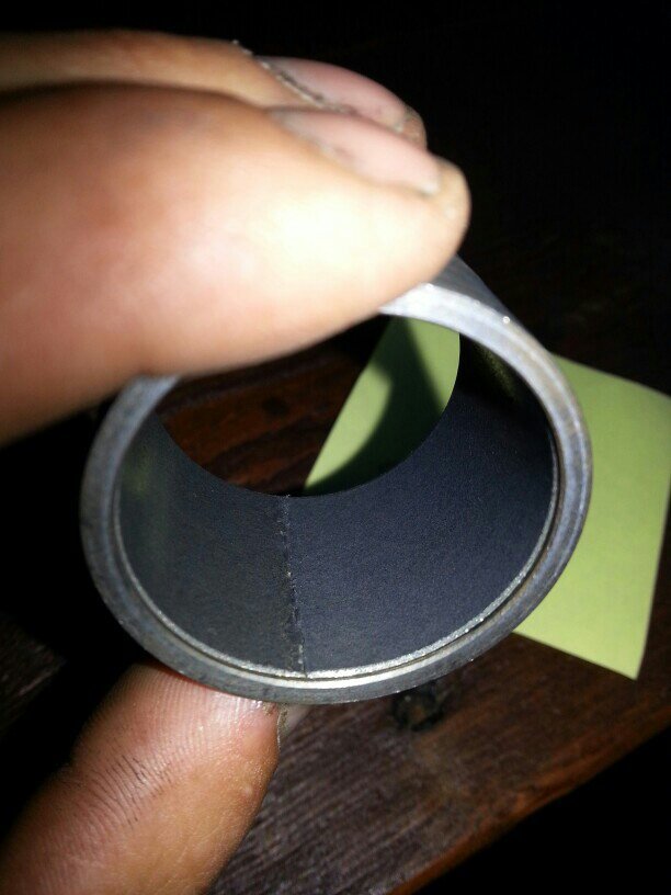

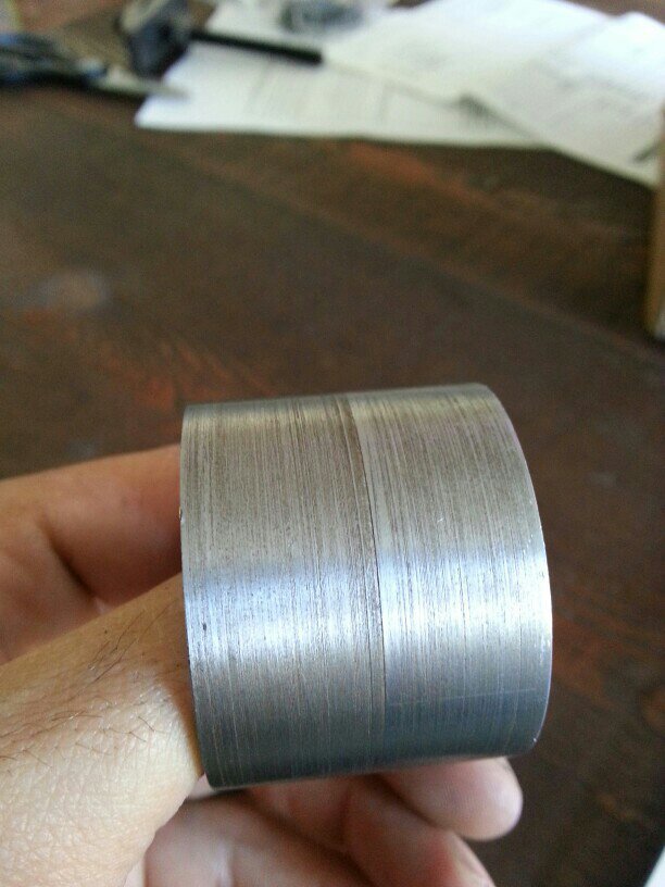

  6. Jul 10, 2013 at 6:14 PM
    #1166
    tweeek
    tweeek Well-Known Member
    Mar 11, 2012
    #74706
    185
    Victoria, BC
    2006 Tacoma Access Cab TRD OR
    I just received my bushing in the mail. Have a look at the pictures, did everyones bushing have a seam on the inside tbat is rough to the toucch? I expected it to be dead smooth. Same on the outside. If I run my finger over the outside, there is a noticable ridge in the center.
    Second, which side of the bushing goes into the diff? The solid side or the side with the two layers?
    2e2utyme_cb2f2070dd02a7367c72c6f4dd178f67f54bc107.jpgazataby6_71c314172f5b4b67ea57d5250a3525227aa8e658.jpg
  7. Jul 10, 2013 at 6:22 PM
    #1167
    brutalguyracing
    brutalguyracing BIG DADDY
    Jun 28, 2009
    #19000
    24,052
    F.U> GUYZ
    broken mods
    the 2 layer side goes into the diff
    and yours looks better then mine did......
  8. Jul 10, 2013 at 6:33 PM
    #1168
    tweeek
    Mar 11, 2012
    #74706
    185
    Victoria, BC
    What about the inside?

  10. Jul 11, 2013 at 5:13 AM
    #1170
    ECGS
    ECGS Well-Known Member
    Dec 23, 2011
    #69281
    102
    Chase
    RALEIGH
    The solid side faces out. The inside bushing is not a continuous piece it is split and when pressed in closes the gap. The ridge is the teflon coating overlay. Just install as is and the ridge will flatten out.
    The install instructions are listed on our site in the bushing product page for reference and posted here.
    http://eastcoastgearsupply.com/attachment/37734-T8CS BUSH INSTALL.pdf
