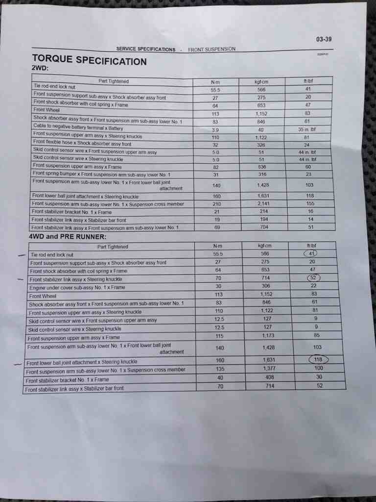

    I've got the droning vibration. 8,000 miles on the truck and 7,200 miles on my lift. I've got the bushing and puller, new lube. Just need a 35mm socket and a dry day off to take care of this.

    ^^ how many miles you got? Its possible to have a wheel bearing in addition to the side bearing, its been known to happen. Might want to inspect them while you are going to this amount of work anyway.

    ^^ Lucky you. BTW, thanks for posting the torques. The other one that many will be asking about is the axle nut itself. It is 173 ft. lbs. Don't go over or under this value as it will shorten the life of the wheel bearing. This value is for clean, dry threads not ones that have been lubed or had anti-sieze applied. And whatever you do, don't just guess-a-torque. You will be sorry.
    Good luck on your fix.
