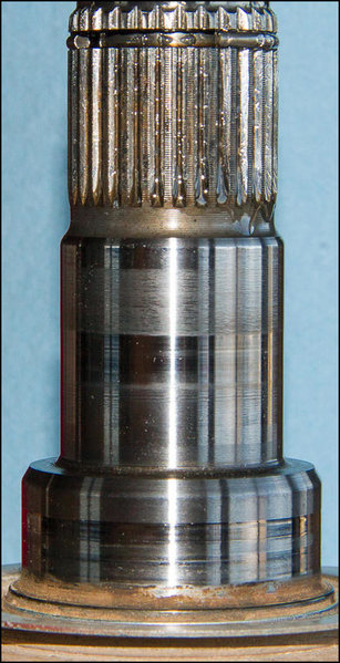

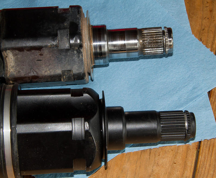

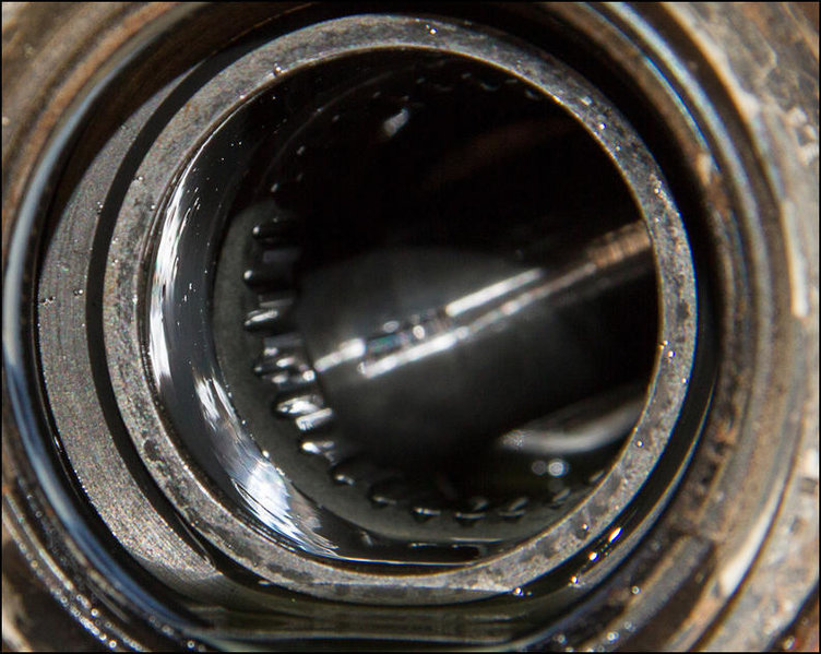

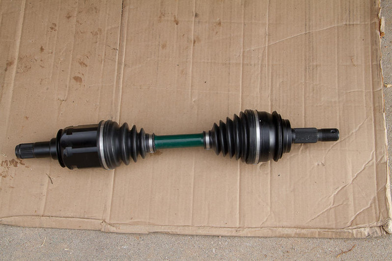

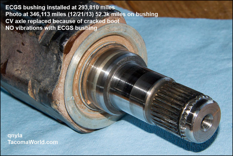

    Photos of a CV axle after use with the ECGS bushing.
    Background: I installed the ECGS bushing due to the onset of front end vibrations when my 2006 had 293,810 miles, which was about 75k miles after installing lift. Photos taken today at 346,113 miles which is 52.3 miles after install (oops, I recently reported I had 54k miles on bushing, but it was actually 52k miles due to bad memory).
    CV axle was replaced due to a cracked boot, and since reman OEM axles are only $99 at CVJ Axles, I elected to replace the axle rather than just the boot due to high mileage on axle.
    Photos: It looks good to me, no signs of unusual wear, just light marks as you might expect. Keep in mind this axle had 293,810 miles of needle bearing wear as well, with the last 1500 miles or so of it on a bad needle bearing before the bushing install.
    The bushing look fine as well.

  20. Dec 21, 2013 at 12:54 PM
    #1400
    qnyla
    qnyla Well-Known Member
    Feb 2, 2010
    #30604
    1,307
    NM
    2006 & 2016 DCSB TRD Off Road 6-Speed
    I am not thrilled that the reman CV axles from CVJ have a black coating or paint on the machined surfaces. I hope that paint is compatible with the ECGS bushing. I put it in anyway.
