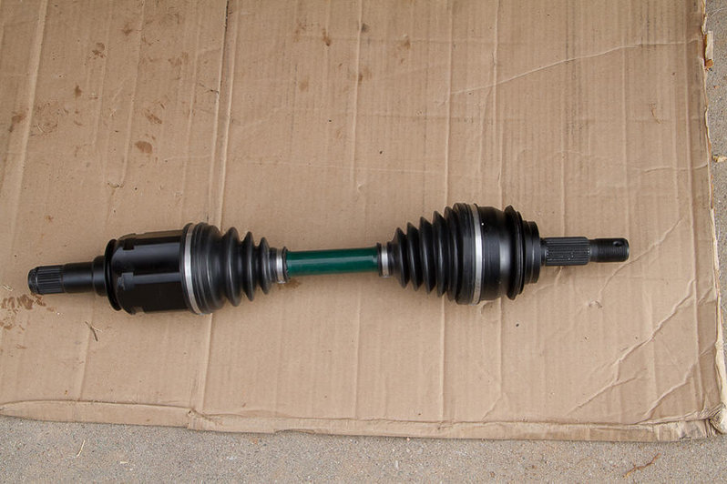

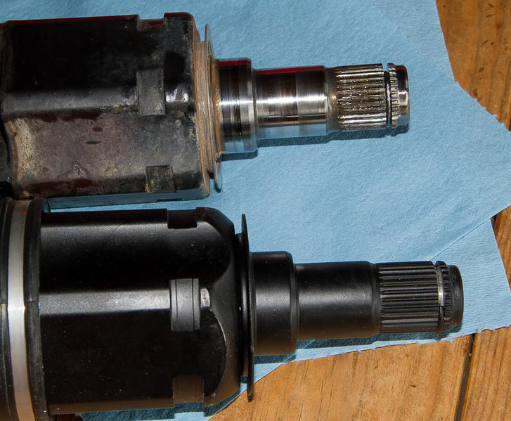

    I wondered about the black paint as well but installed it like it came. However, I did question them about the center part of the axle (green). Mine was 3/16" narrower in diameter than the OE.

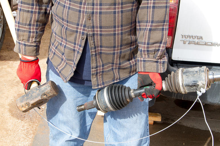

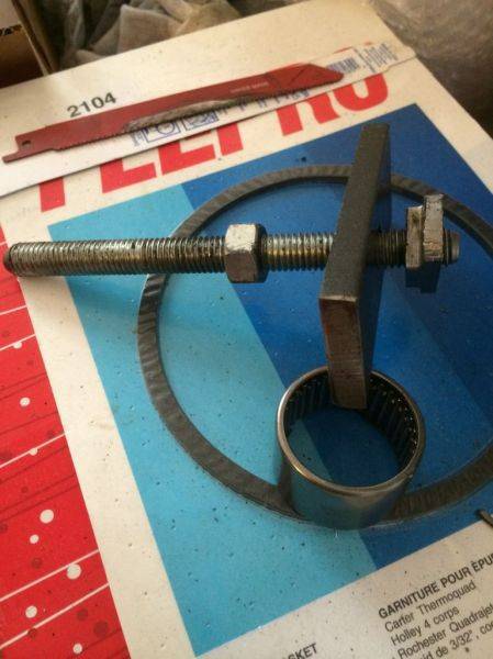

    Bought ECGS bushing, and seal. Arrived in 3 days. Made my own puller using the threaded steel plate from a truck bed stake pocket expansion anchor and grinder. Read/watched as many installs as I could. determined you don't have to completely remove brake or spindle. Started install. Should have had a bigger bfh to get the steering rod off, then the axle out of the spindle- took quite a beating with my rubber mallet to get them loose. videos make it look like these just easily slide apart. I spent the most time getting the axle out- 1st tried prying- no luck, then the cable choker with swing hammer with 5 lbs, then 10, then 15 and finally 20 (using my home dumbells) and broke the choker. went back to prying and was about to give up when it suddenly popped off with hardly any effort. my home made puller worked great once I tapered the ends to fit in the narrow gap. Finally had to use about an 18 inch piece of steel pipe to extend the race driver out so I could get a good swing at it to drive the bushing- thought I would never get it flush- maybe because the garage was about 20 degrees and made the tolerances tighter. Crossed my fingers after double and triple checking everything and went for a test drive . Drove 0 to 80 mph in 2wd held my breath as it passed through 35 to 45 mph.. so far NO VIBRATIONS OR LEAKS!!!! Good in 4wd too. Have 50 miles total. Will update periodically. Sorry no pictures. CV looked good and oil looked good (no metal on plug) so reused CV and original seal (it looked good too). Used 75w 90 synthetic gear oil. Tools borrowed from local parts store- 35 mm axle socket 200 ft lbs torque wrench and race driver kit. Total install time 8 hrs. 3 hrs trying to get axle out. 1 hr figuring out how to drive bushing in. Could do it under 4 now if damn axle would pop out on first try.

    ^^ Fishtaco13 Good to hear your vibrations are gone.
    Wow, 3 hrs to get the axle out! what a bummer. I wonder why the cable choker did not work? Glad I had good luck with it using a sledge. Came loose on the first swing.

    I would like to build a puller (copy) the EGCS , and would like to know the dimensions of the threaded plate that slips in behind the needle bearing.
    Looks like the rig can be built easily out of "garage junk".

    Order the bushing and use it as a guide

    Thanks, Nick.
    Why didn't I think of that !!!

    Just read that idea yesterday then used it to help you haha
