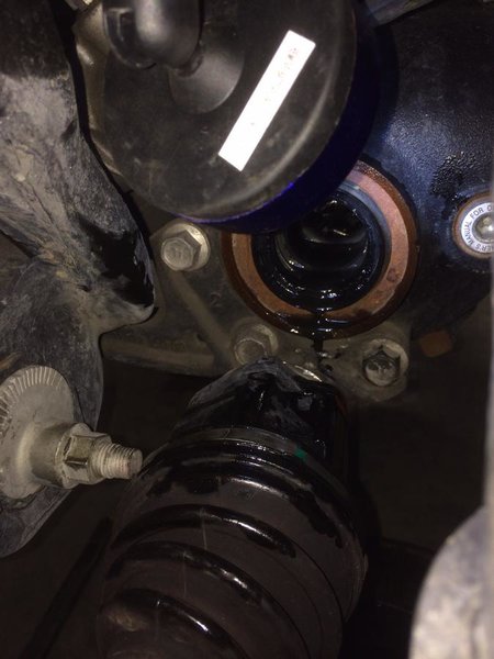

    Installed the bushing today. Did it without removing the cv shaft. Just undid the tie rod, the lower ball joint and sway bar. Popped the shaft loose and pulled the spindle back far enough to tuck the cv shaft under the diff carrier. Worked well! Not a lot of room to hammer the bushing in, but got it done. Pic attached. Quiet so far! Thanks ECGS!

    Quite the shortcut. How much time did this method take?

    Still took me a couple of hours, but I installed some 1/4" top plate spacers at the same time so it could have been quicker.

    Were you able to check the surface of the input part of the CV shaft for damage (scoring of the bearing surface) If there is damage it mayl mess up the bushing. I had to replace my shaft after only 17K on the truck and 1K on the lift because scaring from the needle bearing.

    I only had maybe 200 miles on the lift, it looked fine. This shortcut may not be the best route unless you are replacing the bushing at the same time as installing your lift.
