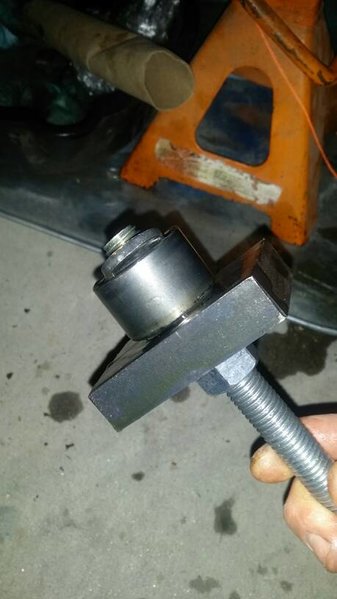

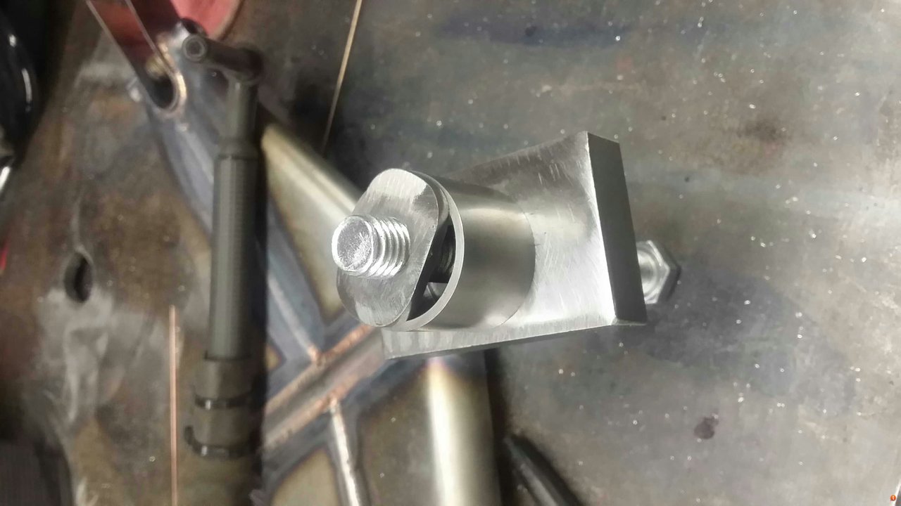

    I just finished making this give a try Tuesday on my day off.

    Nice work. If you have a tough time getting the piece behind the bearing, just bevel the ends a little. I did this on my ECGS puller and it worked like a champ.

    Good idea. We shall see how she fits soon!

    Don't bevel the side that faces the bearing - bevel the opposite side.

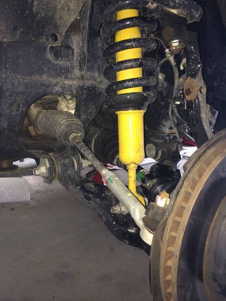

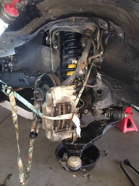

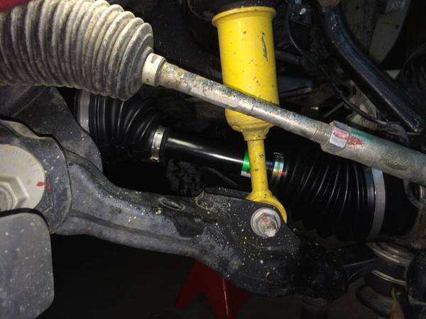

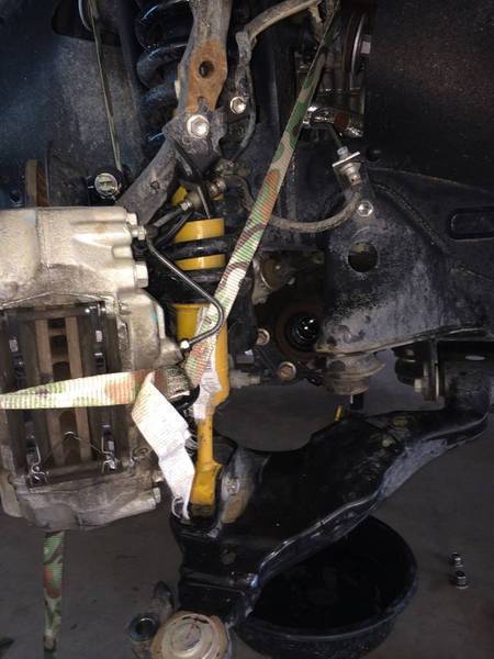

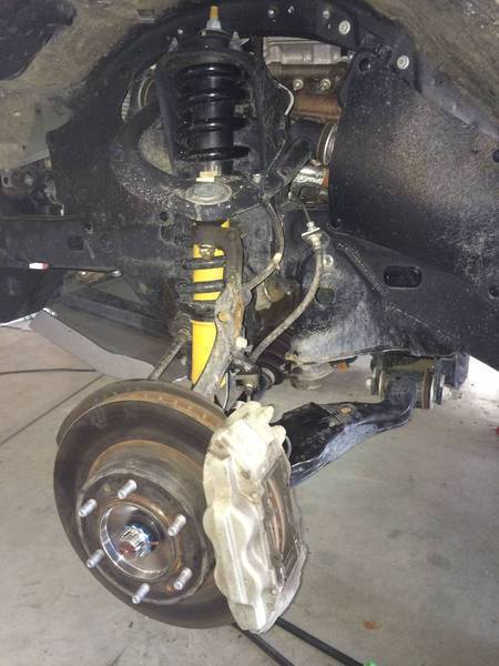

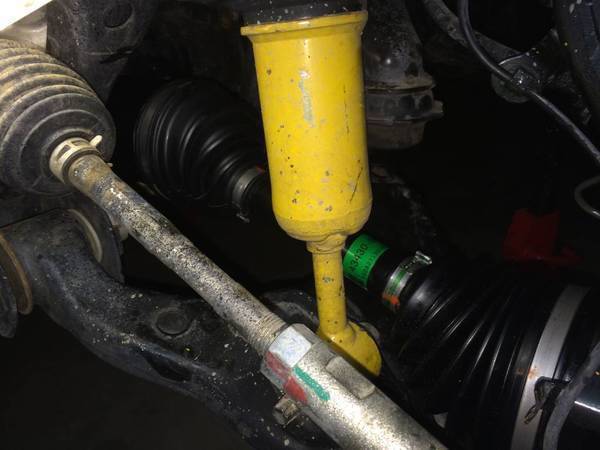

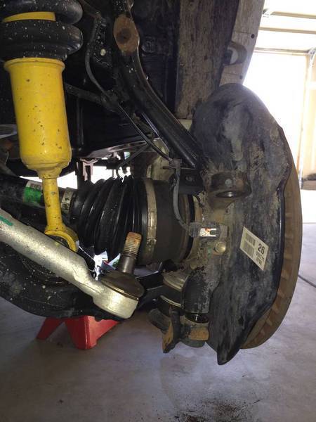

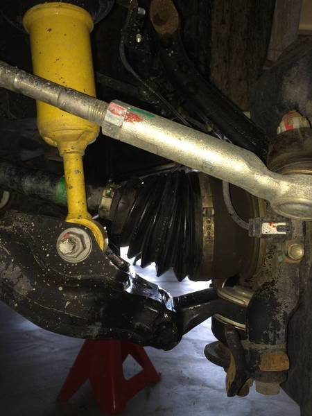

    Replaced my LF CV Axle with a new Toyota assembly. I had damaged the outer cv boot on the original axle and it was slinging all the grease out of it. I removed the needle bearing and installed the ECGS Bushing and replaced the oil seal as well. I used the ECGS Bearing removal tool, it worked great, well worth the money invested. I had also purchased their bushing / bearing installation tool set to get the new bushing into place. I drained all the gear fluids out of the front and rear differentials and transfer case. I plan to refill them this week with red line full synthetic gear fluids. It was nice to see that this repair ended up being easier than I thought it was going to be. I recommend blocking out a day and taking your time and having the right tools is a must. A second set of hands helps out too.

    Just got home from work and was very anxious to try my puller and what do you know first try she slid right out.
    If anyone wants to use this puller just pay shipping and pass it on to the next person here to use.
