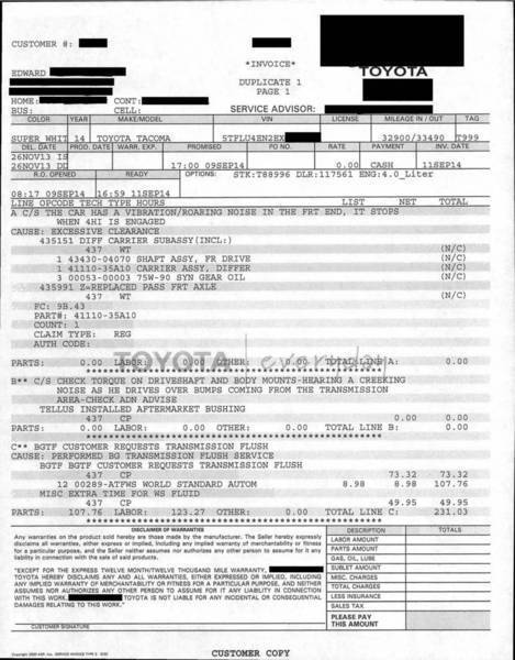

    I have received numerous PMs asking to see the Dealer Service Invoice so I am scanning and posting here for all. I have redacted my identifying info and the dealer's and I ask that you not call them.
    I truly think the key to getting this done was that fact that I noted it early with the service department, documented every communication I had with them, the techs and so on, I also communicated with them every 30 days about the noise and how it got louder each month (be the squeaky wheel - or bearing), used this TW forum to support my request to have this done, provided them bushing info from the ECGS website, bought and provided the ECGS Bushing at my expense, and just got lucky.
    So on the invoice, they noted "installed aftermarket bushing" in the section where I asked them to re torque the factory bolts - part of the 30K mile servicing. not sure why they noted it there or why they worded it that way.
    And I had my transmission flushed and filled.
