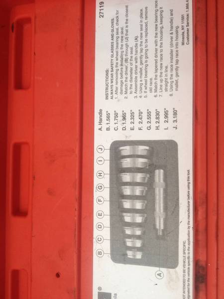

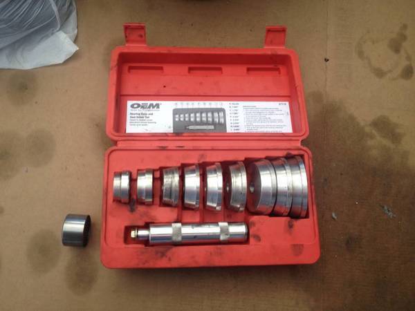

    I recommend of course having the removal tool, but also having/renting the bearing race driver kit. I know other people have used a socket to drive the bushing in, (such as the back of the 35mm socket)but we tried and you couldn't see to drive it in, potentially risking driving it in crooked.
    heres what i rented. it was around $60 deposit at Autozone.
    you will use the smallest diameter drive head, the 1.565" dia

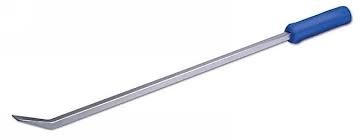

    I just used a pry bar like this, about 3' long. Sometimes you can find a pack of 3 in different sizes at most auto parts places. Great tool to have for other jobs.
    use a rag against the diff housing so you won't mar up the edge.
    Like others have said, if it doesn't want to budge at first, try rotating the cv axle little by little, it will pop out.
