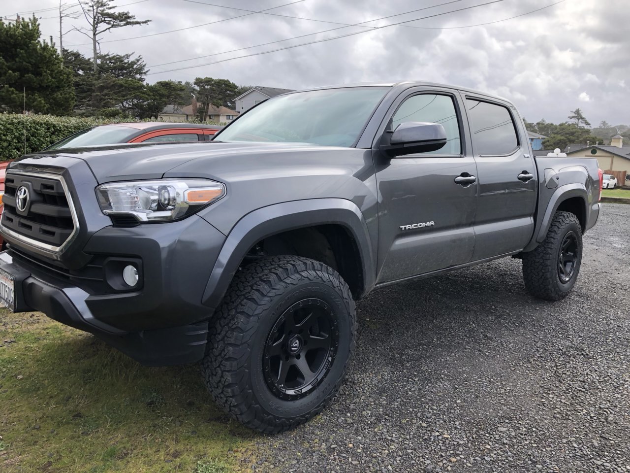

    I was considering 285s just didn’t want any rubbing possibility. Unfortunately living in an apartment I don’t have access to my welder right now.
    Or I probably would’ve gone with the larger and been able to do all the fixes if need be. Regardless theblook is great and wife’s happy that’s all that matters :amen:
    Lift was simple to install. The 6112s were a bit of a pain to install the coil because the clamps I used didn’t allow to easily slid over the strut body. Should have just had wheelers do that for cheap. Also cutting the rivets off the stock spring retainers on the rear leafs wasn’t hard at all. And only had to do the rear retainers and one off the overload leaf

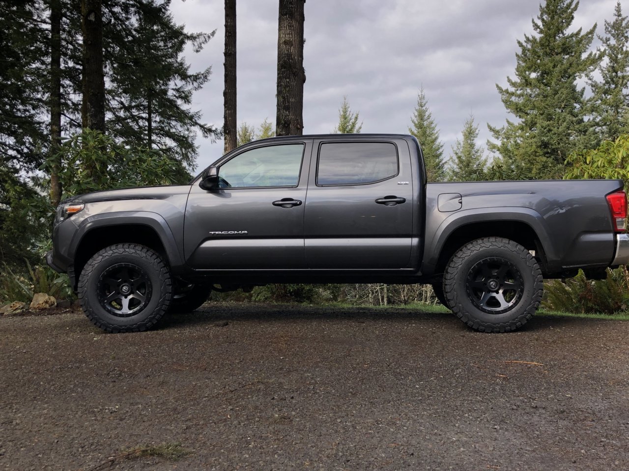

    Got any side shots?
    Sweet rims?
