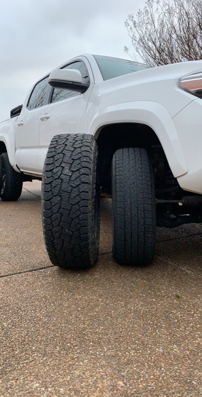

    Just got this setup for my Taco and sadly, it does rub. Not on normal, flat turns or anything, but whenever there is some sort of small dip involved it smacks against the wheel well. Definitely need a small lift/leveling kit

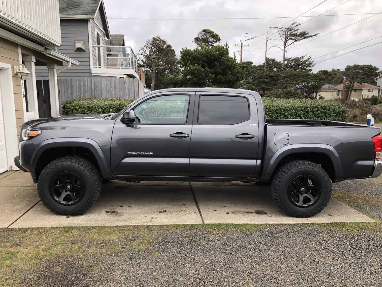

    It’s not a TRD sport but this is that setup with the front set at 1.75”. Just imagine it with a hood scoop.

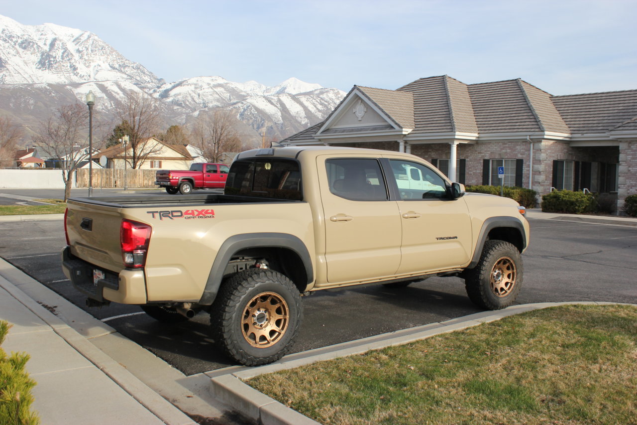

    Finally got my wheels, tires, and lift done. Falcon lift 2.25" (unverified) with 275/70/17 KO2's. Wheels are Method Roost 17x8.5, 0 Offset.
    As far as drive-ability goes, I personally feel like the wacky transmission in these trucks is better suited to a slightly larger tire. It downshifts more appropriately, and I don't feel like I have noticed a change in usable acceleration. In fact, I would say I was worried for nothing. Zero rubbing so far, aligned fine, I like the look, and would do it again in a heartbeat. I have to drive the truck offroad a little before I can comment on the Falcon Suspension, and everything here is newly covered in snow again, so it's going to be weeks until I get off the asphalt.

    Looking good. Did you get the tow/haul Falcon shocks? Also did you add the 1.5" block if it came with your kit? Really digging the height.

    Thanks! Yes, I got the full kit with the lift. If I remember correctly the only option with the 1.25" lift is the tow/haul rears. I'm happy with the lift. It would look fine a little shorter, but I don't think it's too tall

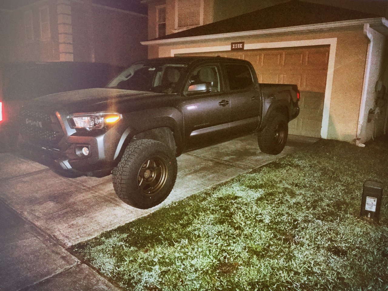

    275/70/17 KO2's on SCS Ray 10's. OME Medium lift w/stock UCA. No rubbing, no CMC. Best tire size for these trucks IMO.

    Nice - I like the gunmetal on quicksand, almost as much as the bronze :)

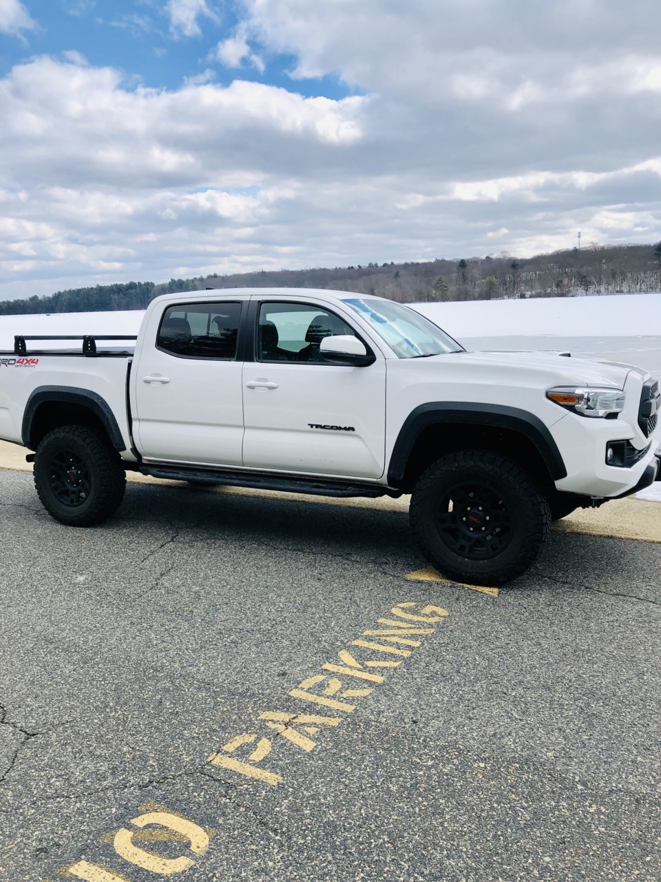

    I have the 4Runner Pro Wheels and do no need spacers. They have a 4mm offset. I'm running Bilstein 6112 in the front and 5160 in rear for about 2.5" lift

    So is the consensus that these tires don’t rub a stock truck at all with a reasonable offset wheel (not huge poke)?
    Are they the unicorn “biggest tire you can fit without rubbing”?

    I'd agree. I was able to run this size for a few weeks on my stock suspension before my lift.
