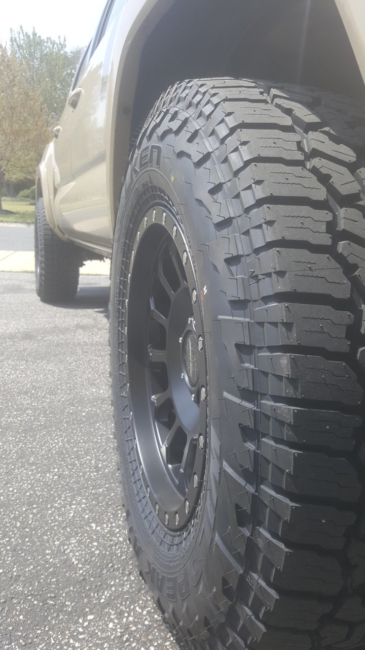

    Upgraded to some Falken Wildpeaks AT3W LT on some Method 305 wheels, here are some before and after pics going from stock.

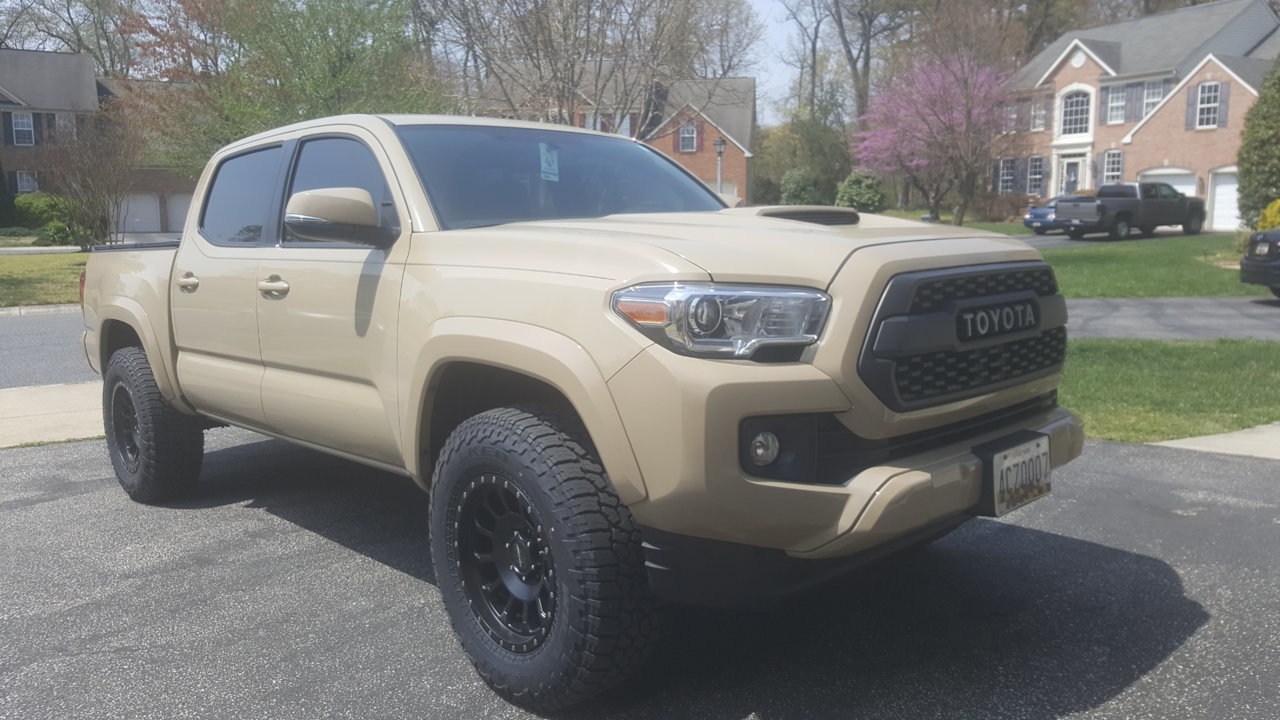

    275 70 17 stock suspension with Pro Comp 5034.
