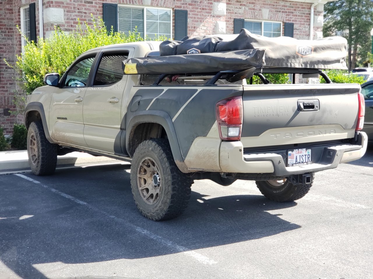

    On road it's pretty firm and jarring for my taste, especially the rears. When I'm unloaded I have at least 150lbs of ballast in the back under my tonneau to keep from giving me a headache on our crappy local roads. Off road is a dream - super nice, especially loaded up for camping. I just did a big trip into the high Uintas with lots of offroad miles and it was perfect.

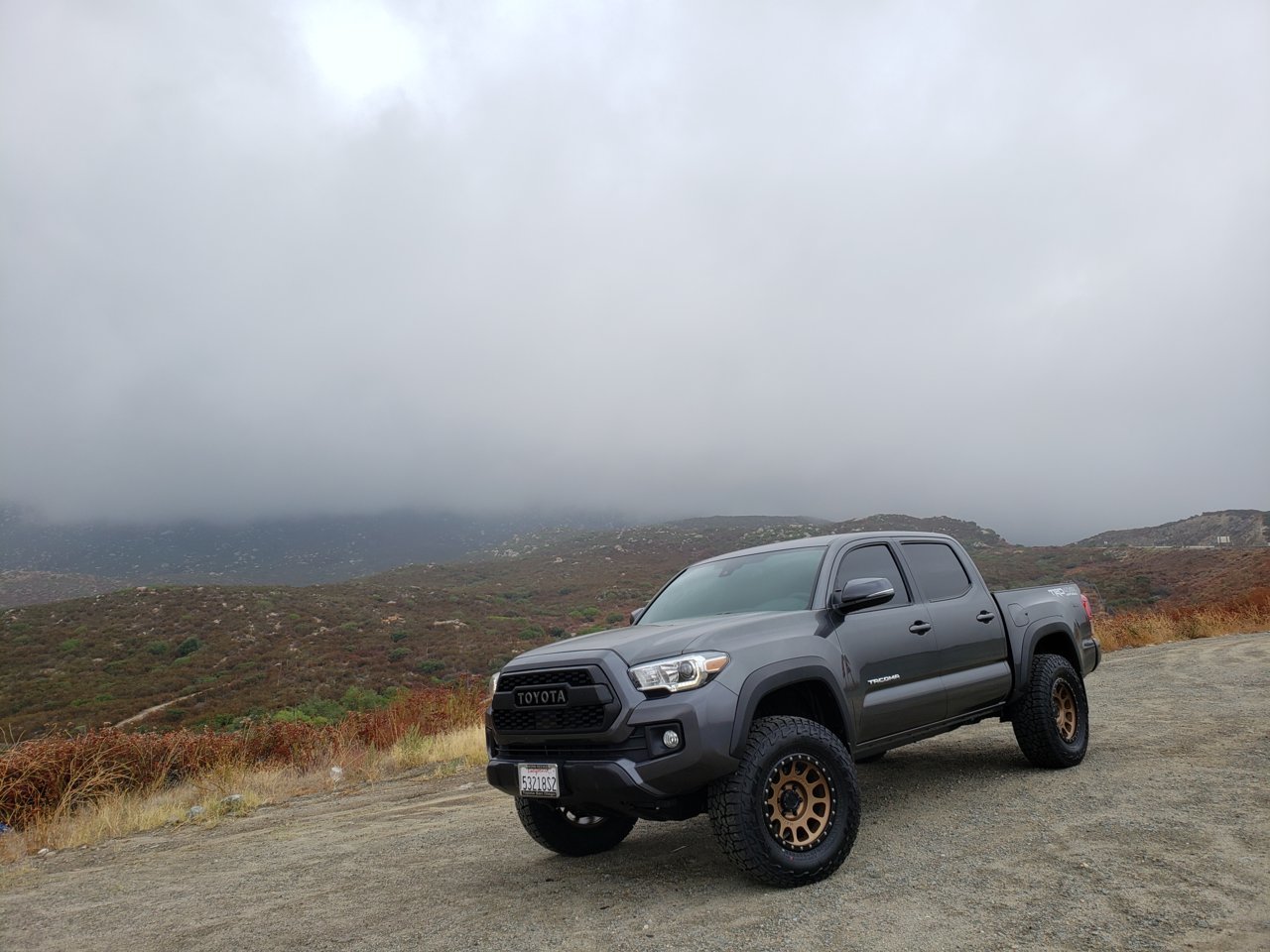

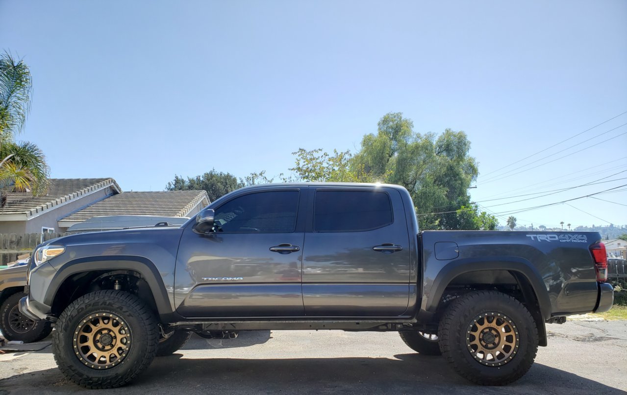

    -10 Offset will get you flush with the fenders and gives you plenty of clearance from your UCA. Im running ray10s 17 x 8.5 -10mm.

    BC
    2018 TRD OR DCSB
    Sorry for the late reply. At the time this photo was taken, I had A LOT of rubbing with the plastic and cmc. But after i upgraded to SPC control arms and proper alignment, I had much less rubbing issues. Only rubs when the tires are stuffed during off roading.
