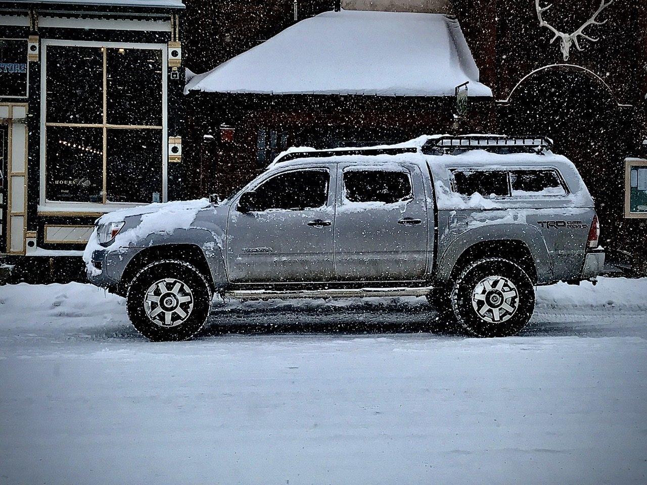

    #846
    PasswordIsTaco123
    PasswordIsTaco123 Well-Known Member
    Dec 16, 2017
    #238683
    224
    Scott
    Littleton, CO
    2015 DCSB TRDOR
    2015 Silver Bullet Taco Installed: 5100's W OME887's +1/4leanspacer Toytec Boss Rear shocks Headstrong AAL + 1/2in block Ubolt Flip W superbumps Front Superbumps CB drop kit 4runner Trail Edition 17in Wheels Tires: Falken Wildpeak At3 C-load 275/70/17 Hooke Road Roof Rack Have but may/may not install Ex rear brake lines diff drop
    I know this is 3rd gen thread but i have 2nd gen with the 275/70/17 wildpeaks. 17x7.5 -15mm offset. Slight rub in reverse full lock but i haven’t done any of th enecessary trimming yet. No issues with balancing and like others also thought at first i didn’t like them size wise and was imagining a more tire-y 16 setup w 285s but had the same feeling of it grew on me big timd. I think they’re great now. And we get a lot of snow to deal with in CO so i figured slightly skinnier tires would do better in that. Weight is surprisingly heavy but at this size and ply you actually get 4/32 more tread depth than the e rated 285s.
