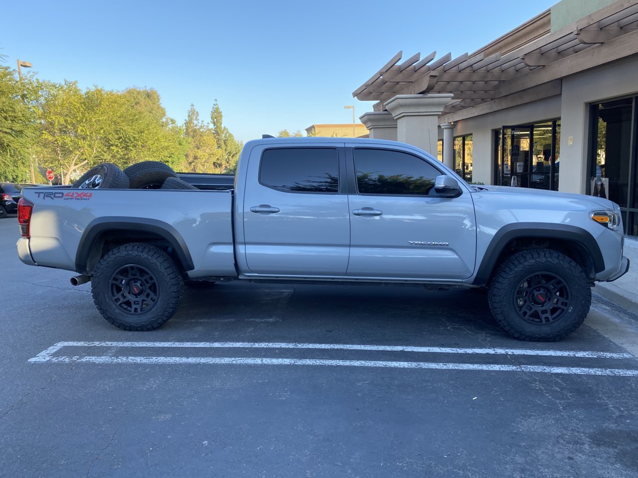

    Just put some KO2’s on stock OR suspension with 4Runner Trd Pro rims. Normal street driving, going up and down driveways, and I get no rubbing. I’ll be doing some light fire roads this weekend to see how it works out. Also thought the E rated tire was going to rattle my teeth loose, but in the end, the truck just feels more planted.

    I can honestly say that the truck has lost most of what little “enthusiasm” it had before in the low RPMs, but up high, feels pretty much the same.

    Oh it’s totally tolerable. I just did a 140 mile drive today and it probably took half that distance to get it all sorted out. I probably won’t ever regear with this tire size.

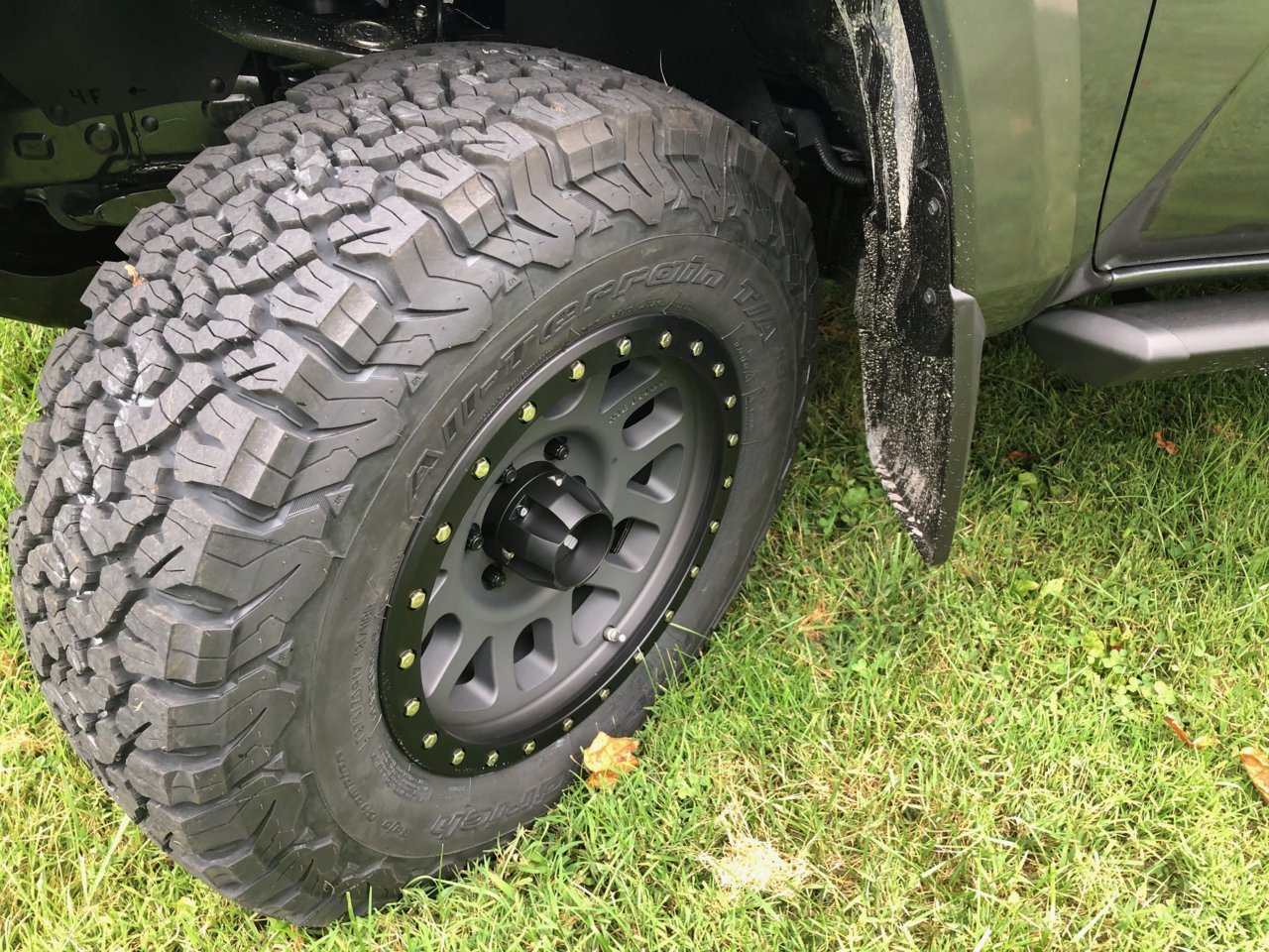

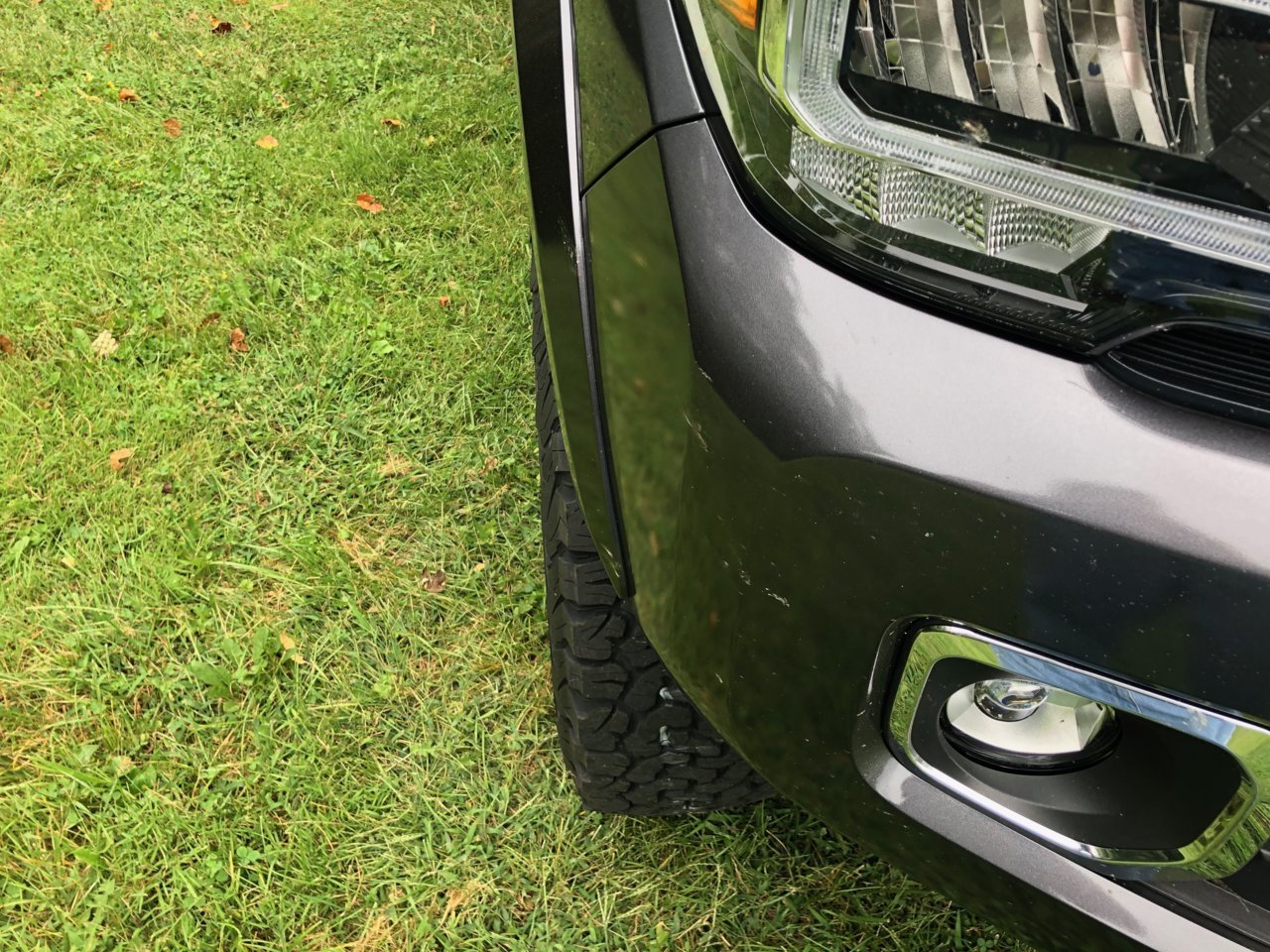

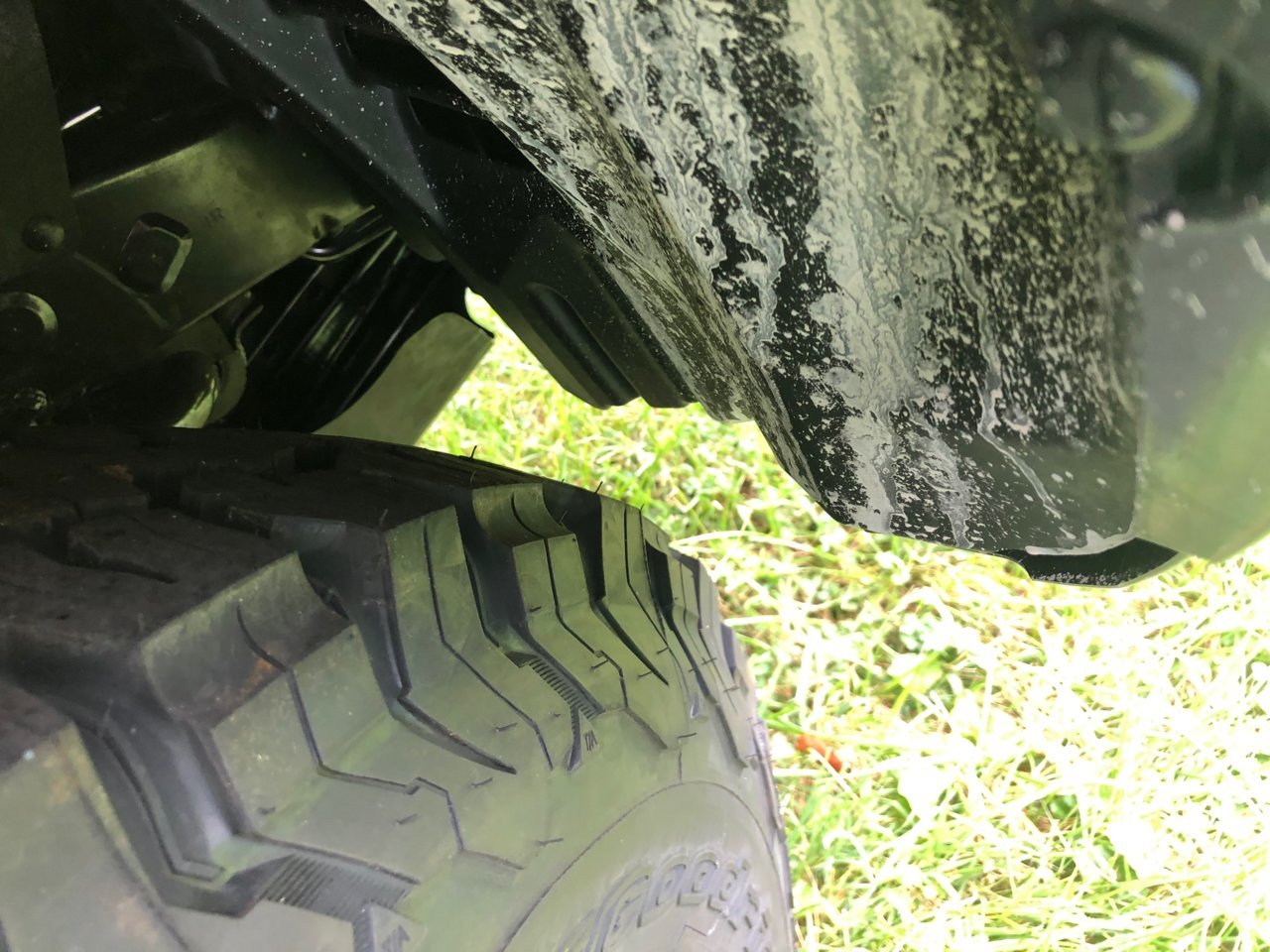

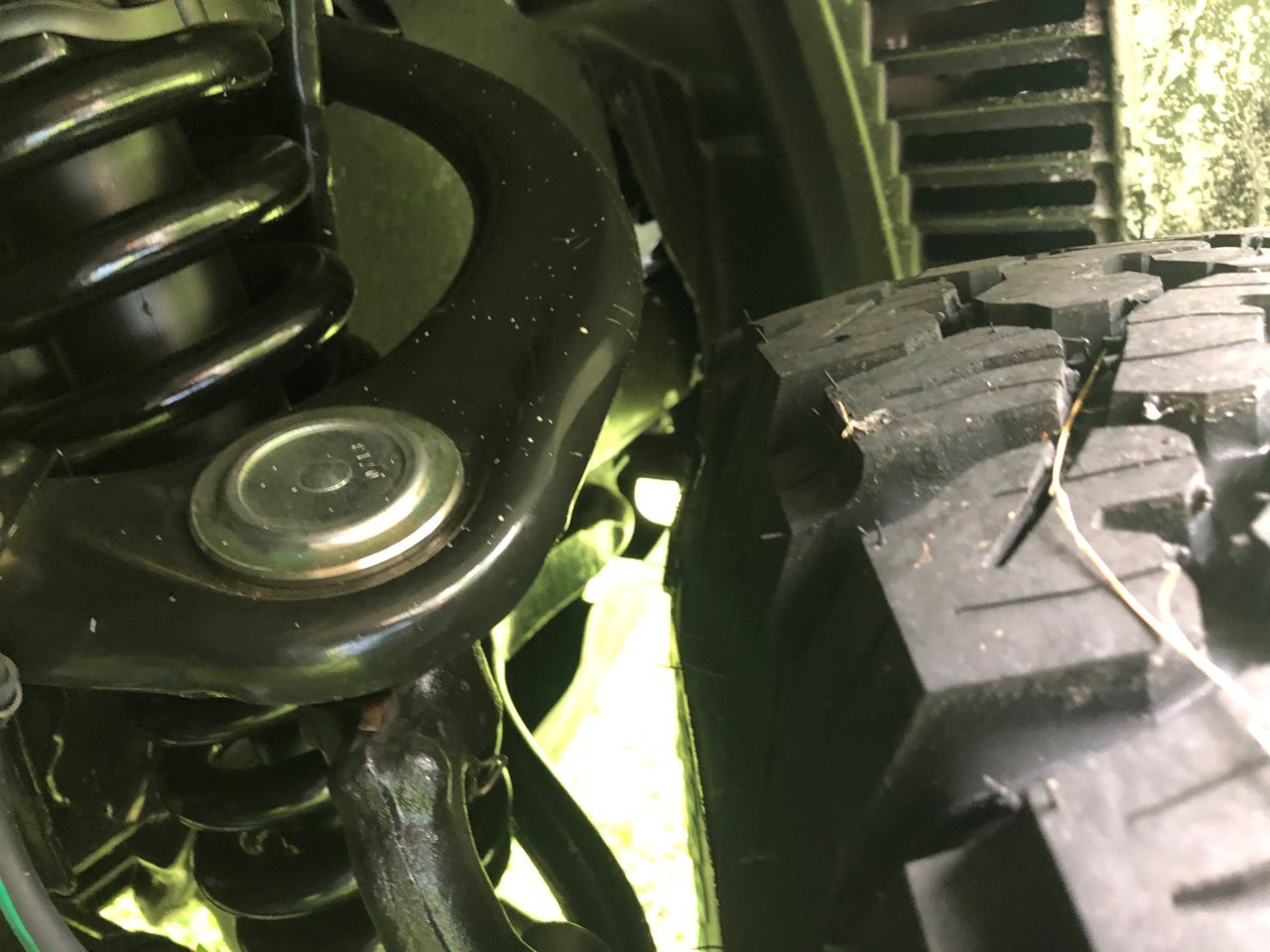

  15. Sep 11, 2020 at 2:11 PM
    #955
    AsphaltCrawler
    AsphaltCrawler Member
    Aug 21, 2020
    #338341
    12
    Daniel
    Alabama
    Magnetic Gray 2020 Tacoma Limited
    6" BDS Lift, 35s, 5.29 Gears, E-Lockers F & R

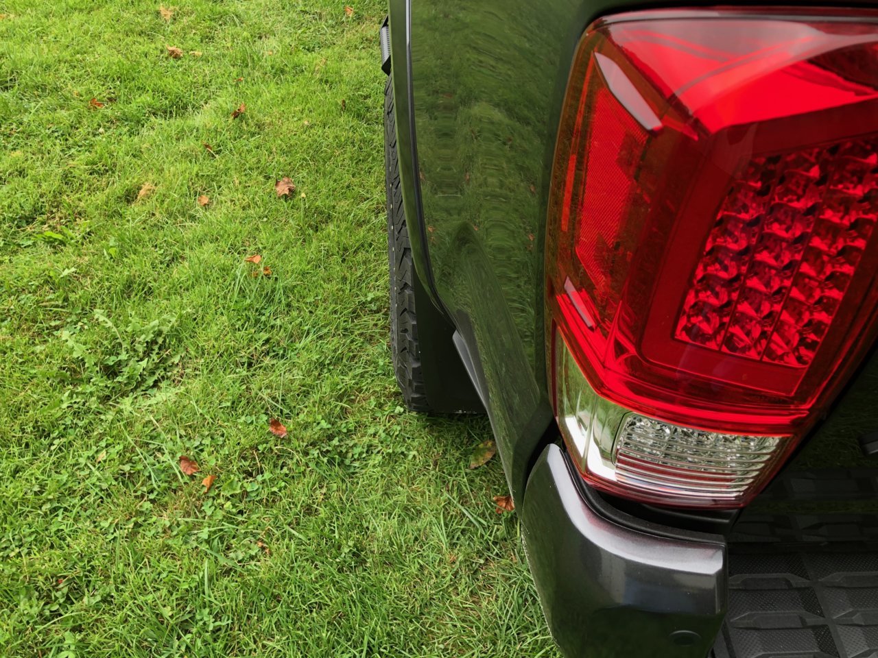

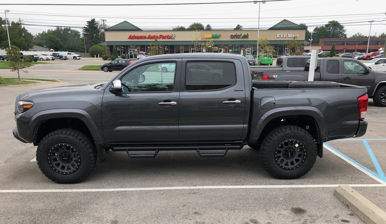

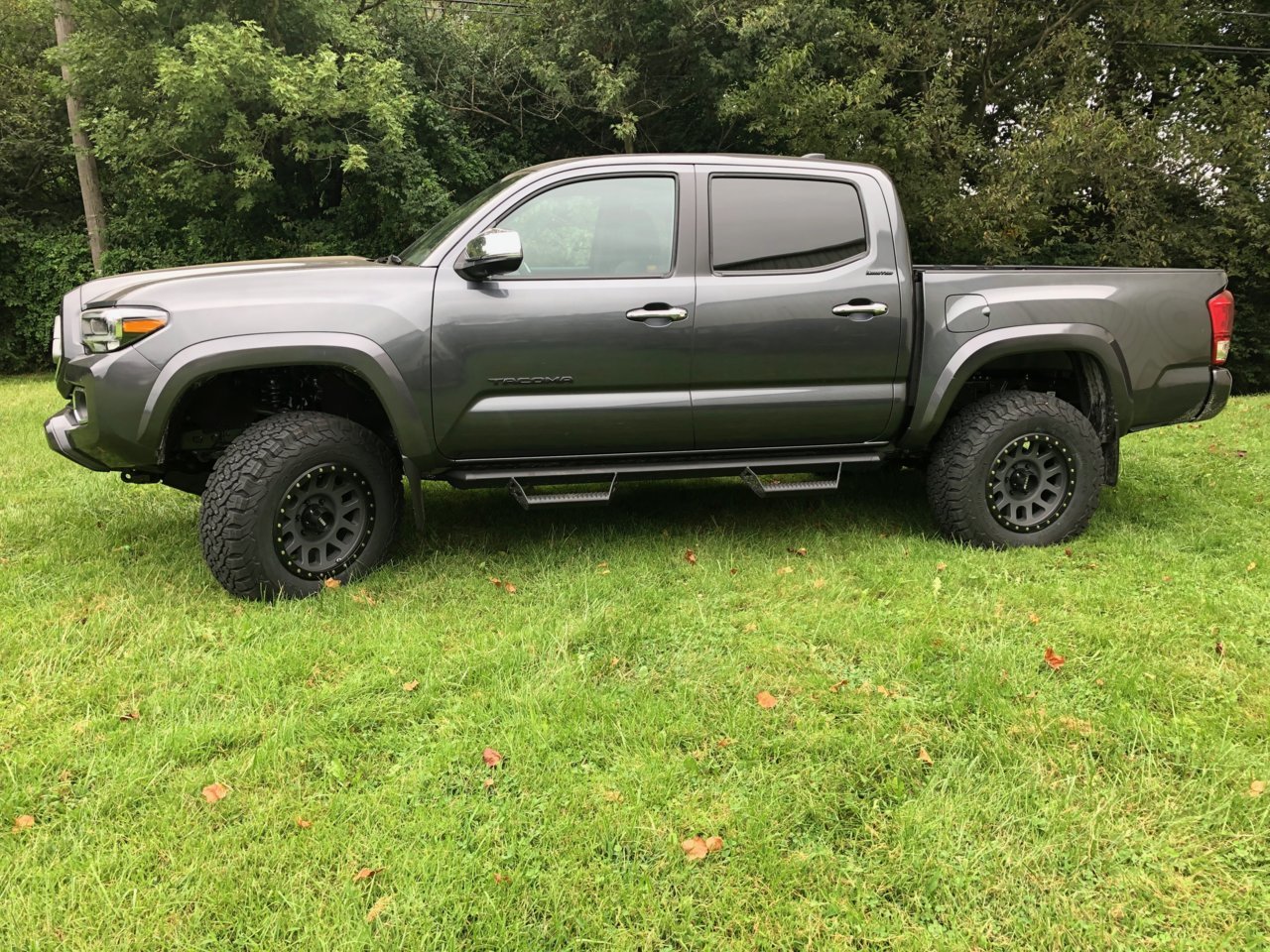

    Thought I'd add mine to the mix. 2020 Limited with a 3/2 LowRange level kit, OME rear shocks, Method 309 Grid Titanium wheels with 4.75 backspace and 0 offset, 275/70/17 KO2s. Zero rub. Here are some pics, hope they help someone...

  17. Sep 11, 2020 at 5:41 PM
    #957
    AsphaltCrawler
    Aug 21, 2020
    #338341
    12
    Daniel
    Alabama
    Most likely. However, the wheel is the key. My stock Limited wheels have a +30 offset which leaves about 1/2" clearance between the stock tire and the UCA. There's no way I could have put a wider tire on that wheel. Just choose your wheel carefully...

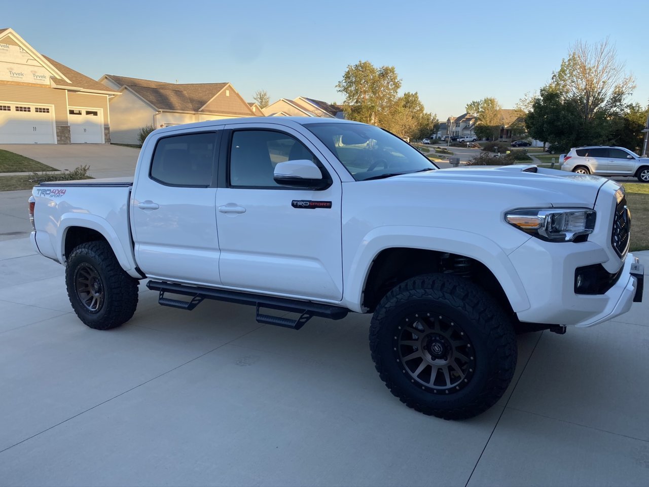

  18. Sep 11, 2020 at 7:15 PM
    #958
    Edubreuil
    Edubreuil Back in a Jeep
    Jun 13, 2019
    #296282
    171
    Ed
    Cornville, Iowa

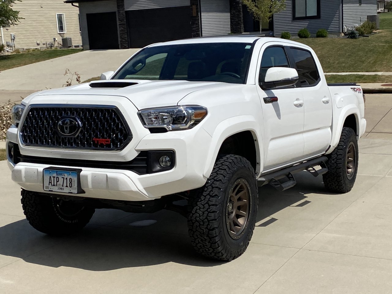

    2021 Jeep Gladiator Mojave

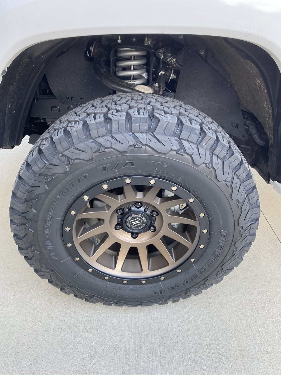

    275/70 R17 KO2’s on dark bronze Icon Compression 0 offset wheels. Eibach pro lift on first clip setting. 1” blocks on the rear. No rubbing at all. 0704C09A-1F80-496F-94BD-F8C67B2AB625.jpg02FA2D0F-AED1-482A-B50B-CDC7BE356B04.jpg0909A078-9DEF-419A-89F1-D648DE3BC439.jpg

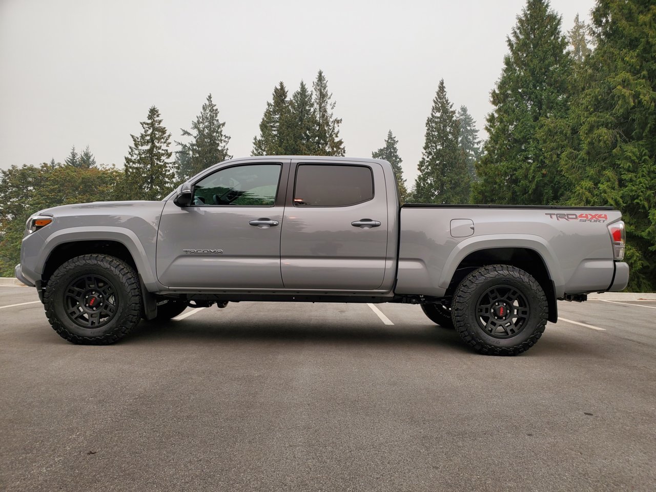

    275 70 17 KO2 on 17" Bronze TRD Wheels AFE Intake Magnaflow Exhaust OEM TRD Pro Grill
    2nd day of ownership
    275 70 17 no lift...front mudfaps rub on inclines.
    They will be trimmed or removed in the coming days.
    Thanks to this thread I was able to run this tire size.

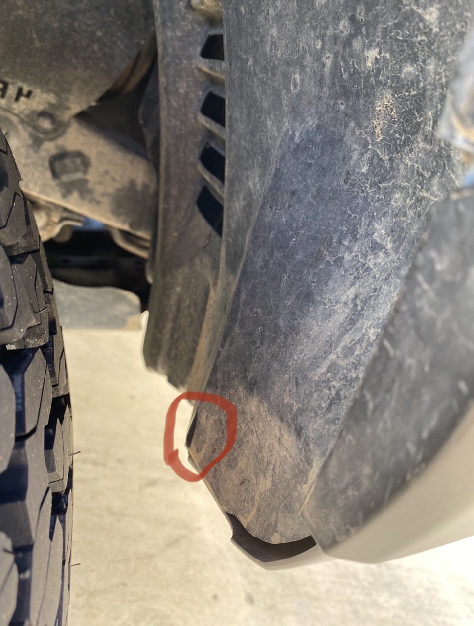

  20. Sep 12, 2020 at 9:58 PM
    #960
    PuckerbuttPliny
    PuckerbuttPliny Well-Known Member
    Jun 9, 2020
    #330948
    72
    California
    2018 TRDOR 4X4 DCLB
    275/70r17 KO2 E Load 4R TRD Pro Rims
    take a look on the front part of the inner fender. I’m running the same rim and size, and this is one of the random places I would barely rub when on trails. Perks of having the truck dirty when hearing a rub!
