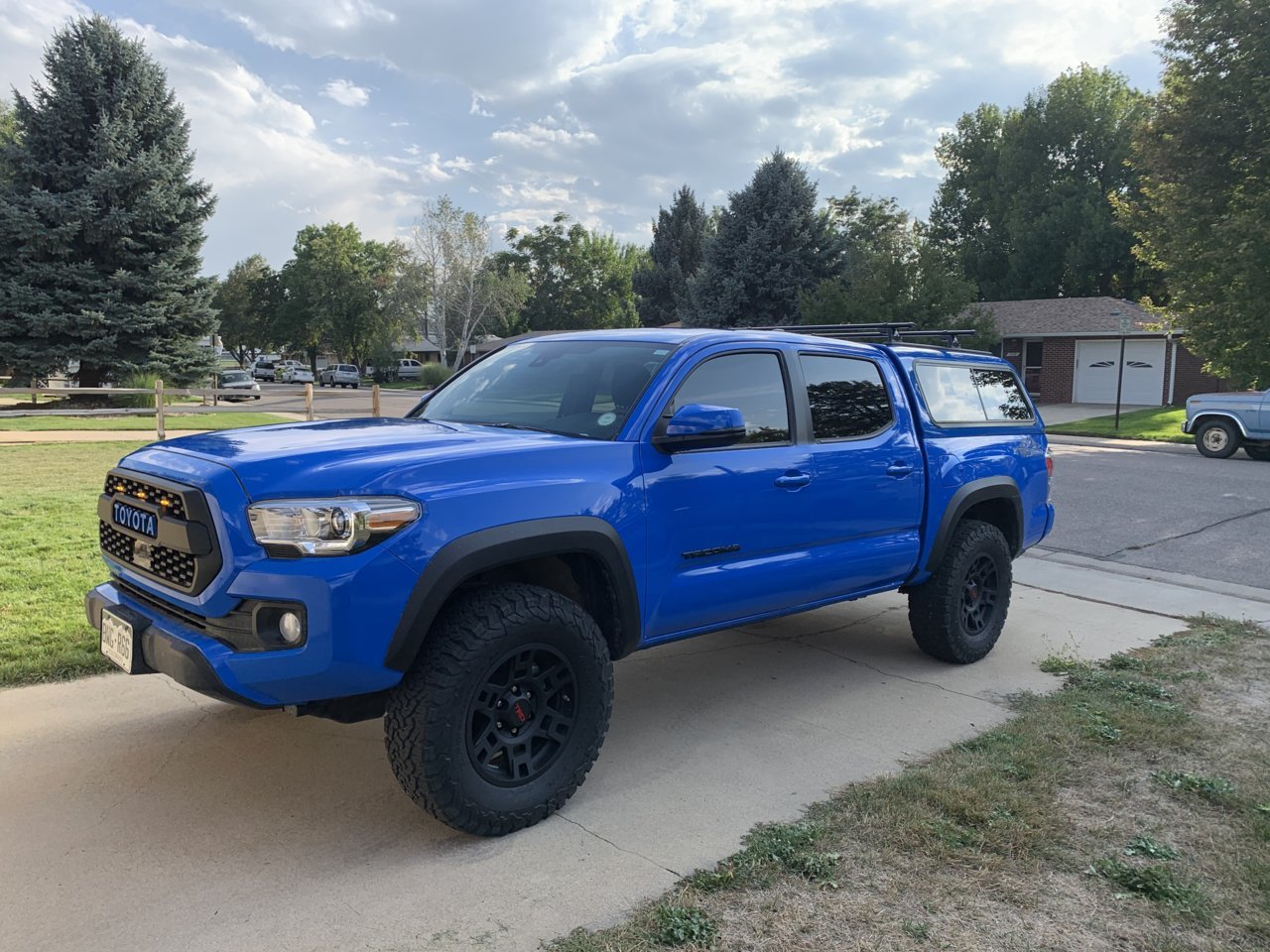

    8406A118-D571-4455-8F55-4632D4B85B0A.jpg 280B5B04-085E-42EC-928D-E720F0C71E89.jpg My 2020 TRD Off-Road is completely stock (minus some cosmetic changes).
    I read this entire thread trying to decide if I should get 275/70R17 tires for my truck. I decided to pull the trigger and thought I’d post to help others that had similar questions to me!
    My big question was “will they rub at all off-roading”. I’ve now taken my truck with these tires off road on a couple moderate trails. Experienced full flex, k-turns reversing with wheels completely turned, larger moguls and rocks, etc... and have had ZERO rubbing.
    Another question I had that I couldn’t find answers for, so I gambled, was “would a fifth tire of this size fit under the bed?”
    Again, the answer here is yes it does fit! With no necessary modification.
    My setup is TRD pro 17” matte black wheels and BFG K02s 275/70R17 tires.
    A couple notes on the tires...
    I don’t notice any more road noise than the stock tires. I don’t notice too much of a power loss due to tire weight. I do notice a slight drop in MPG, but only 1-2 less.

    The ko2 will get a little louder in time but not too bad. Have 20k miles on mine and can hear the tires more than when new. Just an FYI.

    Very helpful post. Tires look great on your truck. I’m pretty set that 275/70/17 will be my next tire size, just trying to decide between the KO2s and the Wildpeaks...
