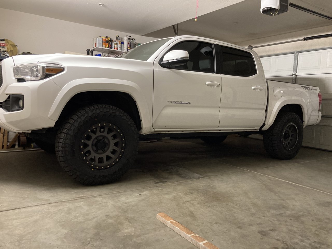

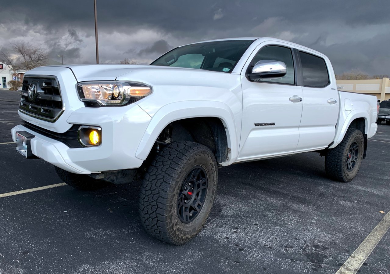

    275/70/17 on falken wildpeak

    275/70r17 KO2 E Load 4R TRD Pro Rims
    Looks great! How high of a lift are you running?

    Right at about 3”. Honestly, a little higher than I wanted to go. I was thinking that I’ve got a little too much room up front (if that makes sense)
    Just got it back today.
    bilstein 6112 / 5100 rear

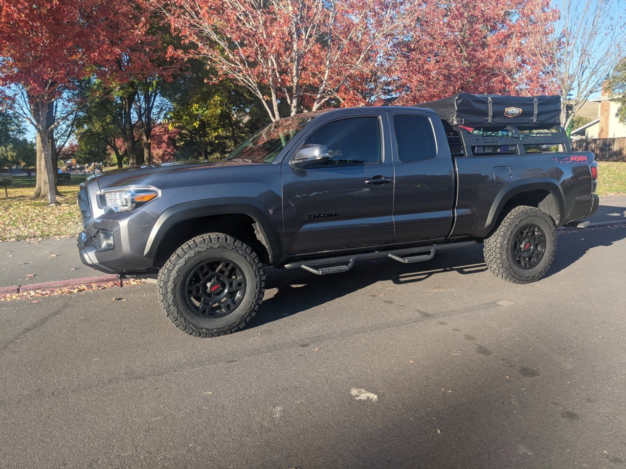

    Baby got a some new shoes today. I have an OME full suspension kit and had General Grabber red letter MT. They sucked, cupped like crazy and noisy.
    New BFG's 275/70-17 ride smooth and look great!!!!

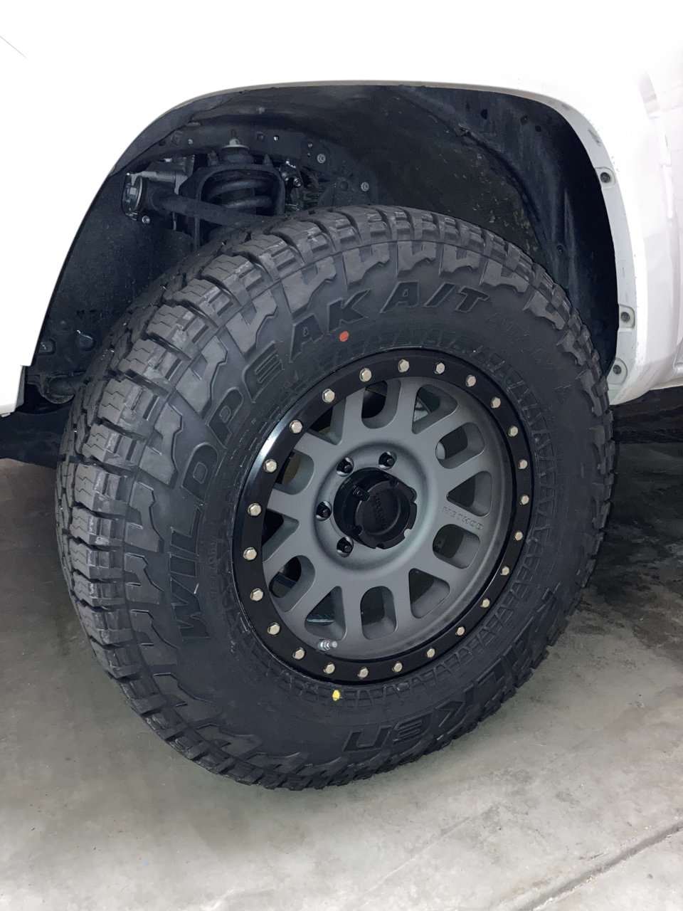

    275/70/17 Falken Wildpeak, 5100's, 3 way active Morel system, custom dual 10 box by Marv, Method grid titanium wheels

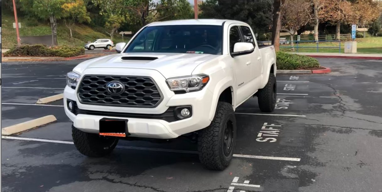

    Just got my 275/70R17's BFG KO2's. No lift yet--Some rubbing on the air dam and the plastic edge on the inner wheel well. Plan to get the lift over the next couple weeks.

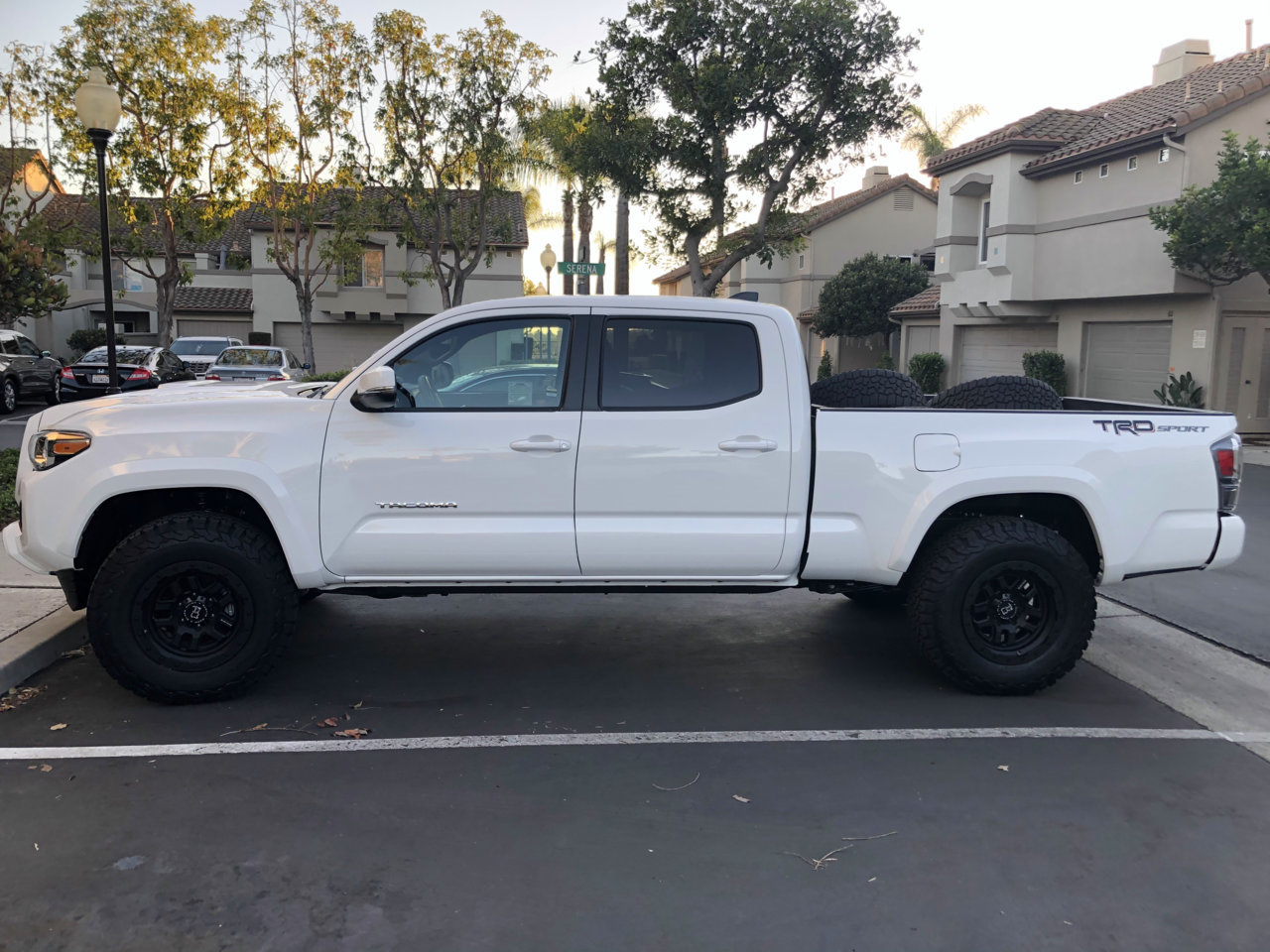

    Another photo of 275/70 R17 BFG KO2's, now with a 2.5" lift in front and 2" in rear. These are on 9.5" width wheels with a negative 18mm offset. I wanted the wider stance of a 285, but with a just but more room in the wheel well. With the lift, I have no issues with rubbing. Spent a lot of time debating between 275's and 285's. I think I would be happy either way, with maybe some slight advantages and disadvantages to both.
