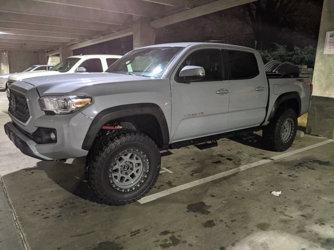

    BFG KO2 275/70R17s + Bilstien 5100 (setting #4) + ICON AAL without overload leaf. Slight rubbing on stock front mud flaps while turning up into a slope (I think I can just grind off a hair in one spot). Don't really notice much of a difference in feel with the weight/size difference of the tires. Fully expecting a slight drop in MPGs. Overall, very happy.Screen Shot 2021-01-18 at 9.38.32 PM.jpg

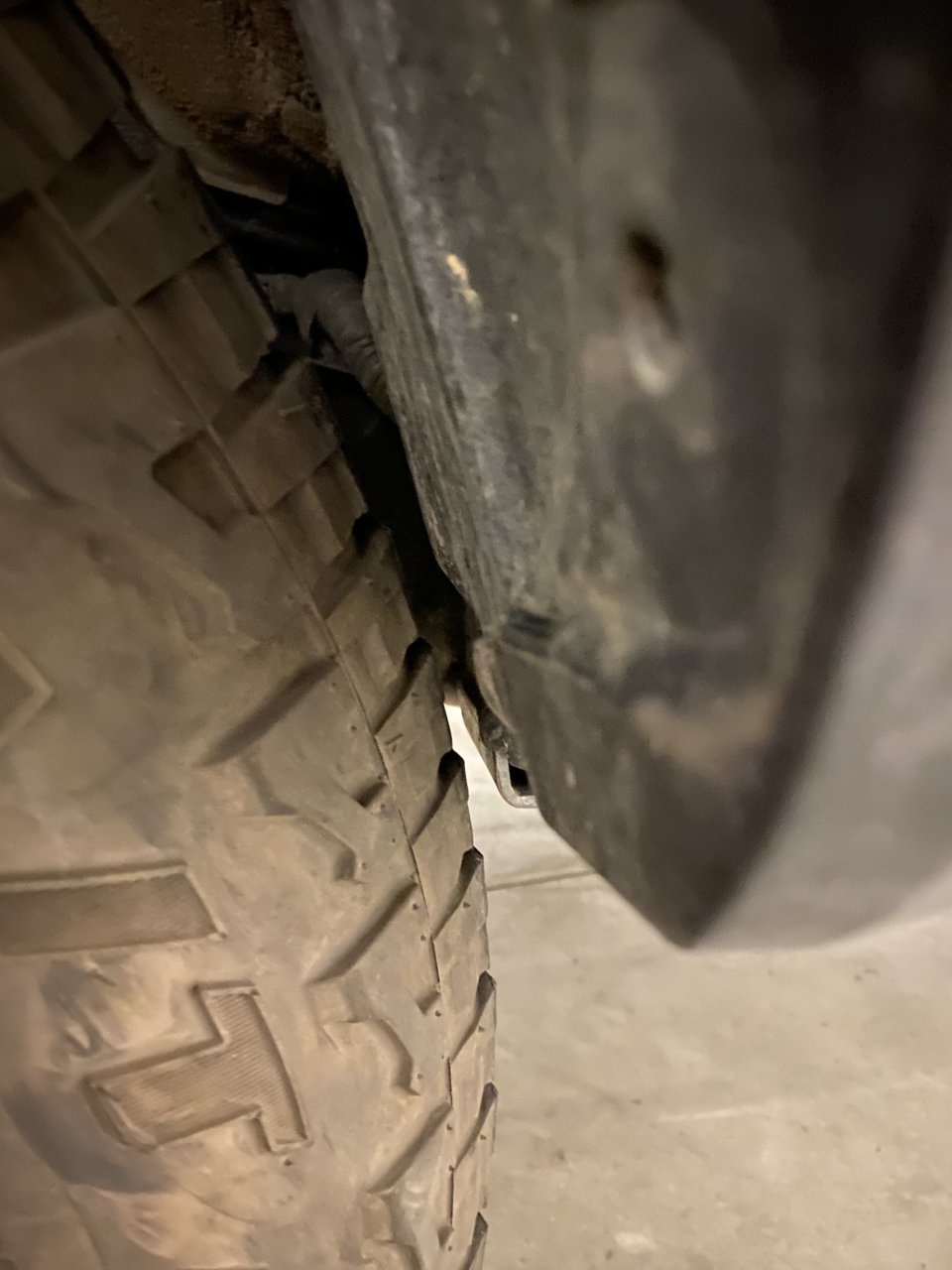

    This is likely due to the offset as you mentioned. Here’s me 265/75/16 on a -12 offset near full lock.
    the alignment can definitely help. But the technician needs to know you want to push the wheel forward and will need to know how to do that (getting rear LCA cam bolt outward and front one inward). You need to go to an offroad shop most likely where guys know about alignments and fitting bigger tires. There’s no caster adjust on the JBAs so they’ll need to be okay push the caster more positive than it already is (3.0).

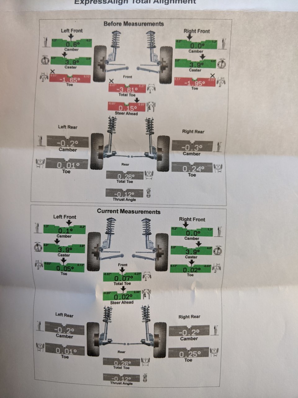

    Update:
    got an alignment today. rubbed once since on a pretty slow and tight turn. May be able to get away with some plastic heating and mashing.
