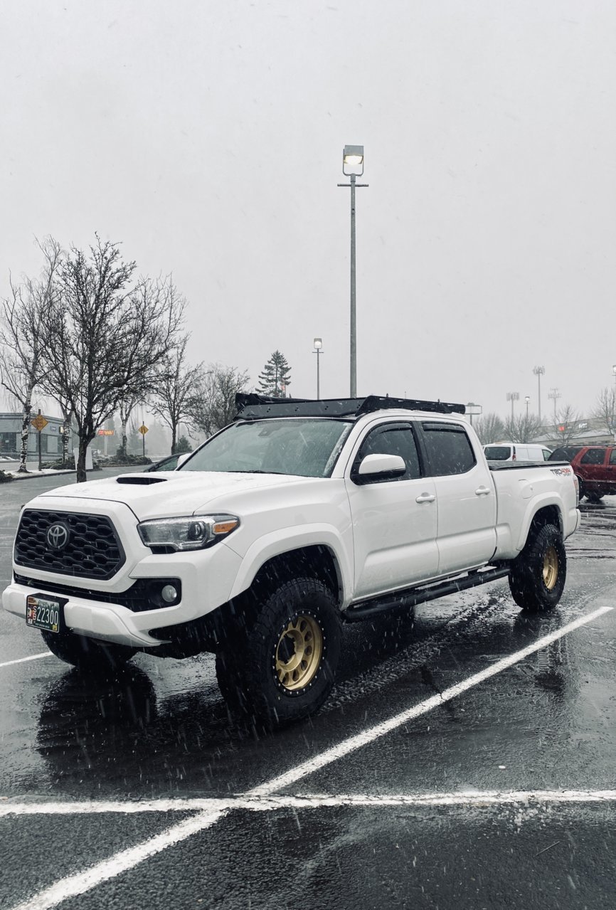

    looks incredible! Thanks for sharing!
    What size lift and size tires? Also can you share the offset of your wheels?
    Do you have any rubbing at all?
    thanks again!

    Thank you! I have a very similar set up like other people here. Nothing fancy. Bilstein 5100s and a 1” block in the rear with 275/70R17. Wheel offset is -12
    Edit: I forgot to answer if I rub. Not anymore, since I cut my bumper a while back

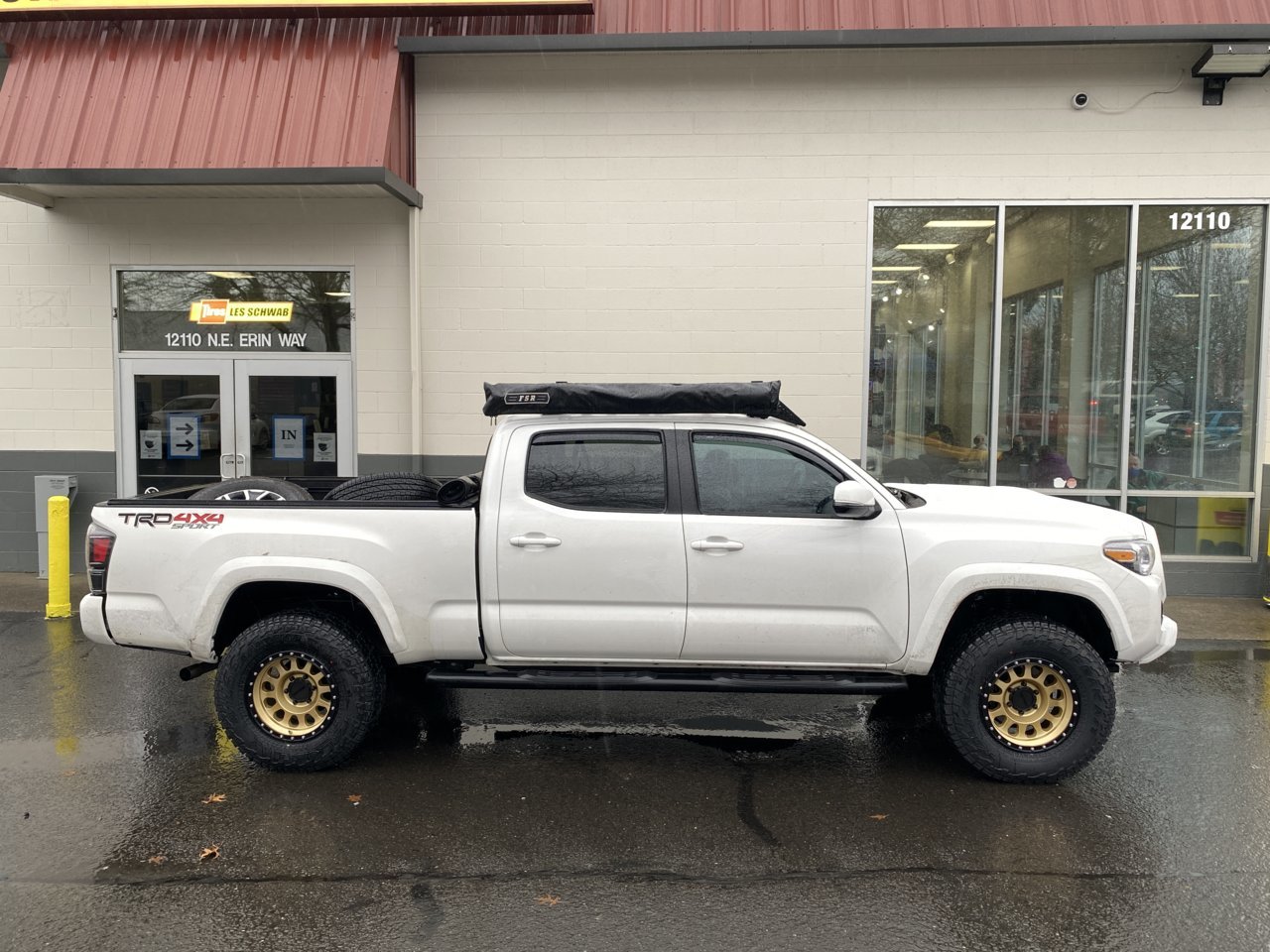

    looks great, is it a 2.5" lift in the front? I have 275 70 17 on TRD wheels and was thinking 2.5 upfront and 2" in the rear. will that give too much of a rake?
    Can you please share a side view?

    It’s only a 1.55” lift in the front. I can go 2” in the front but that’s the max on these Bilstein. I’m considering going the full 2” so it can be leveled by I’m not sure. I think I want to keep some rake like I do currently just in case I carry something heavy in the rear.
    I think If you do the 2.5” in the front and 2” in the back you’ll have about the same amount of rake as I do.
    I can get you a more accurate photo of the side tomorrow morning. I only have side photos of it when I first got my new wheels & tires on and I was carrying all 4 stock wheels in the bed.
    Here is the photo just because lol

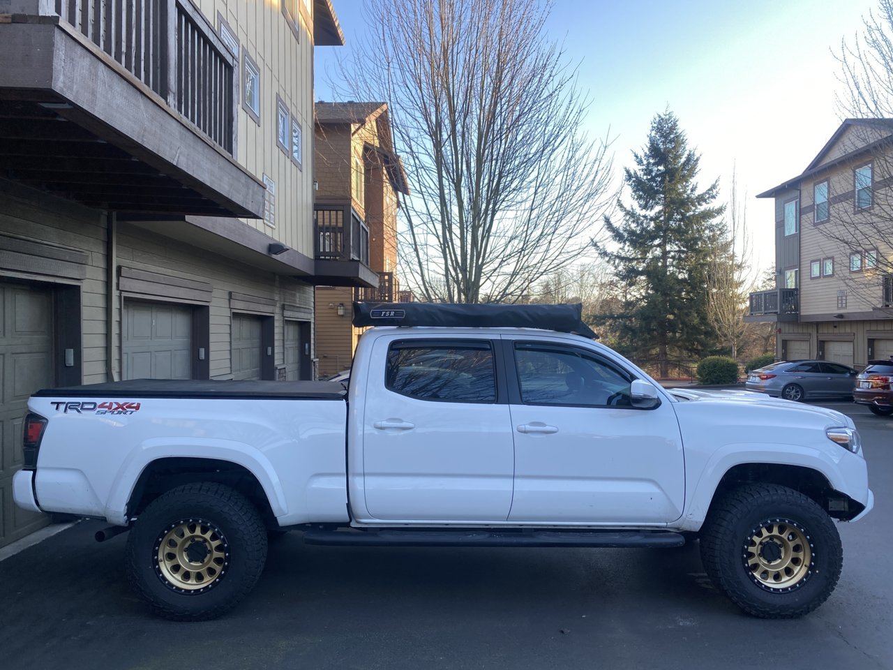

    that looks sharp, looks like a bigger lift! I'll rethink the 2.5 upfront.
    Thanks!
