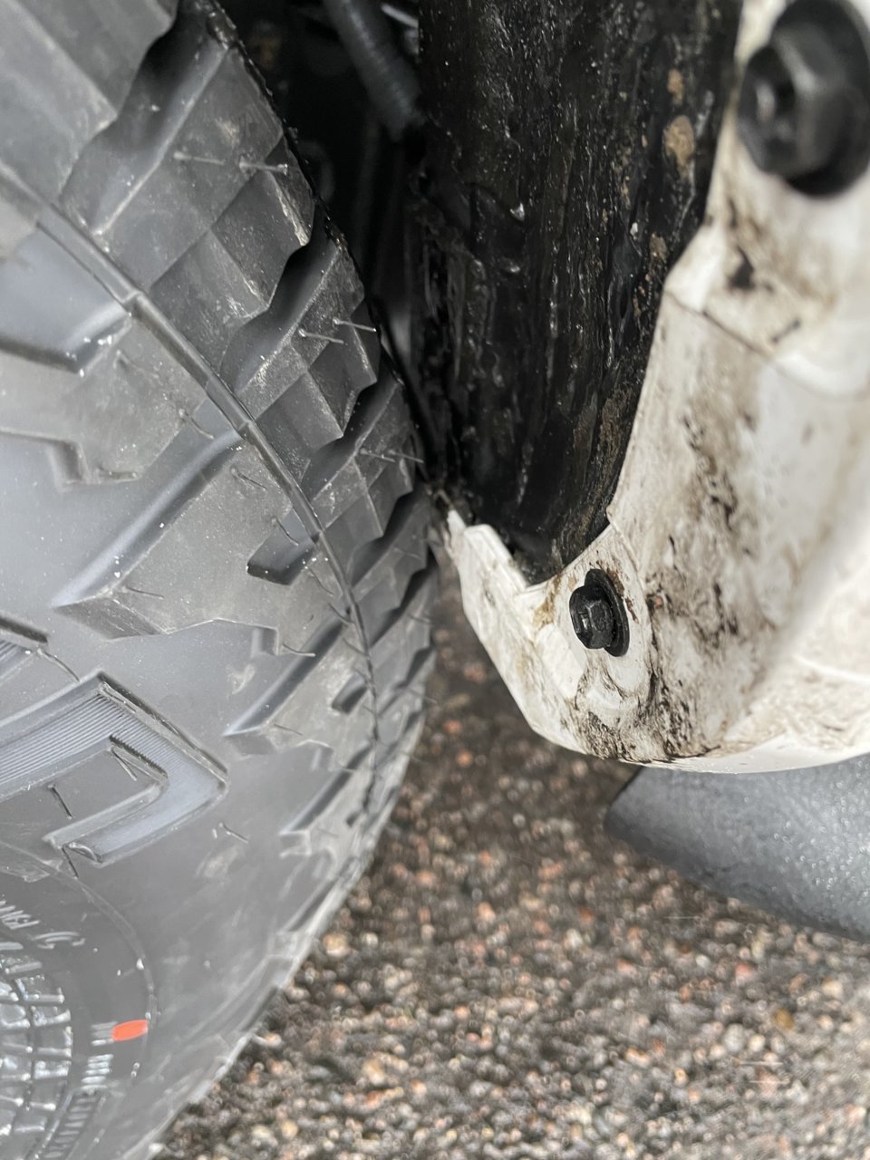

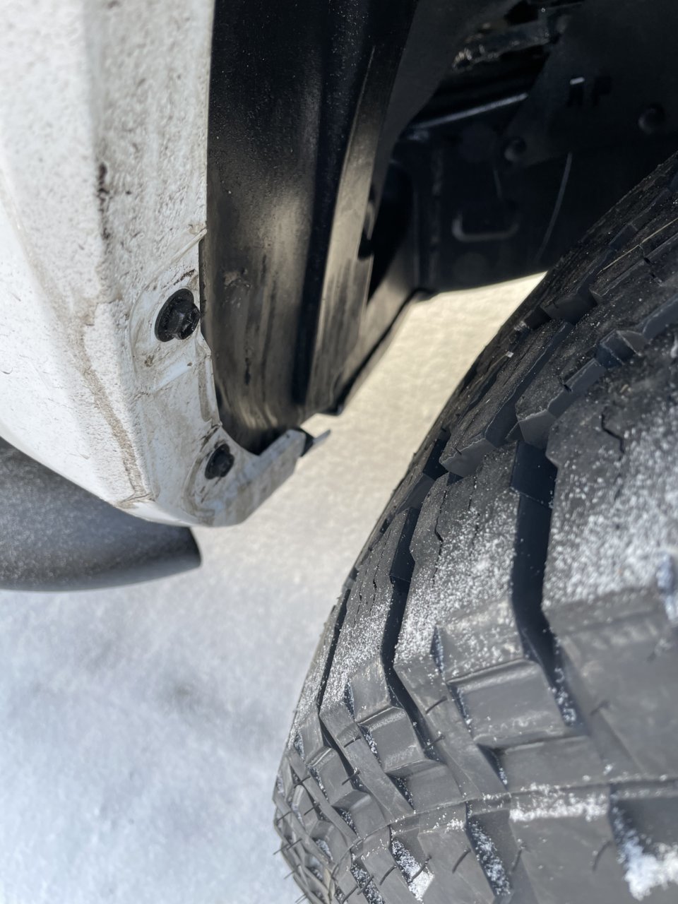

    here are pictures. The front piece is definitely rubbing. Not a ton but it’ll be easy to cut off. You can see on the rear side that it’s bending that piece back already.
    how much trimming do you think I’ll need? And with trimming, I’d like to be able to take this thing up in the mountains, nothing crazy but I’d like to not rub there as well. Will trimming do the trick or will I likely be rubbing on off road trails?

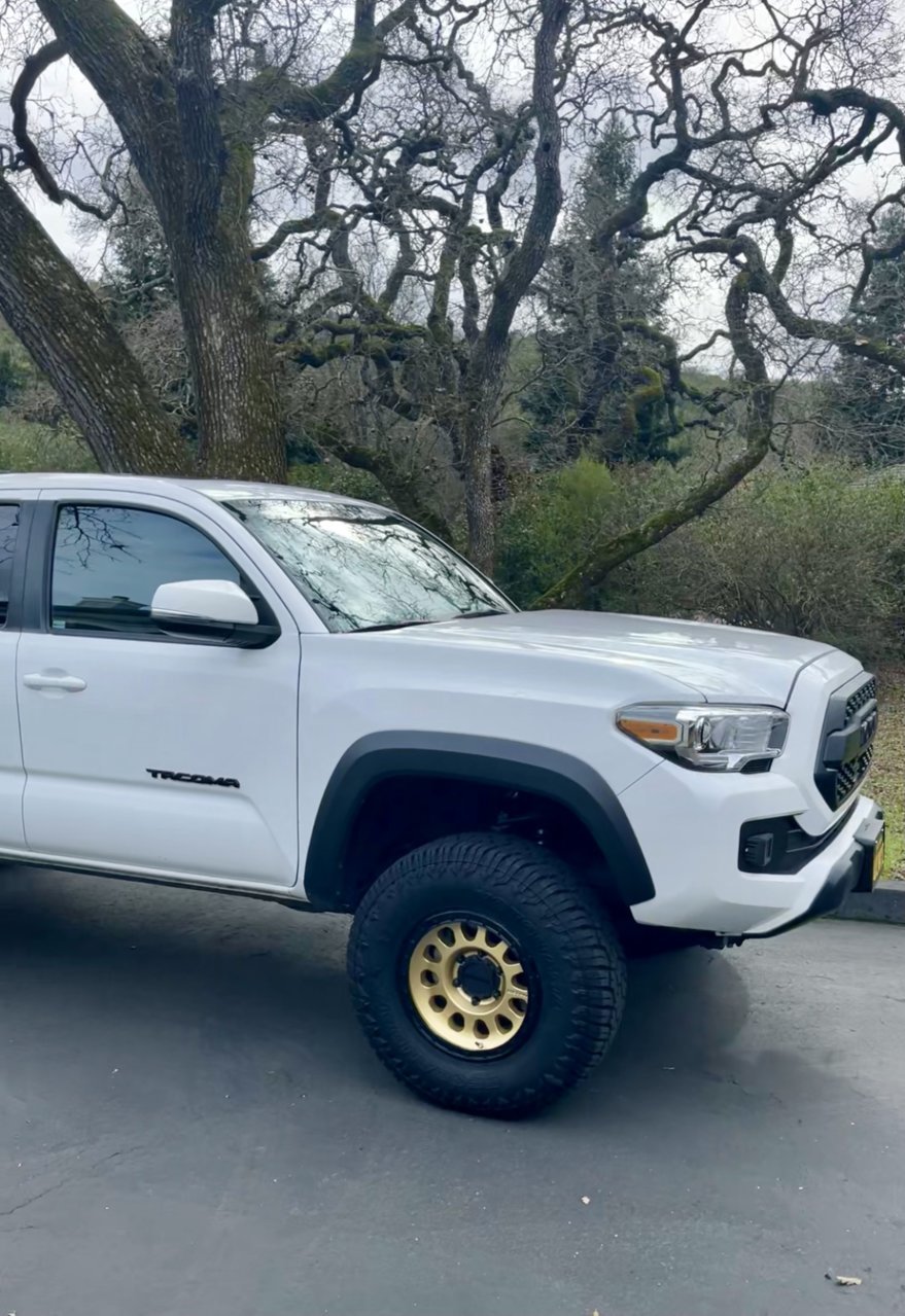

    Nice wheels :thumbsup:

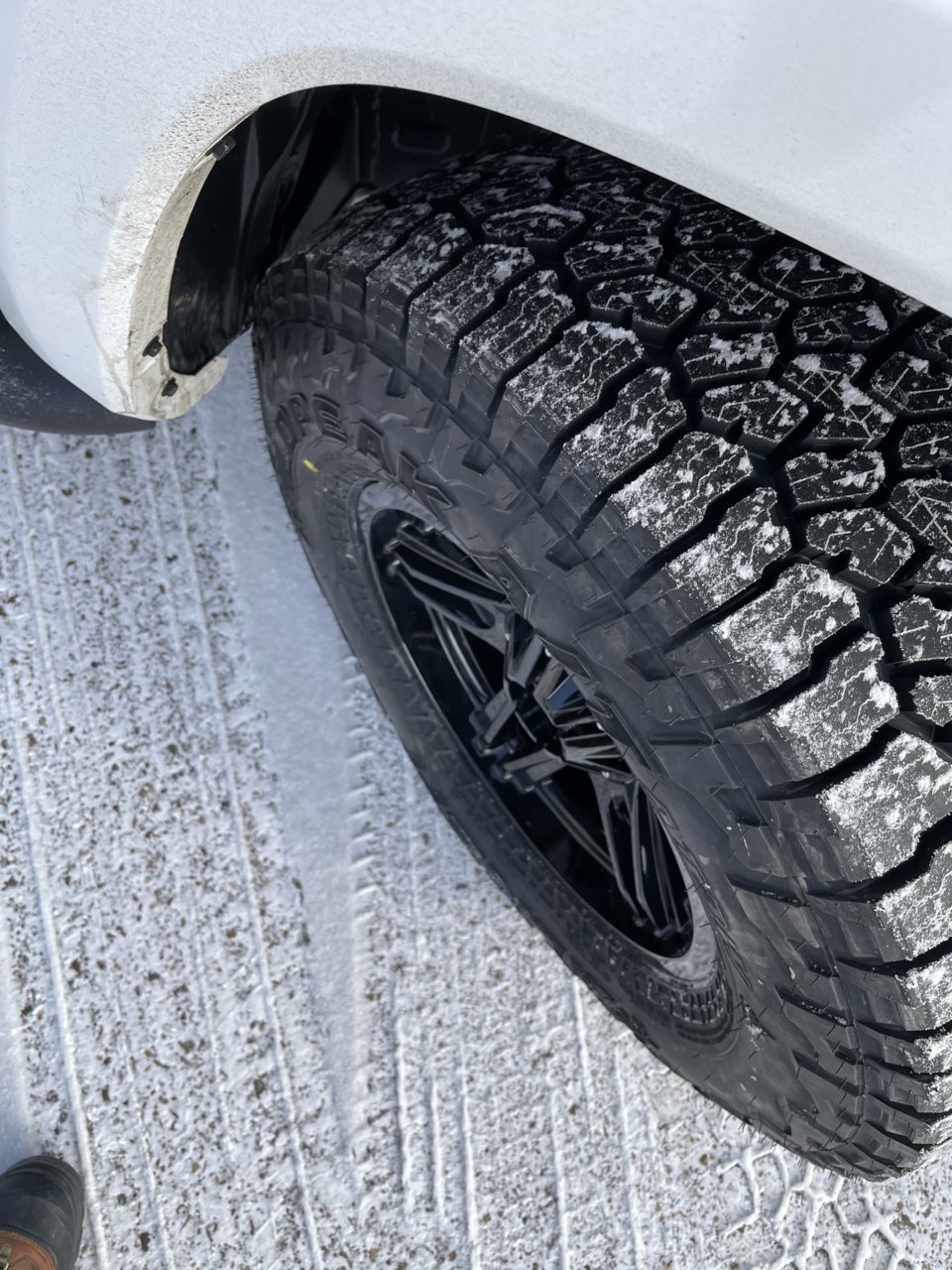

    Looks like it’s rubbing here pretty bad when I make a turn. Is it possible to trim this section up?

    I’m surprised you’re rubbing in the back of the wheel well like that, especially if not in reverse. You’re -10 offset wheels are pretty similar to mine although any millimeter matters I guess. An alignment would adjust the wheels within the wheel well and may be able to help out with that. I can’t speak to off-roading and rubbing as my experience has only been on paved roads.

    I know you already got an alignment with the stock tires but it may be that you need the wheels adjusted forward a bit, although that’ll make the rubbing in the front fender liner worse. I’ve learned over time that every truck is different, 2 trucks could have the exact same setup but totally different issues.

    Right back at cha! Did you change the outer lip bolts to black from Method or did you purchase them elsewhere?

    Kings 2.5” front and rears from Accutune / ICON RXT LEAF PACK black badges doors and tailgate / method 315 / 255/85/16 Yokohama G003 / magnaflow exhaust , axle dump / meso int delete kit / meso led map lights / dome lights / wheelers front super bumps / accutune Flip kit with spacer and new bumps / Cali raised fog light pods / Cali raised ditch lights / RCI FULL SKIDS / SLIDERS / RCI rear bumper / rigid backup lights / tuned on 4.88’s
    Thank you bro!! Yes ordered from method right when I ordered wheels.

    Nice it looks good. I was relieved when they arrived because I originally wanted bronze colored wheels but I really liked the style of the 315’s and I didn’t want to wait for stealth custom wheels to be back in stock. The gold on the wheels are not as bright as it looked on the website. They look way better in person! Maybe when I get bored of the gold, I’ll powder coat them bronze lol
