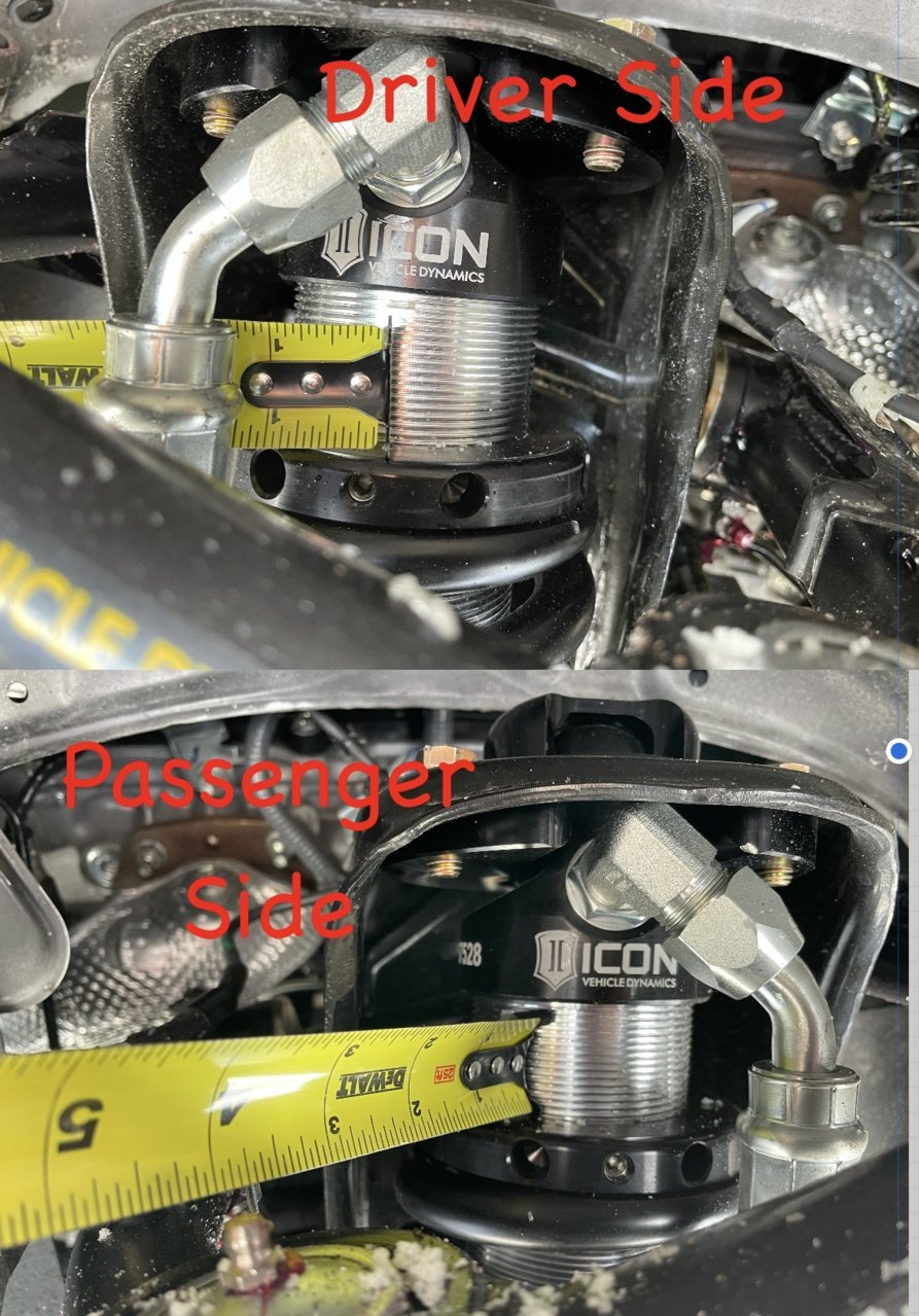

    Think I found the culprit. I went to Toyota and measured stock trucks on the lot. Most were right at 21 inch. When I got home I inspected the passenger side and it’s obviously different. It measures at 22inch. Then the threads on the adjustable section are different on each side. See photo. The place that installed it didn’t check to see that it’s level and I feel foolish for not checking/asking.

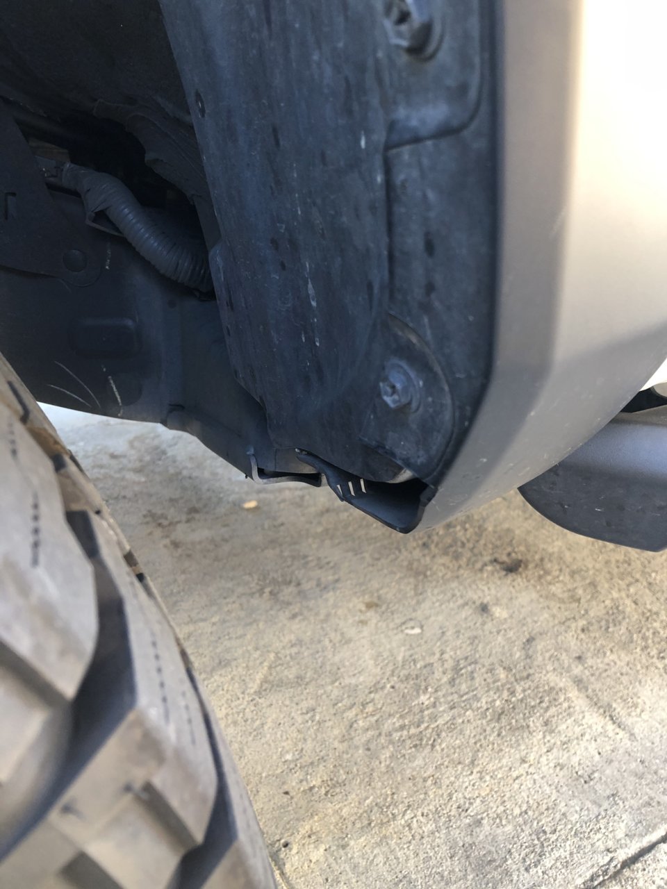

    I’m running 5100 with eibach spring on second notch, you also might want to trim some pieces.6872E681-D290-48D8-9D3A-36FB2D299DAC.jpg

    It's pretty typical for driver's side to be ¼"~ish higher than passenger on 2/3 Gen Tacomas. Battery, fuel tank and driver are all on that side and usually results in a slightly lower resulting height, especially with a full tank, so setting the driver's side a bit higher compensates. That said, it won't explain why so much lower. Does icon have suggested spring seat settings for various amounts of lift with those springs? If so, compare current settings to those.

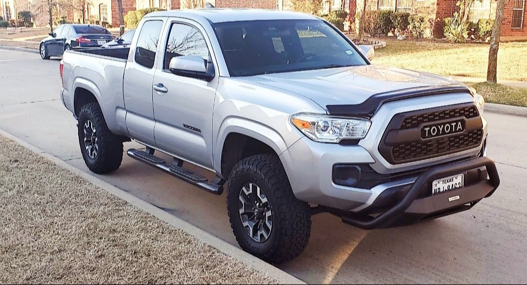

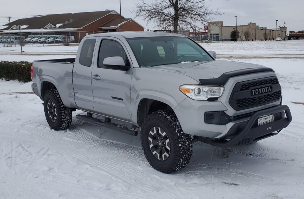

    I've had BFGs on a F150 4dr 4x4, an F250SDLB and my ToyotaTacoma, never had 1 issue. Best tires I've purchased, both new and used...and they perform GREAT in any type of weather. 20210201_180919.jpg 20210216_213731.jpg
