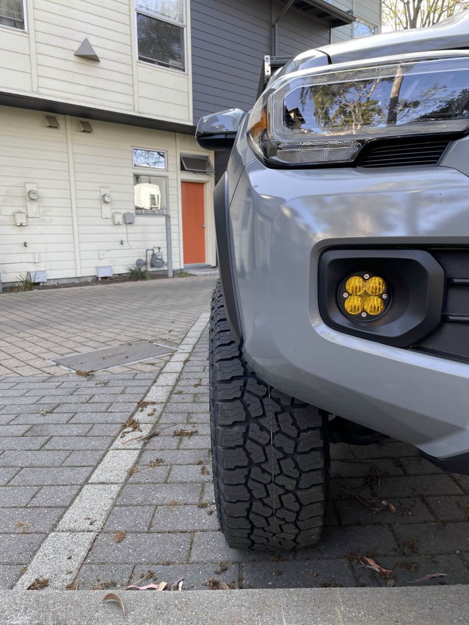

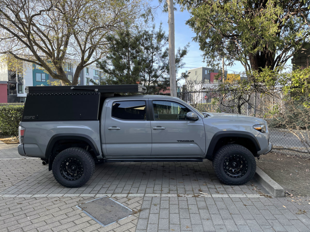

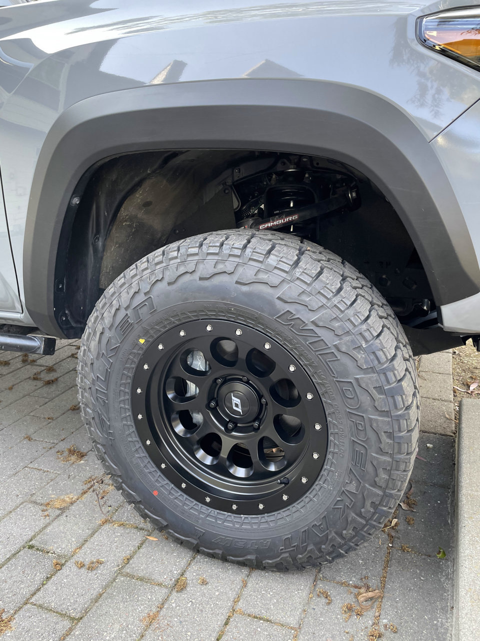

    There's slight rubbing when I'm all the way turned, I'm sure off-roading will lead to some more. It's not much and I don't think I need to get a CMC. I don't mind a CMC it's just something I don't want to pay for at the moment, I'll probably go ahead and get it done in a few months. Really liking the new stance and the wheels filling up the wheel wells. I'm parked on a slant so it looks like I have a bro lean but when it's flat there's still a bit of rake, I have a Dakar HD leaf pack and will probably remove one leaf. Bilstein 6112/5160 on the 6/5 notches and Camburg UCAs.

    Looks awesome man. How much lift you have in the front and the rear? Stance looks great.

    Thanks dude! I forgot exactly but somewhere between 2-2.5 in front and 3-3.5 in the rear.
