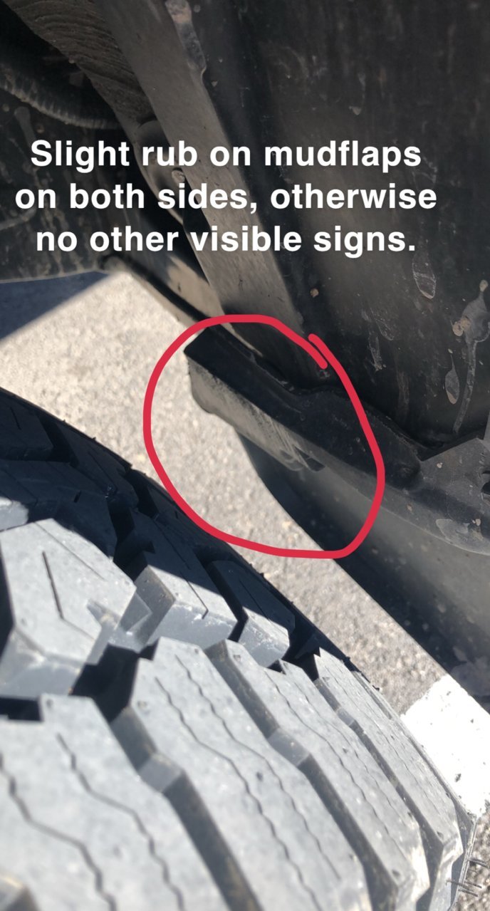

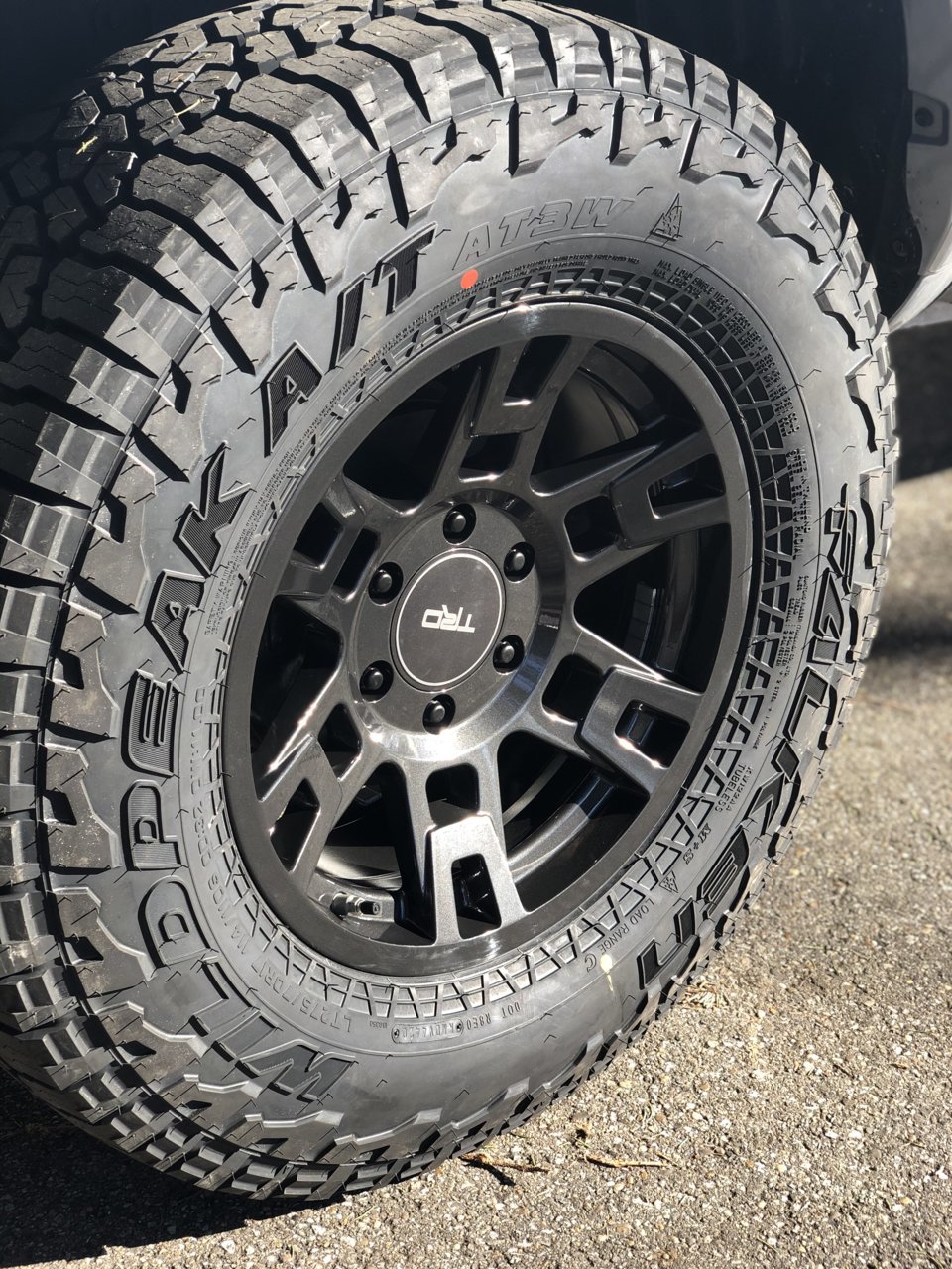

    Just put 275/70R17 Falken Wildpeaks on, only rubs on the mud flaps which I'll remedy by heat gun. Glad I went this route and not 285's. The 275's look good and beefy, they sit near flush to the fender flares.IMG_5975.jpgIMG_5973.jpg

    Lifted on 5100’s all the way around, 887 OME coils up front. Progressive HS AAL in the rear, stock UCA’s. 1/4’ tophat spacer on drivers side for taco lean. Also removed the front air dam.

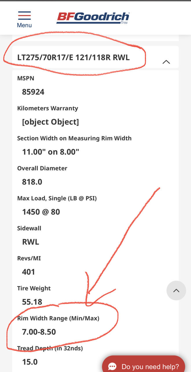

    275/70/17 is approved with the stock 7” wide Toyota rims found on the 4Runner and Tacoma. Technically, a 285 tire requires a 7.5” rim, so the 275’s are the widest tire that is still within tire manufacturer’s spec on the 7” wide 4Runner Pro rims.

    BFG spec sheet for 275/70/17 ko2

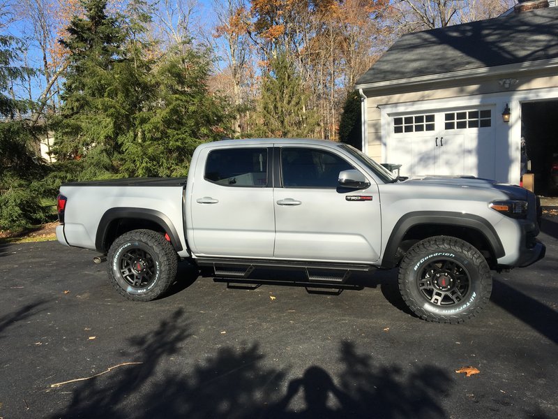

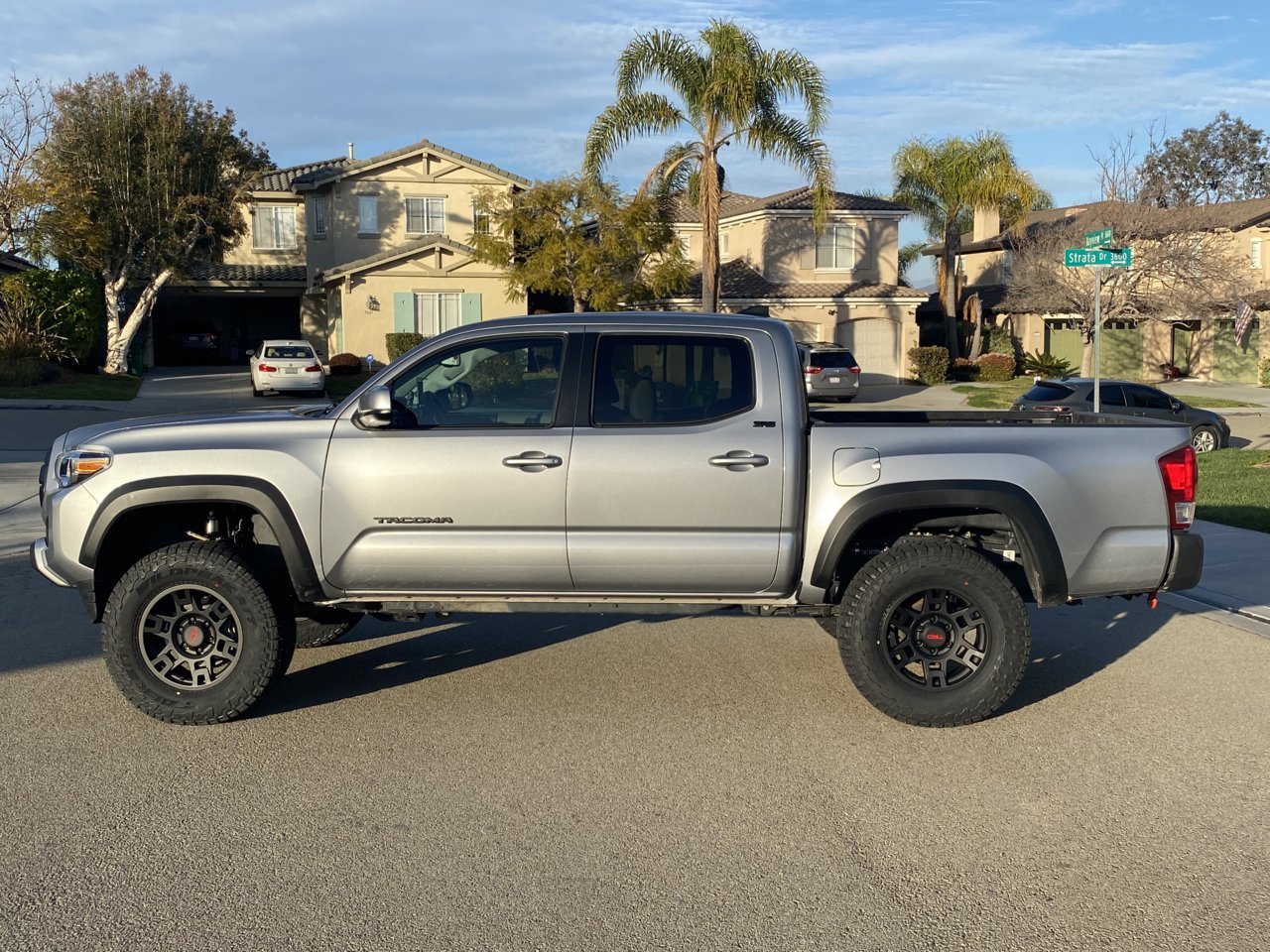

    No rubbing. 2” Icon 2.5 in the front and 1.5” Icon 2.0 in the rear.
    TRD Pro rim, Falken Wildpeaks 275/70r17
    7BFE847A-2315-4D05-987C-85E7FA7942A1.jpg 3059DD64-0260-4560-8B85-2F4AEA037156.jpg
