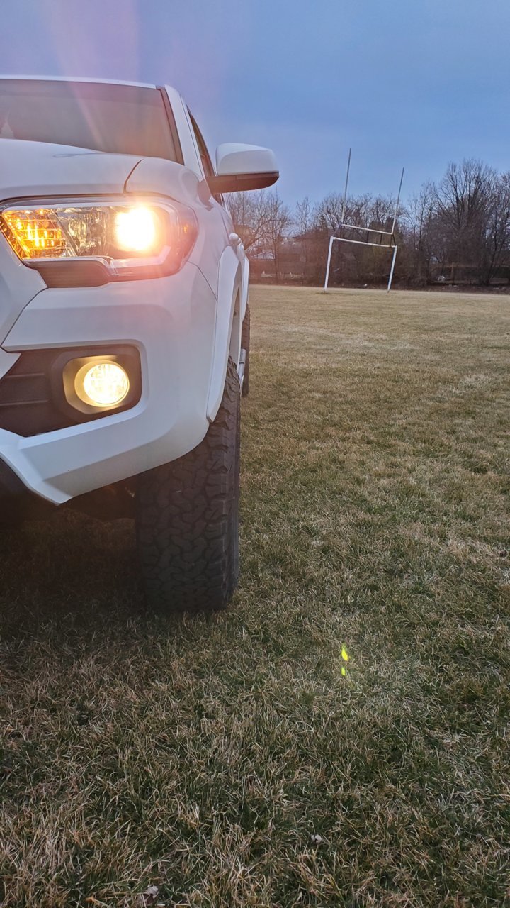

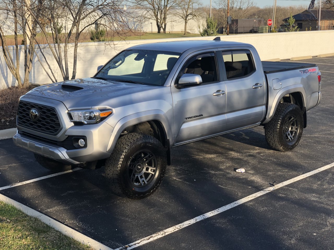

    upload_2021-3-22_11-35-45.jpgOnly rubbing issues I had were with the front mud flaps. I tried pushing them in with a heat gun but ended up just trimming some excess plastic with a cutting wheel and now no rubbing. I also removed the front air dam before mounting my new wheels and tires. I have the FN FX Pro wheels which are 8’ wide versus the SEMA Pro wheels which are 7’ wide.

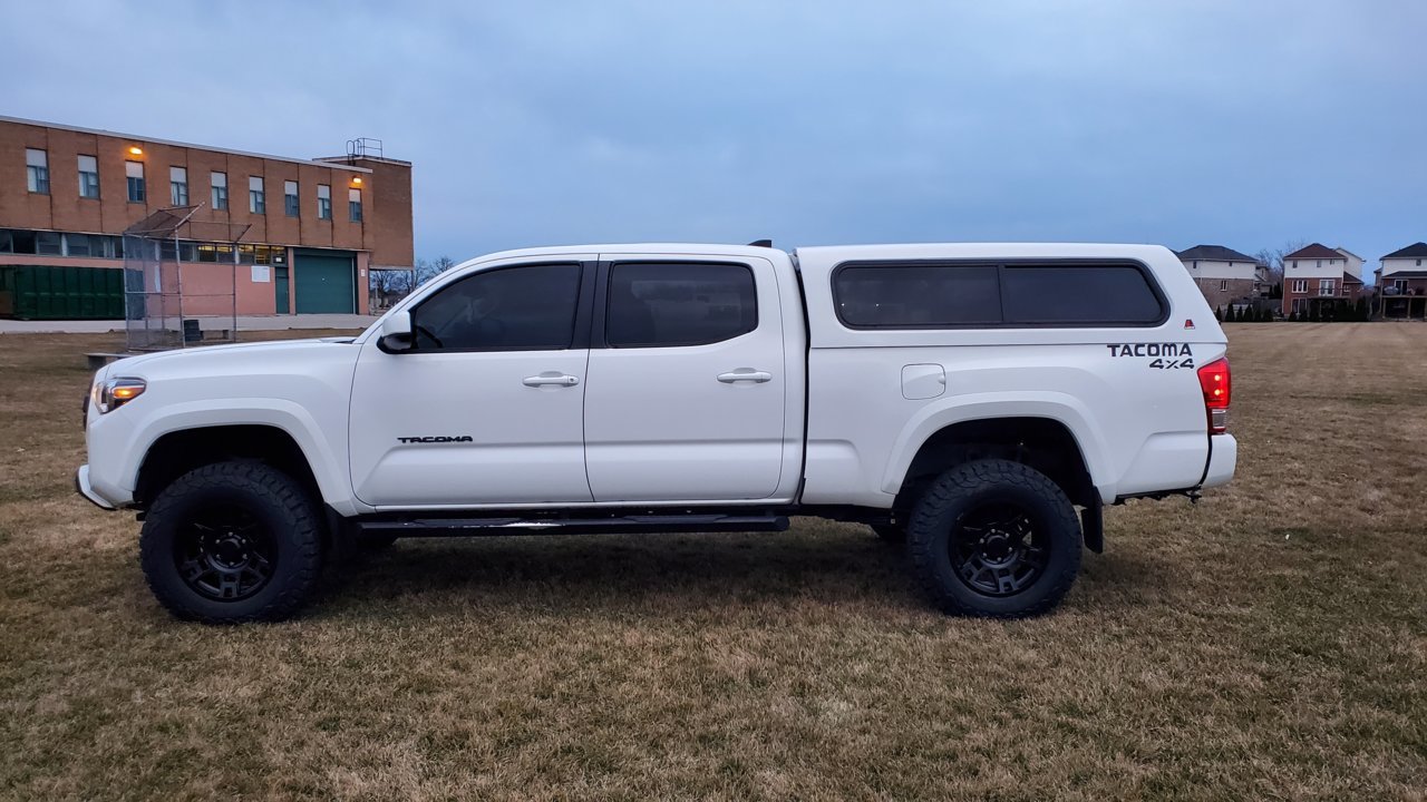

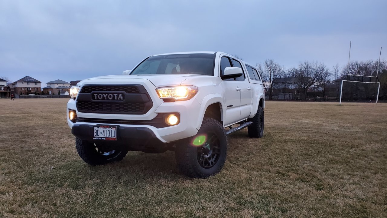

    I said f*ck the 275s and went 265s lol. 8" wide replikas make them look beefier too. Zero rubbing was a bonus too.20210325_192633.jpg 20210325_192428.jpg 20210325_192521.jpg

    Exactly. The biggest reasons I went with 265 is because KO2s don't come c rated in 275s and I was pretty set on that tire and load rating for the smoothest ride. And with a 2" lift and 8 inch rims I think they fit perfect with a nicer stance. Plus down the road I always have the option to go 275s with maybe the wildpeaks or something, we'll see. It's good for now haha
