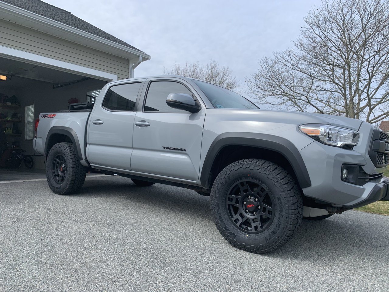

    I’ve got the 275 Wildpeaks. Yes at 57 lbs they are heavy and I could definitely feel sluggishness. I’ve got OVTune now and it’s definitely helped.

    That looks nice. So those are the FN/FX 17x8 on 275s? I currently have the OEM TRD 17x7 on 265s, but those replicas look nice and wider as well (so will be good when I go w/ a lift and 285s....I hear 17x7 might be 'iffy' with 285s). Are those the gloss grey I believe they're called? Also, the center cap...the black/white TRD looks cool. Can you share some more pics? thanks man.

    Thanks man, yes they are 17x8 as opposed to the 17x7 SEMA wheel. Better if you’re planning on a 285 tire. The wheels are dark high gloss gunmetal. To me black wheels seem overdone and can get lost with the black tire. So I chose these and am glad I did. Read the FN Wheels thread and you’ll see there’s nothing but glowing reviews for Dustin and his customer service. The wheels are 0 offset and sit just about flush with the fender flares. The center caps are matched to the wheel. The TRD logo vinyl came from import equipment.comupload_2021-3-31_17-44-7.jpgupload_2021-3-31_17-43-3.jpgupload_2021-3-31_17-42-11.jpg

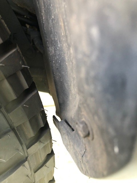

    7309C205-1B2A-4C9C-AEBB-0D083A72130B.jpg Installed today and love the look. Tire is very aggressive looking compared to stock! Still with factory suspension, waiting for eibach to be back in stock! Rub is very minor with mud flaps off. I cut a small piece of plastic where it seemed to stick out a smidge. Only rubs in reverse while turning into driveway.

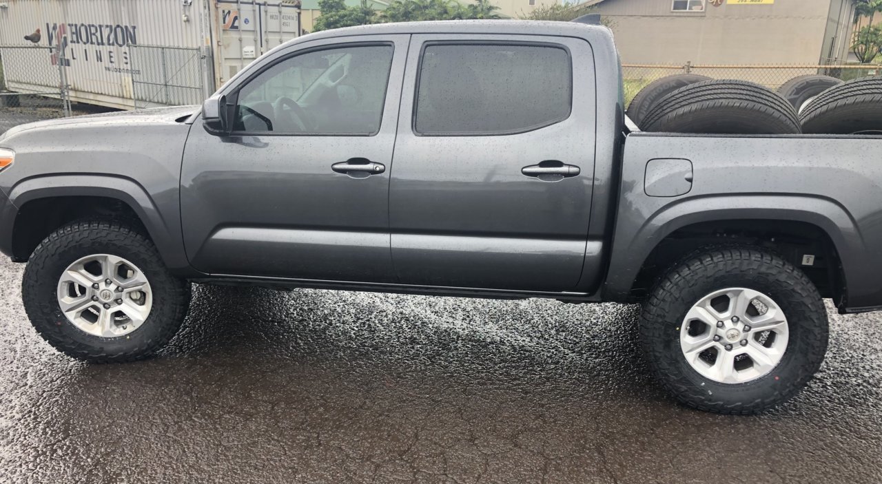

    Kicker speaker upgrade Tint Trimmed air dam Taco Tunes amp and sub 275/70/17 Wildpeaks
    No lift, 275 Wildpeaks on 4runners. Factory steelies and 245’s in the bed. :D

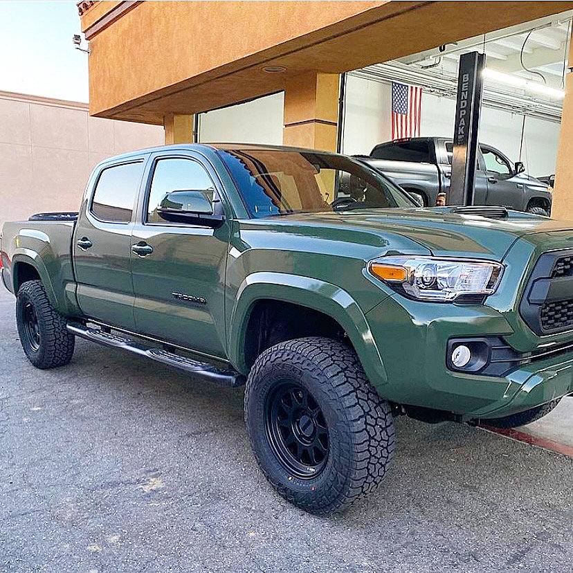

    So I pulled the trigger on a new 21 TRD Sport Manual ArmyGreen. Having them throw in a set of KO2's 275 70 r17. Decided to go with the TRD Lift for warranty sake. $$though. 275 70's seem to be the sweet spot for me for tire size. Not to big. Creates a great stance. Etc.
