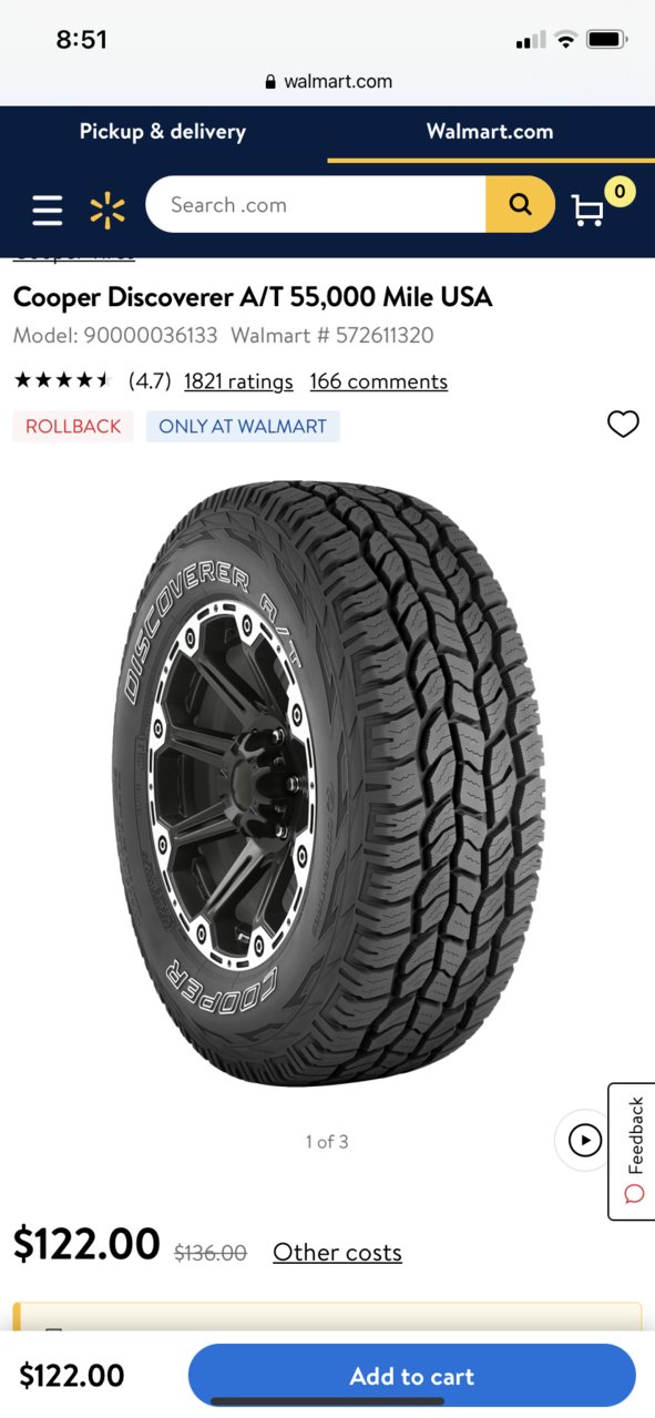

    please don’t laugh. i’m thinking of getting the SEMA gray trd oem matte 17” wheels so i’m googling Wild
    Peaks but cooper tires and walmart keep showing up at like $122 bucks instead of $170 for wild peaks. thoughts??
    I have a 2021 OR with only 16” wheels.
    what am I missing? I do mostly fire roads and camping. no crawling or mud. maybe snow 1x a year. I already got a subie for my snow driving.
    are these the right tires from walmart?

    Those Coopers are a proven tire that lots of people love. They look more aggressive in person, and are supposed to be decent in winter as well. A couple friends I have swear by them.
    Also the grey SEMA wheels are beautiful. I have a set and no regrets.

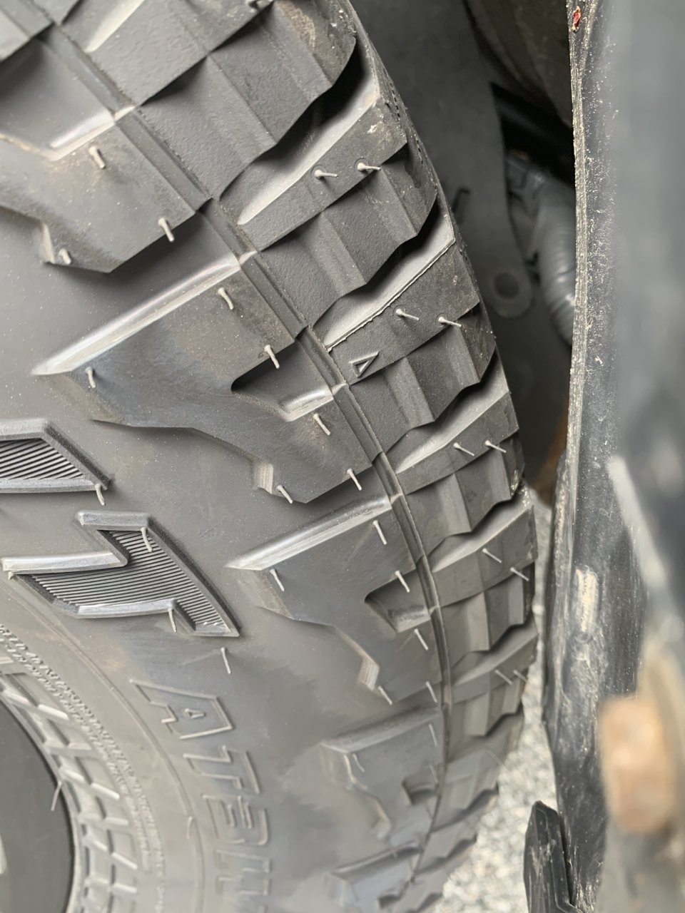

    Extended travel Kings, 650 coils Tundra Kings rear Icon AAL with 1/2” shim & Firestone airbags Total Chaos UCA’s ARB onboard air VTX Stinger 17x9 -25 offset Yokohama g003 MT 295/70/17’s RCI roof rack and bed rack TRD Pro skid TRD Pro tail lights R4T high clearance exhaust CBI Baja bumper Smittybilt xrc 9500 winch Dobinsons snorkel, Syklone precleaner Caliraised ditch lights, rigid covers 5.29 gears CVT Mt. Washington RTT Body Armor sliders ECGS bushing
    25F5290B-277D-4CAF-800C-10F7B9727598.jpg A085F4A9-091A-40C6-BE65-42E01AF59010.jpg
    275/70/17 Wildpeaks, 17x9 -25 offset VTX Stingers with SCS center caps and SimplyMuggle TRD stickers. 2.5” lift from 6112 and 5160 with 3 leaf aal. Had to lose the mudflaps, the tires barely rub the cab mount now. I think I would need CMC for anything bigger on these wheels.

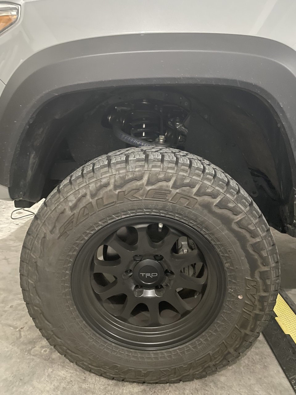

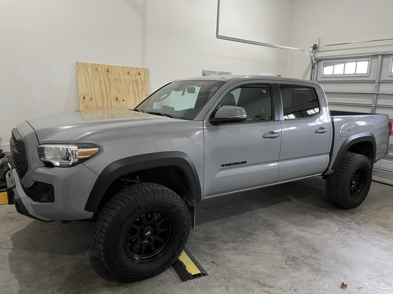

    Are these OEM wheels that are 17x7 with +5mm offset, or are they 17x8 wheels with 0mm offset? Looks beautiful!

    Those are 17x7 if they are OEM. -4mm offset comes to mind. I had some aftermarket/replicas that were 17x8 on my 2nd gen.

    the oem ones are +5mm.

    Yes that are oem 17x7
    Thanks, I love the look

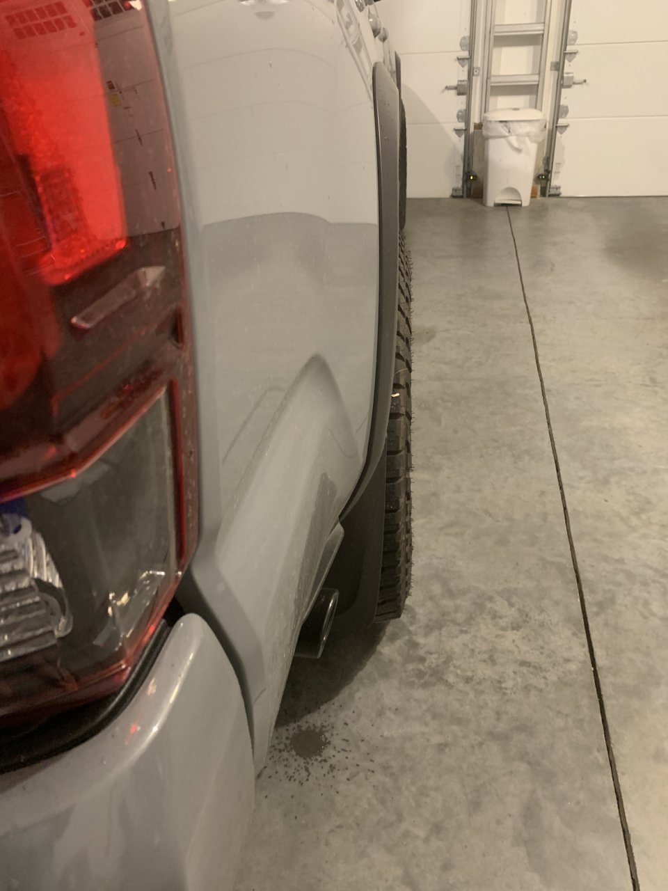

    do you have any other angles that I can see f the offset? Like directly from the front and down the side angles?

    Only have down the side, will get a frontal shot tomorrow
