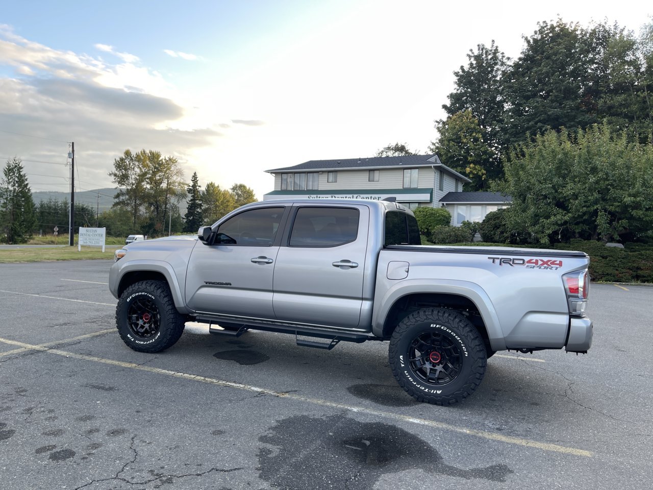

    New to this forum and to Tacoma world. Quick question…im getting KO2 275/70R17 with a 17x8 +5 offset on my Tacoma this weekend. Any idea if I should be worried about major rubbing? Currently on stock suspension.

    That positive offset is going to push you in closer to your UCAs.

    F33DB24B-05C0-4690-85DB-583A8C2295B2.jpg Got tires and wheels mounted today! Couldn’t be happier. 275/70R17 Bf Goodrich KO2 E load. Ride is not as rough as everyone says. Slight difference in ride quality after 60mph.
    Wheels: 17x8 +5 offset. No rubbing at all on 2021 trd sport 4x4. Tires line up with fenders, perfect. 2” front leveling kit soon.

    No rubbing on stock suspension? How’s gas mileage now?

    No rubbing! Keep in mind this is my daily, so not doing any crazy driving. And mpg is 17mpg around town. Haven’t driven on too much highway yet. Going on a trip this weekend, will update. Running 34psi on all four.

    Are those knockoff TRD rims? All the genuine ones are 7" wide. If so, where can I get some
