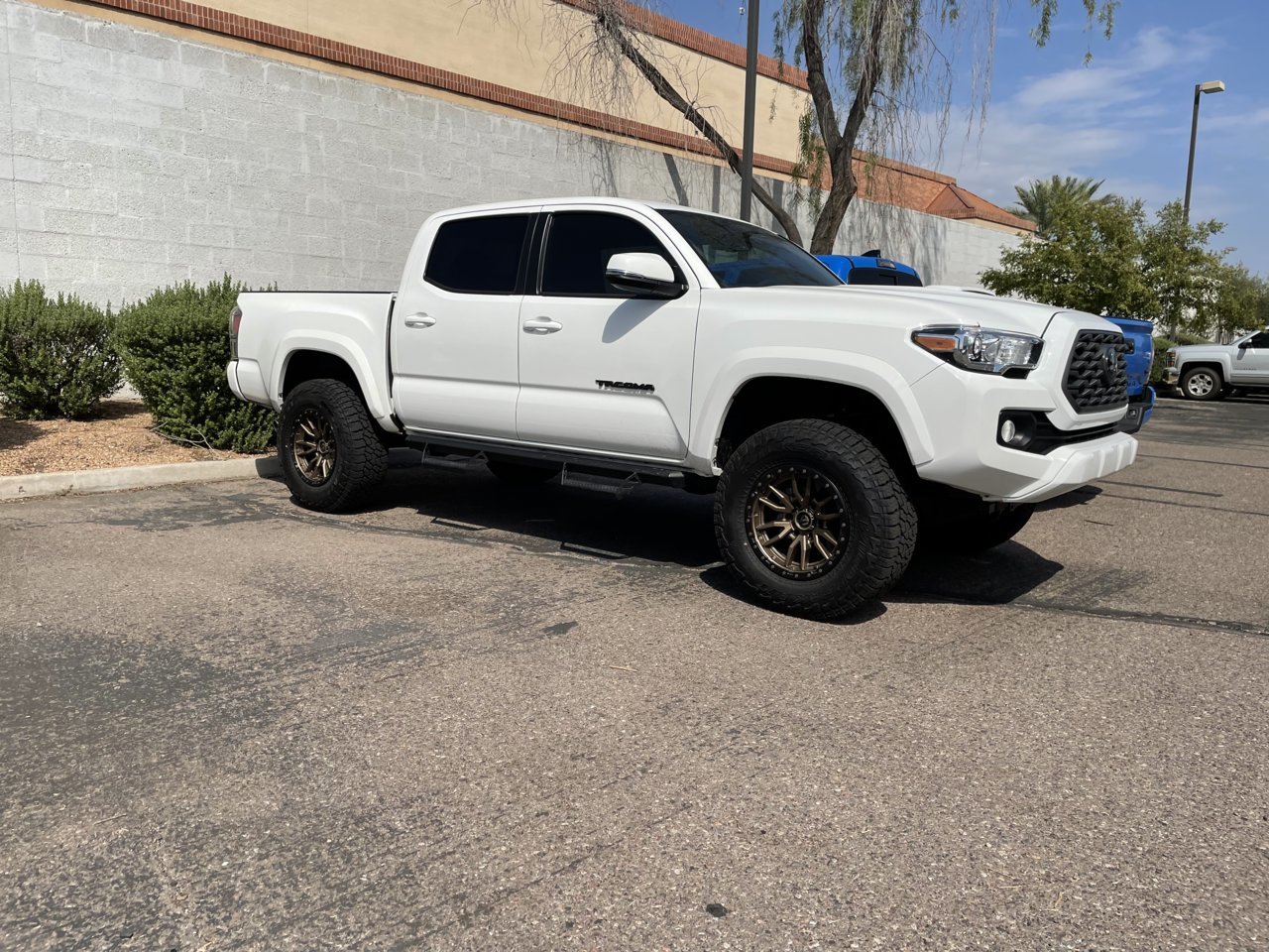

    I am installing a 2 in lift in a couple weeks. I ended up installing the wheels/tires this last weekend. They are 275/70R17s mounted on 17x8in +5 offset wheels. I had a little rub on the front OEM mudflaps, so I pulled them off. We’ll see if I reinstall them after the lift is on.
    I am looking forward to getting the lift installed, but pretty happy with it so far.

    Sweet ride. You’ll love the look with the lift and those tires. What lift are you going with?
    The rub will go away after raising it up. How’s your gas mileage with the 275’s? Gas mileage will prob go down a bit more with a lift.
