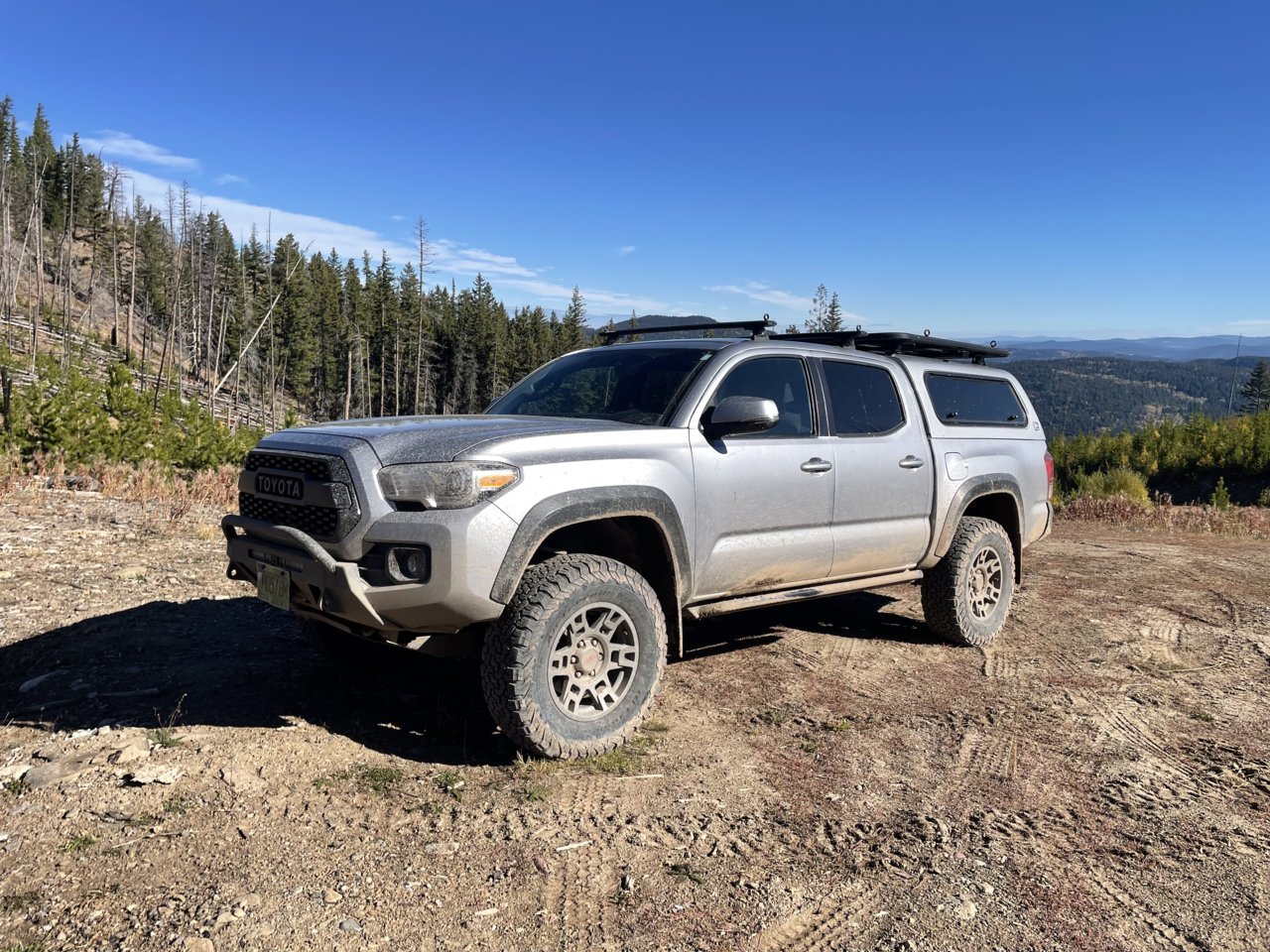

    I have 275/70/17 on the SEMAs and do not rub, even at full flex. Depending on your alignment, you could end up with minor rubbing that you could really ignore. If your truck is like mine, you’ll have no issues.
