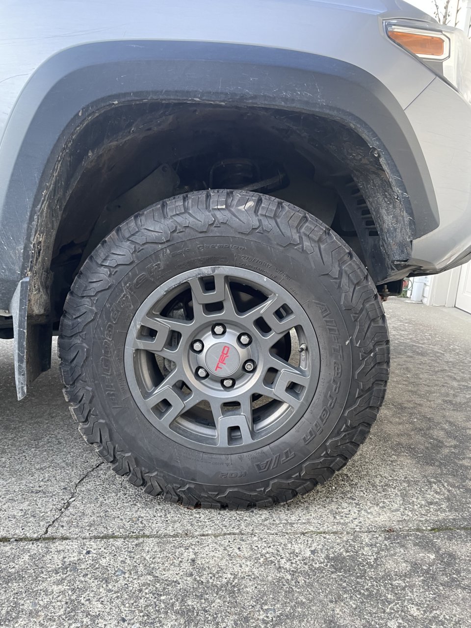

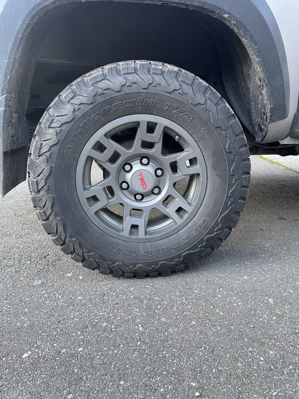

    Just a couple handy pictures for people trying to decide “how much bigger are these tires than 265/70/17 etc?”. Both pictures are of 275’s on 7” wide Toyota rims. You can go look at your truck and compare to these.

    Hmm. If you don’t tell someone which size is which, would they will be able to tell the difference.
    But of course I’ll do 275s anyday haha.

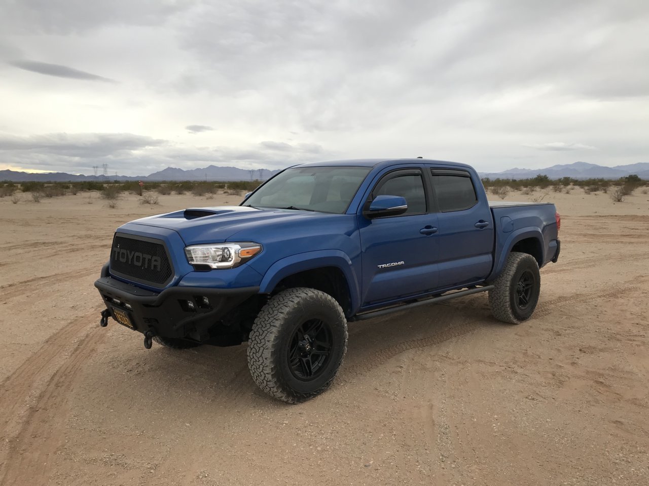

    275/70/17's on SEMA Pros with Fox 2.0's and 650 lb coils, no rub. Tires have about 50 % tread left

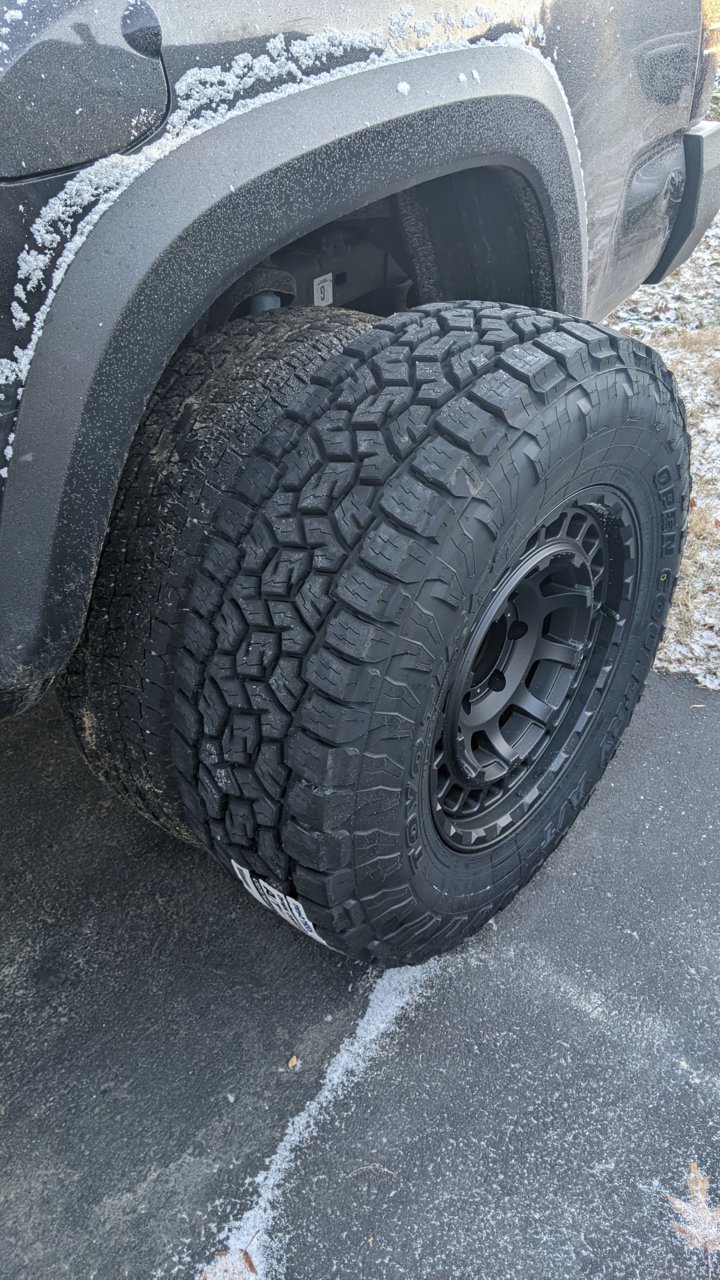

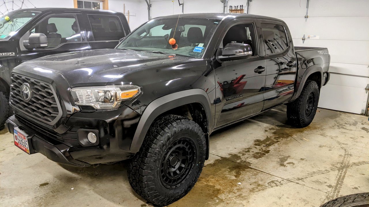

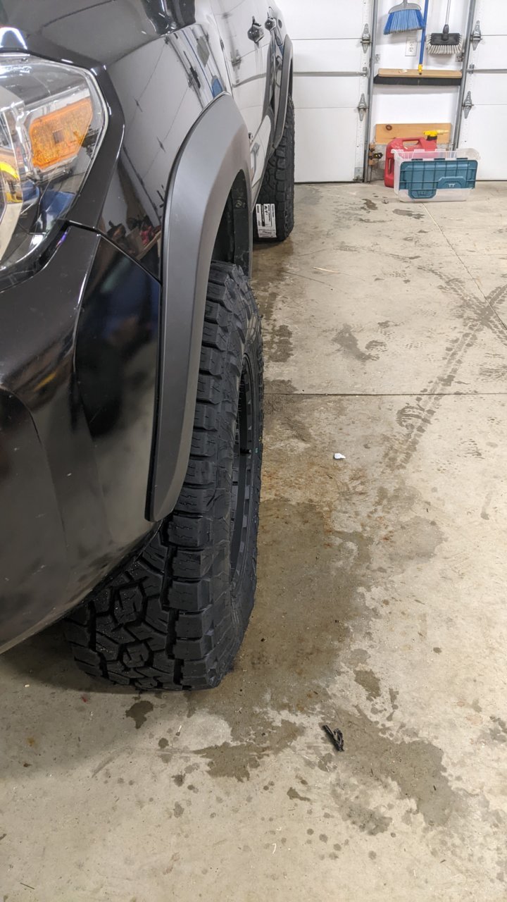

    275/70/17 Toyo Open County AT III e rated on Black Rhino Chamber 17X8.5 0 offset, 4.75 backspace. Definitely rubbed right off the bat. Removed the front mud flaps....still rubbed especially backing and turning at the same time. Getting alignment done this week, will advise if this cleans up the rubbing or not. Trying to decide on either the Old Man EMU lift, 887 coils and HS AAL or the 5100's with same HS AAL. Anyone out there experience the same dilemma?

    Love your wheel!

    Thanks! Toyota did a nice job with these.

    What bumper is this? Nice!

    It was a package deal from Custom Offsets, an early Christmas present from the wifey. 250 miles on the tires so far, no complaints. 1 to 2 mpg loss from weight. Excellent traction.

    I'm no where near the cab mount, mine rubs the fender liner near the bottom. I have 0 offset Blacked Rhinos.

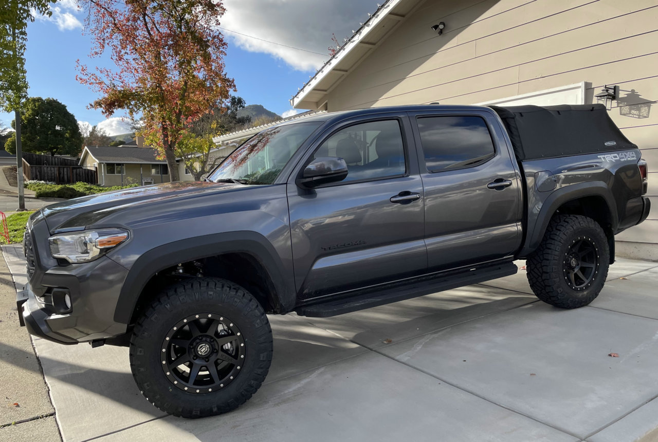

    Just upgraded the 21 OR with 275/70R17 Nitto Ridge Grapplers, Icon Stage 3 Lift (2.5") and Icon Rebound Wheels
