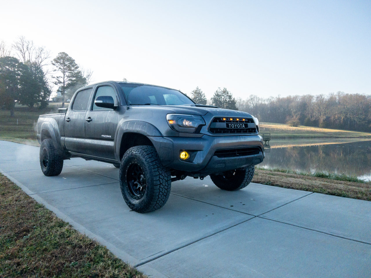

    Looks great. So I assume the wheels are the problem? I have the TRD 4R Pro wheels with 265/70/17 with the OEM mud guards and no rubbing and in fact I believe a 285 will fit with minor trimming. Im lifted 2/1 on 5100s and not even dealing with 285s. If there was a 275 in a SL rated tire I may do it. I should be fine with a 275, I know BFGs run on the small side but hoping TOYO will do this size in a SL rated or even C rated.
    I think the 275s will be a perfect fit, as i need my mud guards to stay, I'm not removing them so thats comletely out of the question. I like the 275s as I don't think the speedo will be off that much as my 265/70/17s are spot on accurate with the GPS.

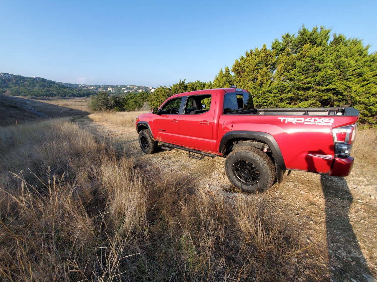

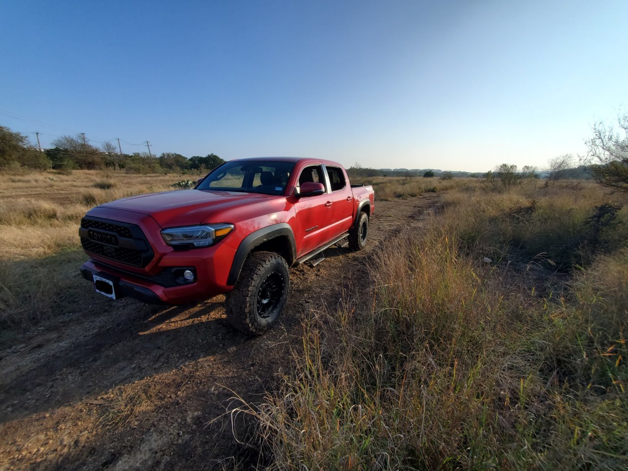

    Eibach stage 1 lift Wheelers 1.5 progressive AAL Pro Comp Series 05 wheels 275/70/17 BFG KO2s
    Yeah from what I gathered there's a significant amount of variance from vehicle to vehicle regarding rubbing, tire size, offset etc. Some people put on 275s no lift and had no rubbing on day to day driving, others like me didn't make it out the parking lot before the shooostting began.
    My wheels are 4.75 BS and 0 offset. I was prepared to do whatever it took to fix rubbing issues.
    The 265s would definitely be a safer bet if you don't want to potentially modify your truck.
    Good luck!
